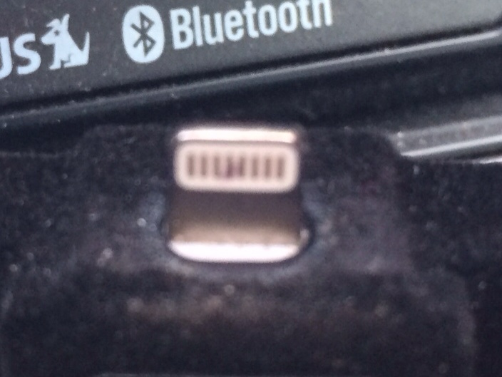

Here's a photo I took to try and show the small half mm recess the cable has in the holder. I can't figure why it would work perfectly with my 5 for so long, then have problems with the physically identical dimensions of the 5s.

I'm not sure which model proclip mount you have, but you may be able to move the connector upwards (and eliminate the recess) by loosening two screws on the back side of the block that holds the connector. That would be my first suggestion -- as it is possible the connector has been "pushed down" in the block through repeated phone insertions.

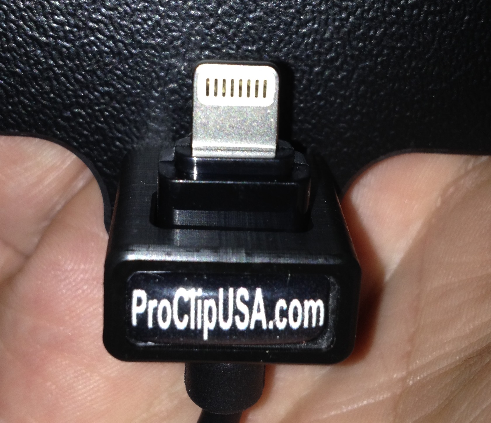

I just received a new mount for my 5S (model 521504, "Adjustable Charging Holder with Tilt Swivel and USB Cigarette Lighter Plug for Rugged Cases" for 5/5S with case"), but I haven't used it yet because my phone is still in Fedex's greasy hands.
My model came with a cable pre-installed; turns out it is a Belkin branded cable. It actually sits way up above the holder, as opposed to being recessed like yours.

Thanks for the suggestion, I'll look at it tomorrow and see if I can get the cable in a better position. I hadn't thought of that. I think it'll slip down again though, it clicks into place when I insert it now, so the latch that keeps the cable from going down when the phone is inserted it engaged already.
