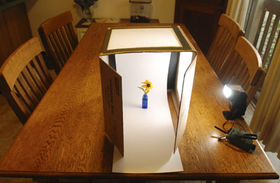

And here's the $10 alternative:
http://strobist.blogspot.com/2006/07/how-to-diy-10-macro-photo-studio.html
Note that the article examples have directional light, you'd just need to balance or fill from the left to eliminate the shadow (not that I think that's necessarily a good goal, some shadow gives the product some depth.)
Does anyone know what kind of flash light he is using in the right hand side of the photo?
How is it that the flash light can... stay on? 😕
I'm guessing that he is using either Nikon's Creative Lighting System (wireless) or a Pocket Wizard system (also wireless) and that he took the photo at the time the strobe was being fired for the tabletop shot.....
