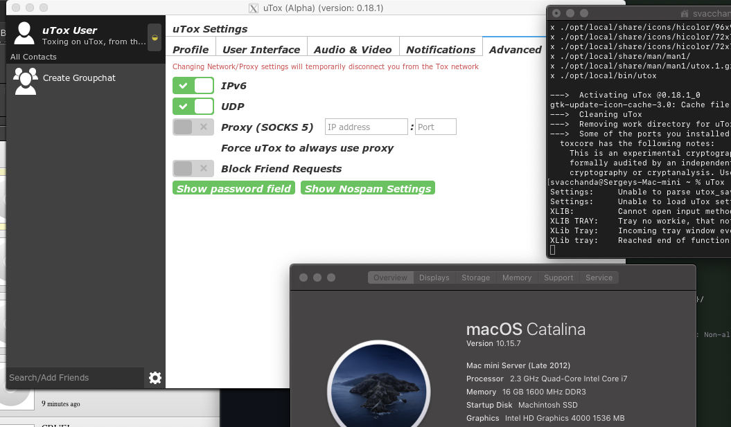

uTox will probably work, I am trying to fix one issue. (The build was kinda fixed yesterday, but the app was crashing, since one non-portable thing needs to be reimplemented, not just disabled.)
Well, after spending a day on this, I think I have fixed the issue with binary embedding, however turns out that the app crashes regardless. From the logs it seems that the crash happens on OpenAL-related code. I do not know what to do with that further, since it is not clear what exactly goes wrong. I tried both Apple OpenAL and openal-soft, both crash.
You may try this: https://github.com/barracuda156/powerpc-ports/commit/cfd85d63ddb5eab10d7511445354b69c7f742310
It will probably build, and most likely will also crash on launch.
Here is the issue for OpenAL: https://github.com/uTox/uTox/issues/1574
And a draft PR with the patches to allow X11 build: https://github.com/uTox/uTox/pull/1575
Sorry, I tried 🙂
Reactions: crimsonRE
UPD. On Catalina the same X11-based version seems to be functional normally. This likely means that my patches are fine, but the source code is broken for BE platforms.
