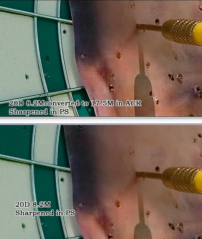

A simpler way is to simply 'enlarge' in the RAW file in ACR by upresing. Better than Genuine Fractals and much easier than the out dated and faffy 10% increment nonsense. A single enlargement with correct interpolation does as good a job. I tested this the variations out a few years back and was very surprised by how good ACR was as enlarging the RAW file. If I can find the examples I'll post them. No time to redo them at moment.

I found the images where I upresed an 8.2MP 20D shot to 17.5MP using just ACR in one pass. You can also go the other way if you want smaller images.
I also tried Genuine Fractals and the 10% method at same time. The quick, easy and free ACR method produced the best quality.
I was amazed at how good a job ACR did.
