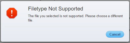

First time posting! I'm having some issues with OS X Profile Manager, whenever I try to upload a script via the web interface to run on login it tells me the file type is not supported even though its a shell script created on a mac. Any help would be really appreciated as Apple are wasting my time! Thanks in advance 🙂

Profile Manager is giving you an accurate warning. What file are you trying to upload, and to where?
What are you trying to do?

What's your script, exactly? Is it saved as a plain text file with .sh as the extension? I assume you are trying to load it into the Loginwindow settings, under login scripts? I don't know that will work there; putting a LaunchAgent on each client computer is probably a better solution for this.

Uploading that works for me, but your script has issues. There's no directory on the Mac called "volumes". Case sensitivity is important. Dollar signs in scripts indicate variables, so you can't use them in your path as they exist here.
