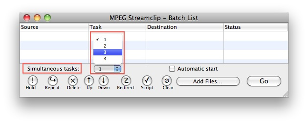

After you have added files to MPEG Streamclip' Batch List, you choose the number of simultaneous tasks. It will not make the transcoding process faster though, as MPEG Streamclip already uses up to four cores or more.

thanks for the visual, that really helps, but how do I get to this batch page to begin with?
I thought you already have used Batch List. If not, use CMD+B to open it.

Is there a batch convert throught the tolbar menu at the top when I have mpeg streamclip open?
Does CMD+B not work to open Batch List? Anyway, it is found via the List menu item.
