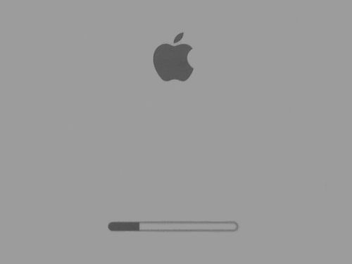

Whenever I boot into OS X, it shows a progress bar and takes much longer than it used to.
Apparently this may be indicative of a hardware issue.

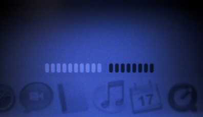

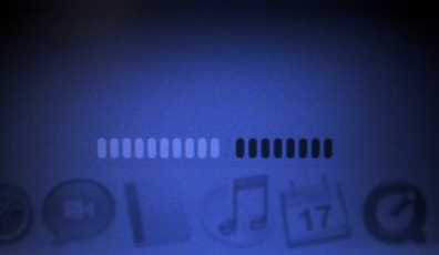

The progress bar you are referring to spinnerlys has different appearance and is a result of waking from deep sleep. The desktop image is shown in the background, but is greyed out, as the image loads. I don't think this is what the OP is referring to. See the attached images.
There are two things a gray progress bar beneath the Apple when booting can mean.
A firmware update or
A system check of the disk (Repair Disk).
I am going to guess it is the latter, and you are right OP. If this is being displayed every time you boot, you should backup your data as there are likely serious problems with your hard disk (physically or logically).
