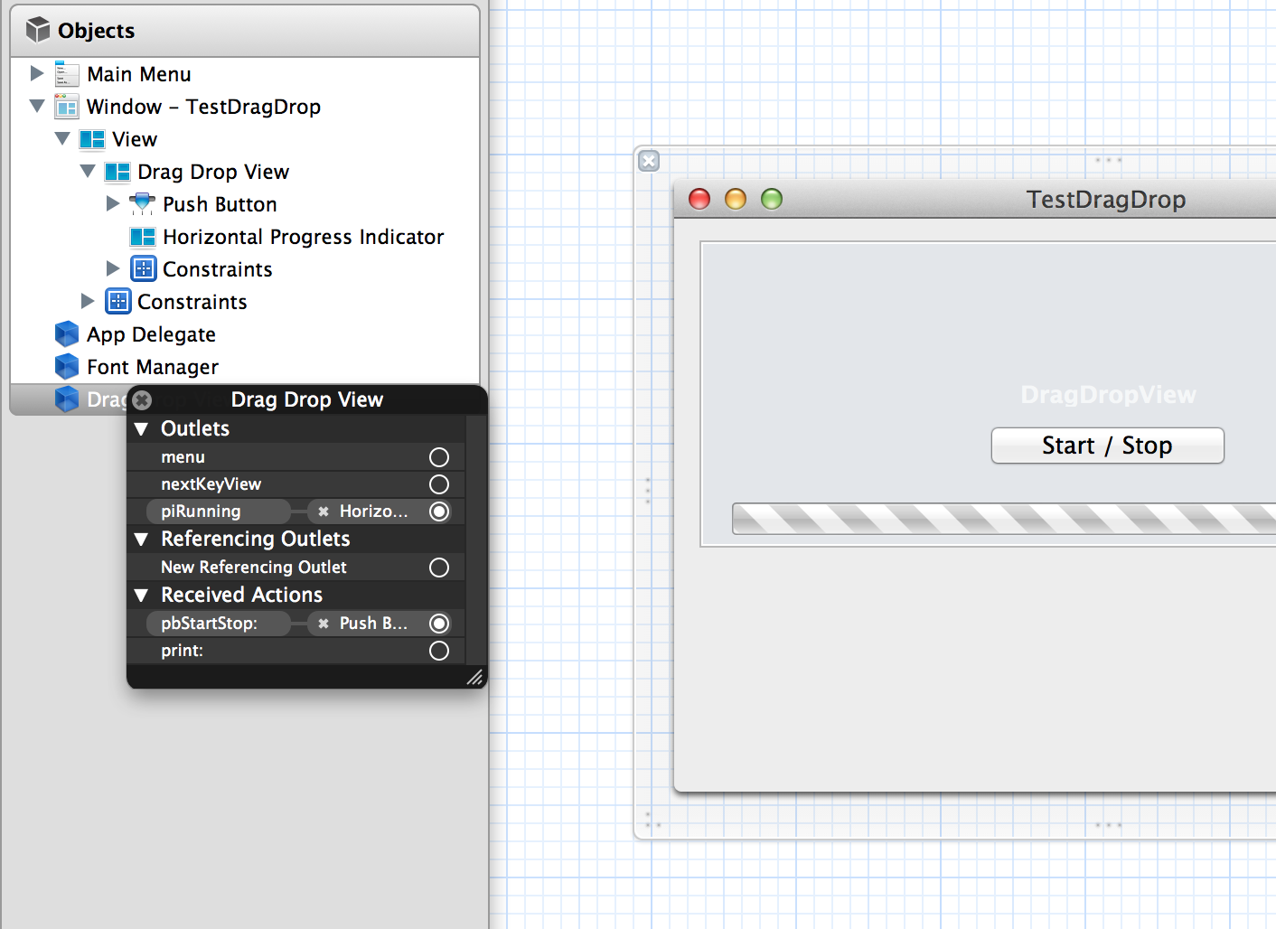

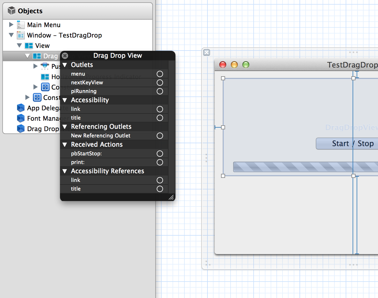

The problem was in fact two separate instances of DragDropView inside of MainMenu.xib.
You'll note the first one (the one that takes the drop operation) does NOT have an outlet connected to that NSProgressBar. If this wasn't Objective-C messaging its piRunning would result in a crash on most languages.
The second instance of DragDropView has its outlets hooked up, and is the one that receives the button presses.
'Fixing' it was as simple as connecting the first DragDropView's piRunning outlet up to the NSProgressBar. That fixes the animation, but it obviously doesn't fix it the right way. I leave that up to you.
