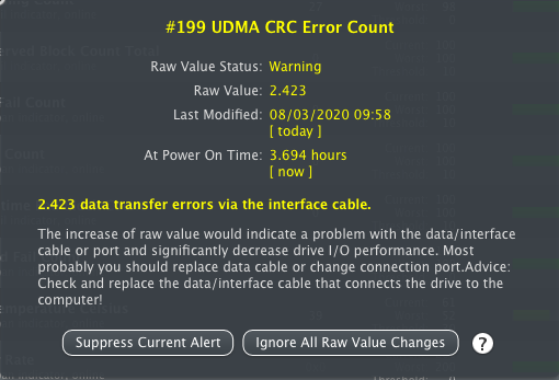

I think this points to a SATA cable failure. Did this behaviour happen directly after you upgraded to the SSD?
Could you install a SMART data reading tool, such as Drive DX (this has a free 15 day trial period) and check for the 'UDMA CRC error' parameter? Counts for this parameter means that data got corrupted between the drive and the motherboard, as it would be typical for a failed cable (for instance). The counts also will go up quickly.

Dear Magnus,

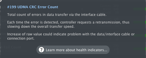

Thank you for your reply. I downloaded Drive DX and indeed it shows an error in UDMA count (see attached screenshots). Many thanks for your suggestion. I will call somebody who will fix the cable for me.
Also, it might be useful for the ones who can dive deeper to post the ETRE check report here.
Best,
Magnus
Meanwhile a new SATA cable has been installed. So far so good... Fingers crossed it will keep working.

BTW; is it normal that the UDMA count still shows an error in driveDX, even after the SATA replacement?
Kind regards.
