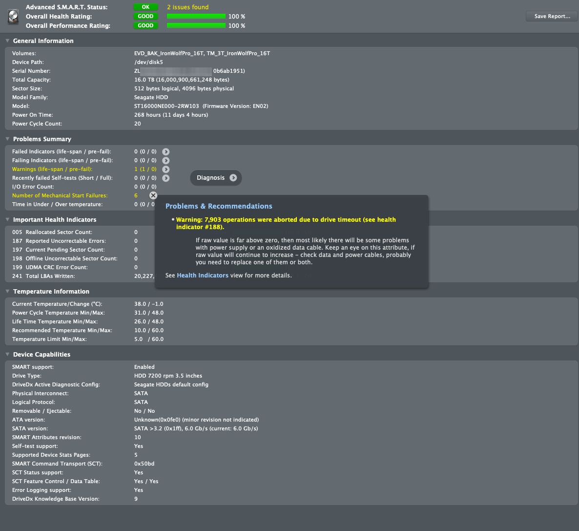

I put 1x 14TB and 1x 16TB Seagate IronWolf Pro in 2 bay of Promise Pegasus J2i
I have check SMART info after a few days of use
All 2 of the drive shows the SAME Drive SMART Issue “#188 Command Timeout”
The count of aborted operations due to HDD timeout. Normally this attribute value should be equal to zero and if the value is far above zero, then most likely there will be some serious problems with power supply or an oxidized data cable.
Is it normal?

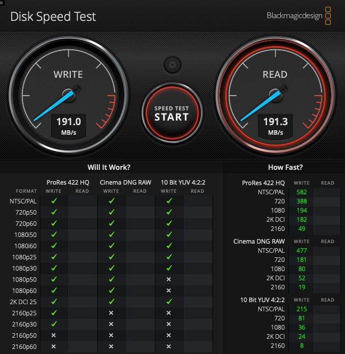

Also, I found the speed in the J2i is slower than when I use USB enclosure for both 2 drives
In enclosure normally can be 230-250MB/s Read and Write
But in J2i is just about 170-195 MB/S Read and Write
I have the J2i with the stock 8TB Toshiba and as a 2nd HHD the 16TB Seagate Exos HDD. Both are doing just fine with absolutely no errors, and they've been powered up and used for 152 hrs. When they were empty they delivered a good 220 MB/s. Now they have dropped down to around 190 MB/s, but this is normal as they do get slower as the disks fill up.

The J2i is just a metal bracket and SATA/power cables that plug into Apple's logic board. Any problems are with the drives or the logic board, or possibly bad cables.
The ONLY time I've ever seen the #188 error in DriveDx was on a drive enclosure that had a PSU fail shortly after. I'd recommend you back up your data to an external drive ASAP to avoid a larger issue later.
Assuming you're using the supplied cable(s) with the J2i? They're supposed to be warrantied. I'd at least file a support "complaint" to have this documented in case full replacement is required.

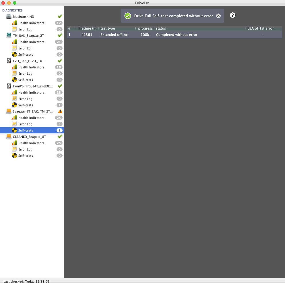

Thanks a lot, there is a self-test on DriveDx, I will run it and see the result, thanks a lot
btw is the self-test is the same as the surface scan?

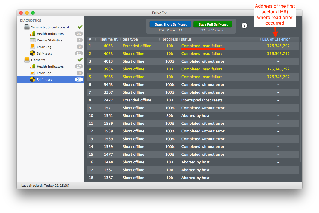

DriveDx is excellent and that is a very a good test for errors, but that is not the "surface" scan that was referred to earlier in this thread. The only standalone application for macOS that still does this (that I'm aware of) is Scannerz. Haven't used that in at least 5 years.
It is a surface scan. Full self-test of HDD includes full disk surface scan, it takes several hours, depending on HDD read/write speed and its size. In the case of surface scan error, it will report the address of the first sector where read (or write) error occurred. Please see real-world screenshot:

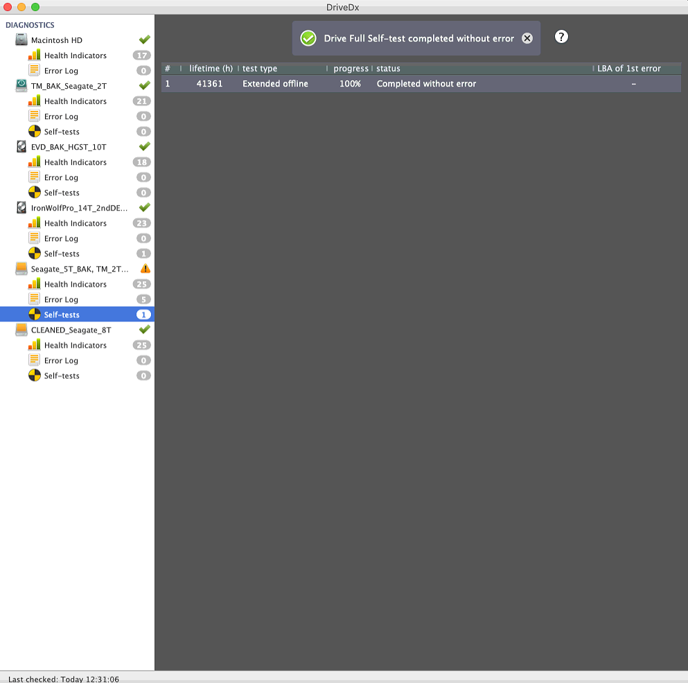

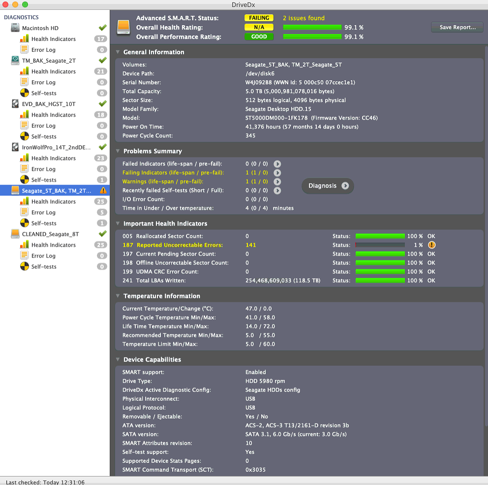

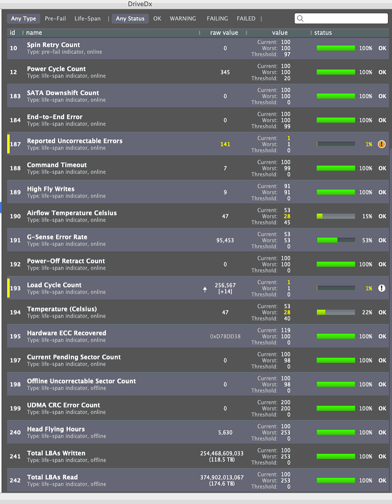

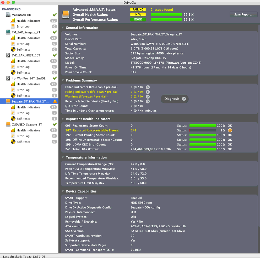

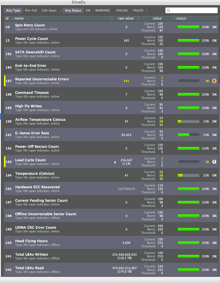

It is wired that I have run a self-test on a very old USB 5TB HDD
Shows no error, but it got a lot of SMART error
is the drive safe to use?
