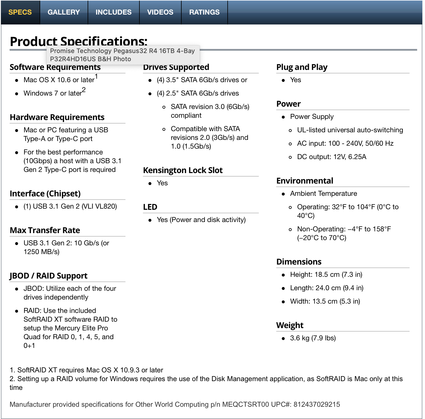

Unfortunately it looks like that OWC enclosure supports only USB-C Gen 2 speeds (10 Gbps) and not thunderbolt 3 speeds (40Gbps).
Reactions: choreo
^^^^You are right . of course. But we are talking HDDs used as external storage here.

Yeah, all that throughput mumbo jumbo needs to stand up to real-world testing for sure. :/ For example, the Mercury Elite Pro is specified as having a maximum transfer rate of 1250 MB/s using USB 3.1 Gen 2. However, it then specifies a maximum performance of 947MB/s. Check out this review of the Elite Pro quad. The measured rate for 4 1TB disks was 630 MBps and 600 MBps for read and write, respectively. That doesn't sound like 947MB/s to me. (Perhaps that "max" was for SSDs, or as the review states, for larger more performant Toshiba drives, but I'd like to see actual data...)
The Pegasus32 R4 on the other hand states that it supports both Thunderbolt 3 and USB 3.1 Gen 2. And yet from the review I quoted, it had a transfer rate of 567 MB/s and 643 MB/s for read and write, respectively. (I suspect the key point for the R4 is that it also supports a display connection, so all that "extra" Thunderbolt 3 performance is possibly to support that, rather than the disks.)
And I agree, with HDD things are capped more severely anyway. Things might be more interesting if we compared SSD throughput between the two boxes, but that's significantly more expensive.
