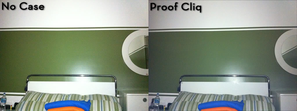

I just received my case yesterday.
I've always preferred the slider type cases but I hated how most had a line going across the back where the top and bottom pieces came together. With the Proof Cliq case, the iPhone slides in through the bottom leaving no lines or seams on the backside. This makes the case design much cleaner.
I'm pretty happy with the cases' design, build, and quality but there is one major issue regarding the camera cutout and flash. The camera and flash cutout seems to be too small. Pictures taken with the flash result in washed out images. Pictures taken without flash come out fine though. I'm pretty disappointed in this design flaw and I hope Proof come's out with a fix for it.
Here's a comparison image taken with flash on:

I got mine in white...horrible flash wash. Hopefully they come out with a revised version
Larry, would you have time to check if all colors produce washout with flash ? Or is the black one immune to this phenomenon😕, thanks.
I tried it with the black and it has a slight effect on the image. For some reason the black color feels not as soft as the other colors.

Under our own field testing we did our best to make sure the camera cutout did not interfere in the quality of pictures. Please note that other customers that have been using our cases for quite some time have not had this experience. But it seems that some people are experiencing a similar problem with undesired effects of taking flash photos. We pride ourselves in having a supreme product and want to reassure our customers that we will resolve these issues.
We have decided to go ahead and make some design changes to our Cliq case based on our recent customer feedback. Please be assured that this will be taken into consideration in our newest update, which will also be a design to fit both AT&T and Verizon versions of the iPhone 4. We are now focusing on 2 changes, the lower button and slider changes and making the the cutout for our Cliq case larger.
Also, we did not test our products with a screen protector on the back of the iPhone because we feel there is no need for it with our case design.
If you feel you would like to return the case, we would gladly refund you. Or we would also be glad to replace your case once we have our new update ready. We will be setting up a replacement program once our new design is ready for retail production. As you can imagine many iPhone 4 case manufacturers are scrambling to update their cases for the new Verizon changes. We estimate our new design to be ready in about 4-6 weeks. Once again, we apologize for any inconvenience or disappointment we may have caused our customers with this issue. Please be assured that we are working on this problem and will remedy it as soon as possible. If you have any suggestions for us and our new design changes we are always willing to listen to our customers' feedback. Thank you for your support.

I'm very happy to hear that you guys are taking steps to remedy the flash issue.
As I had stated in my previous post, the design, build, and quality of the case are almost perfect with the only issue being the cutout for the camera and flash. I think the case will be perfect with a slightly larger cutout.

A larger cutout for the camera - flash won't solve the issue, you will need to color the inline of the cutout in black at least.

i did some testing on the black and white models and it seems that the black model takes pictures fine with the camera flash on, and the white model makes the flash washout. the black model does not effect the flash as far as i can tell.
