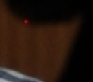

I feel like a donkey for asking this but don't want to damage my new camera. 😱
I was looking on the computer at my pictures and noticed a red dot in some of my pictures... I looked at the lens I did see some dust. When I bought my camera it came with a basic cleaning kit. I tried using the blower but did noticed one piece of dust that is stuck on there. I think this is causing the dot.
The kit came with lens tissue paper, lens cleaning fluid, a mico-fiber cloth, a blower, a brush and q-tips. Whats the best solution...
Thanks 😱

the red spot is a hot pixel. it has nothing to do with your lens. dust also has no effect on the image, unless the lens is filled with it.
for the spot that won't get blown off, you should use the lens tissue with cleaning fluid. remember to blow off any dust or debris before you use a tissue - you don't want to rub anything into the coating. don't touch any part of the tissue that will touch the lens.
what does this mean? Is my camera defective? Is like a dead pixel on LCD?
basically...it's normal since there's 10+ million pixels, vs <2 million on a monitor. what usually happens is the conversion software will map it out, but some get missed. if you send the camera to the manufacturer, they will program the camera to map out the new hot pixels.
