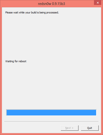

but when i follow the steps the resdnow also stuck at wait for reboot
any help for that please

if its an old bottom 3gs, it is untethered 6.1.3
it's new bootrom
You need the earlier version of redsn0w, look at iclarified again.
914b1
from here
http://www.iclarified.com/entry/index.php?enid=16424.
you might even have to go back to 4.1 to make the downgrade work
thanx for ur helping
i made the basband downgrade by dongfrading to 4.1 then make the basband downgrad and upgrade again to 6.1.3
the proplem of gbs solved that's very nice for me
so many thanx
