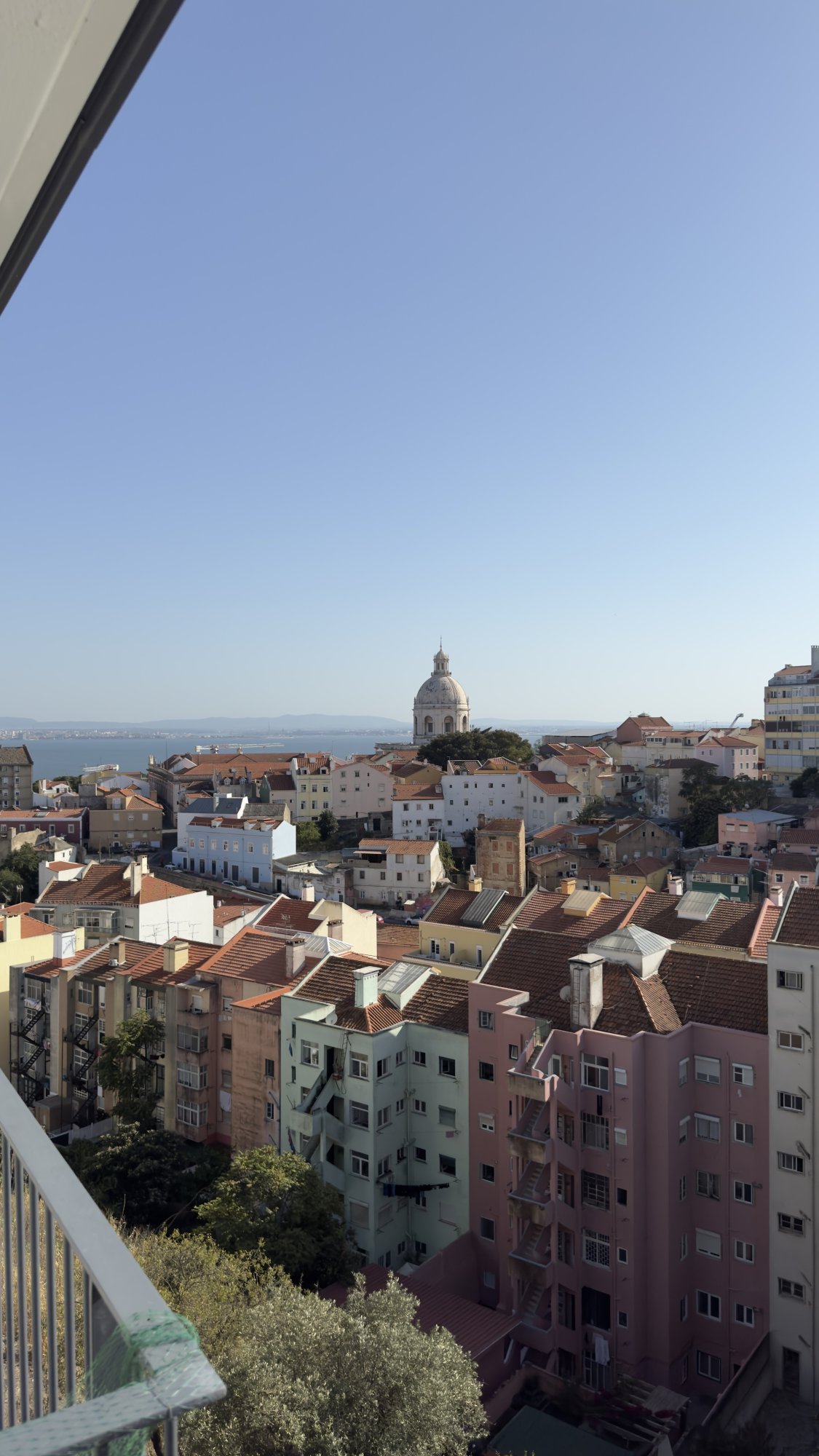

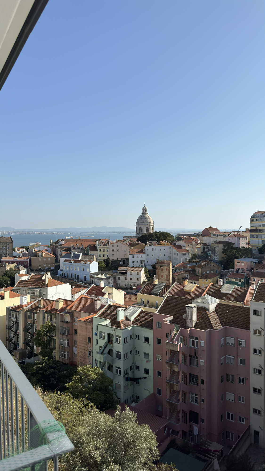

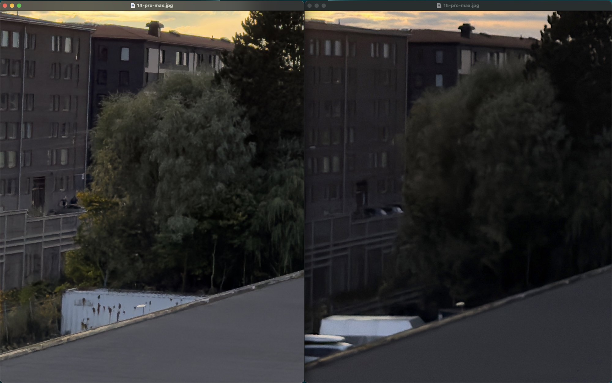

Hello all,
My first post on this forum. Unfortunately not a happy one.
I am a photographer and recently upgraded from iPhone 14 Pro Max to the brand new 15 Pro Max. Very excited about this camera. At last we get a good tele zoom that doesn't have the periscope artifacts that most Android alternatives have (lens flare in low light).
But... I always shoot in ProRAW 48 from the main lens to have the best possible quality and flexibility in editing afterwards. I immediately noticed that daylight shots taken with 15 Pro Max in ProRAW 48 are very blurry. Texture is almost non-existent and when inspecting the files at actual size they almost look painted.
Comparing to my ProRAW files from 14 Pro Max, the difference is really huge.
I actually find the HEIC 24MP mode to be much more detailed and has better texture (although with Apple's not so great processing).
Here is a comparison between 14 Pro Max (left) and 15 Pro Max (right), both ProRAW 48.
Did anyone else notice this?
I have reported this as a bug to Apple and also contacted the support that asked me to reset the device to factory defaults and then set it up without restoring iCloud backup. Had no effect at all. I am on iOS 17.0.3.
I guess next step is to replace it, but if this is a software bug that can be solved I really don't want to go through that process.
Right now my plan is to wait a couple of updates and see if it is solved. If not, I will take the device to Genius Bar.
Curious to hear your experiences. Thanks!
/ Jacob

Wow yeah, since I saw this thread I did a test on mine, same as you, ProRaw for whatever reason seems painted. My 14 pro max is much sharper.
I really hope this is just a SW problem as my phone doesn’t overheat, so far no OLED burn in, and issues that some others complained about so I really don’t want to exchange it.
I made a side to side comparison on my 15 Pro Max (HEIC 24MP vs ProRAW 48MP) and the ProRAW has a distinctive "painting finish" to it. The HEIC is way sharper and looks better.
I am now only shooting regular RAWs in 48MP using the Firstlight app and I am happy to say that it does not have any of the issues that ProRAW 48 has on the stock Apple camera. So at the moment, this is a great workaround for me.
This is also a clear evidence that it is a software issue and not caused by defective hardware.
Hopefully it will be resolved quickly by Apple in a software update.

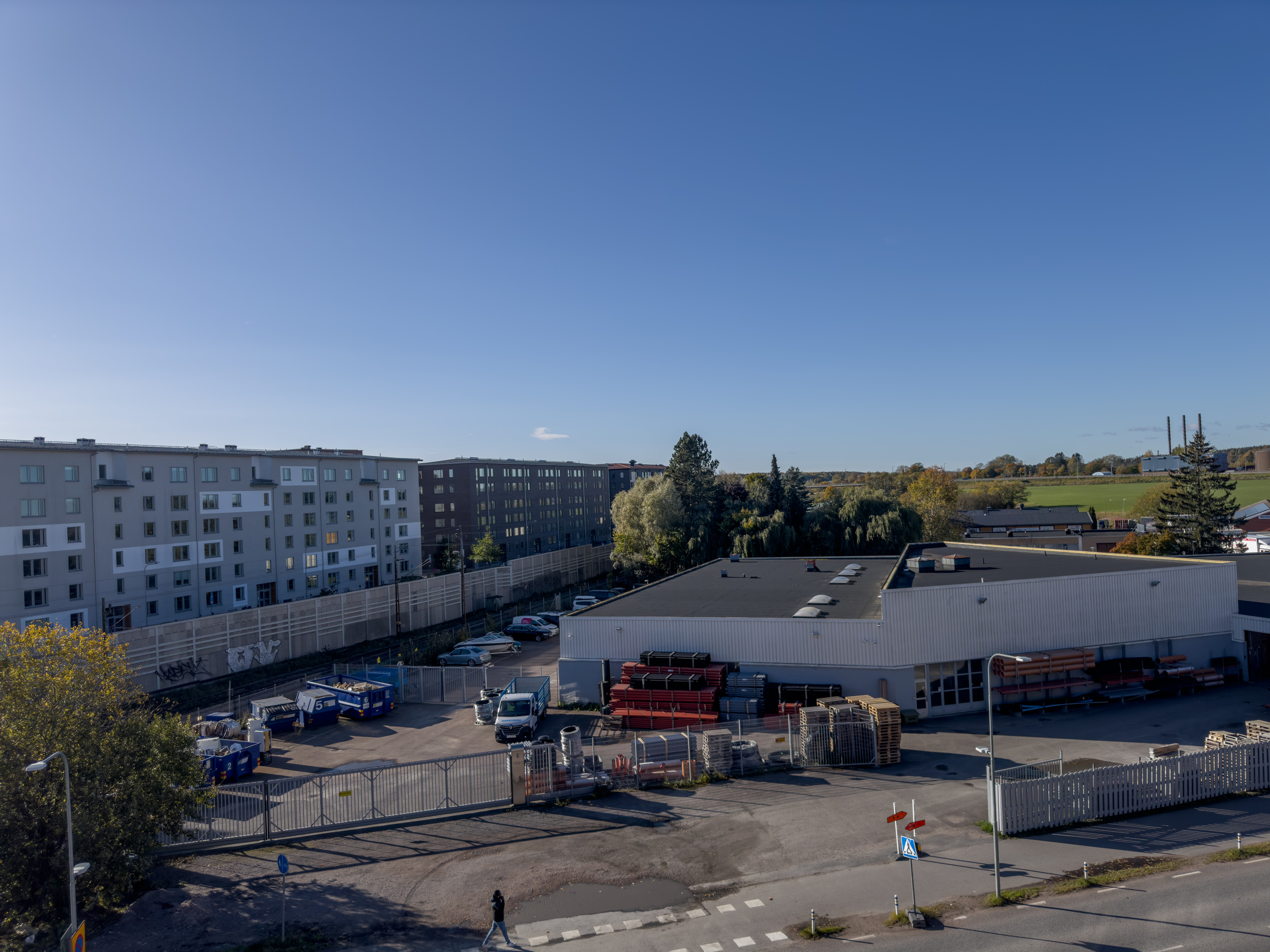

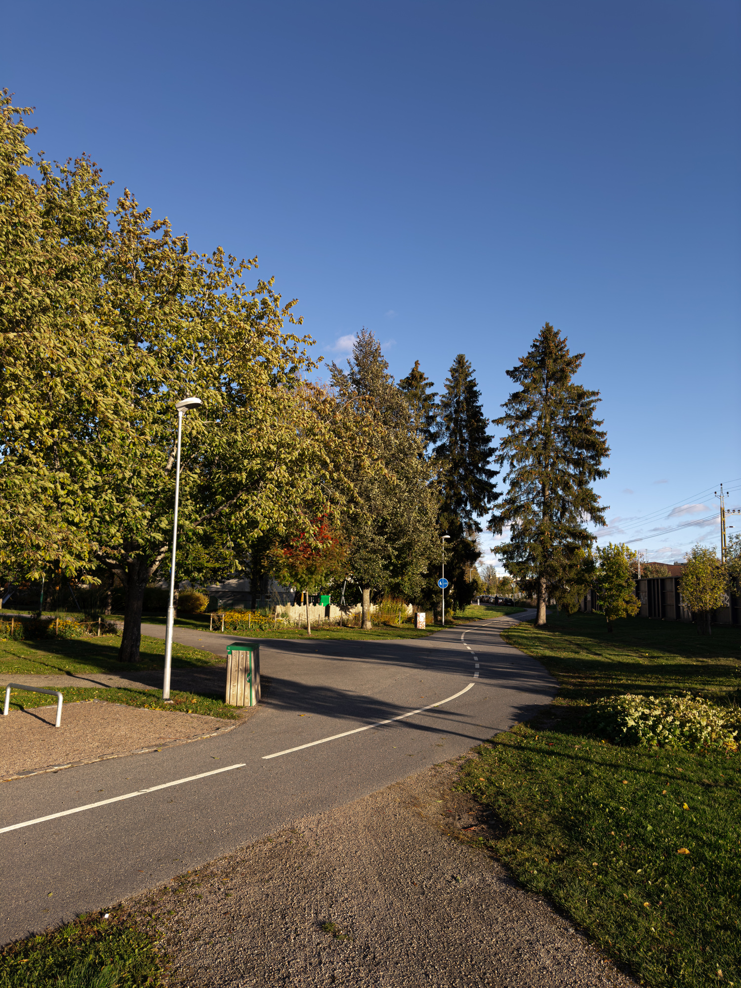

Example of a 48MP RAW from Firstlight:
Filmic Firstlight (Stock camera, 1x, 24mm, f/1.7, ISO 64, 48.77MP)

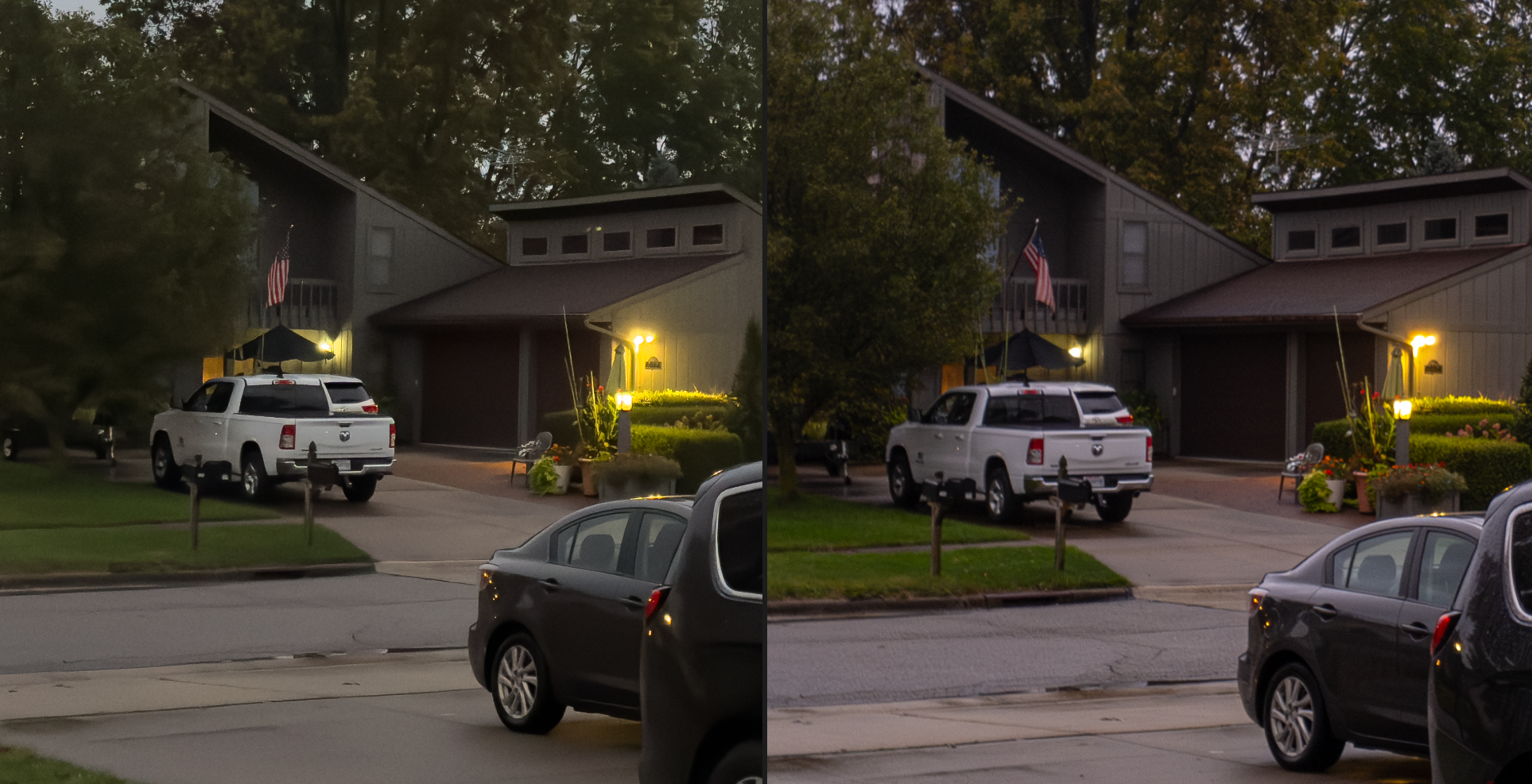

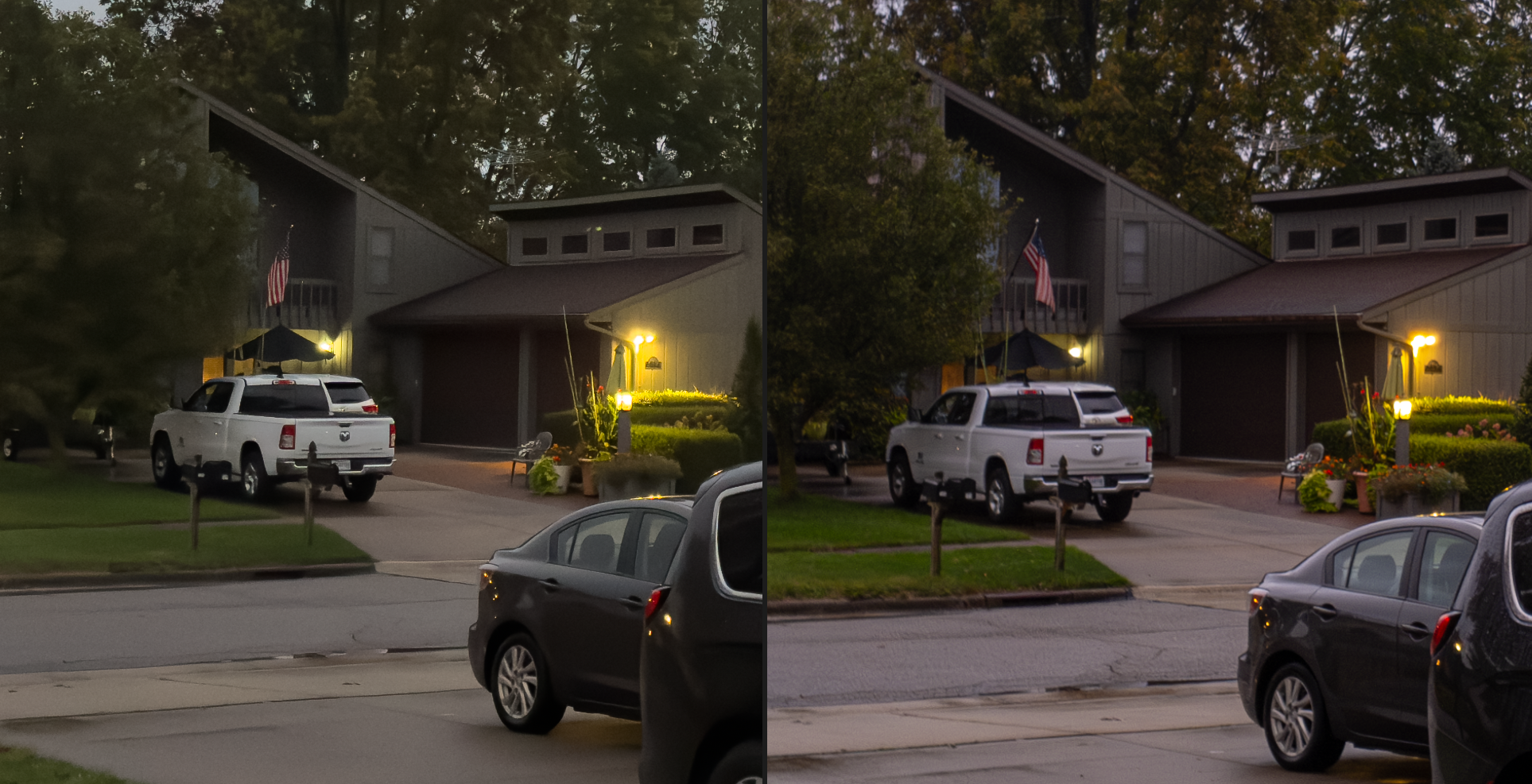

iPhone 8 Pro 48mp Proraw on left, Pixel 3 DNG on right. 100% crop.

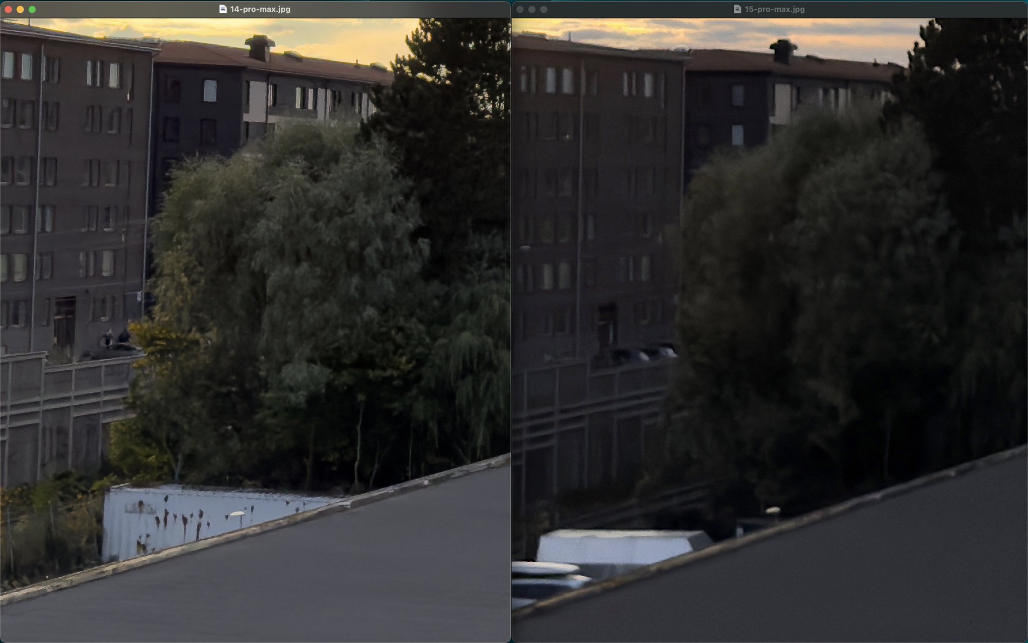

Hello all,
/ Jacob

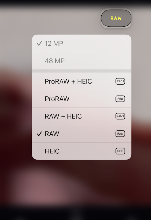

Wait, what do you mean Halide doesn't get you a 48MP RAW file? It does though! Don't you have the setting for that? In "Capture settings" I can choose 12 or 48 MP and then HEIC, RAW or ProRAW.
You can only select ProRAW 48mp, not regular RAW in Halide. If you have ProRAW selected, then click 48mp, it will let you click RAW, but then also selects 12mp, if you go back and look at it. 48mp is greyed out. This is what makes me think maybe Filmic is doing something different here. The Halide people have a great review of both 14 and 15 cameras here:
Just noticed the data for the photo says this is ProRAW. It also says it's from the stock app, so it makes me think maybe Filmic isn't labeling the EXIF info correctly. Have you tried using this Filmic/48mp raw combo in lower light(blue hour)? It seems like you said, Apple is trying to aggressively denoise the ProRAW but the algorithm gets confused on fine details. Unfortunately, I've already boxed up my iPhone 15 Pro to be sent back. Even at its best, it's just not enough of an improvement on my previous phones for the money spent. Same can be said about the Pixel 8 series.

The RAW 48 from Firstlight is clearly very different from ProRAW from Halide or stock camera. One big difference is that highlights/shadows can be adjusted much more than in regular ProRAWs. It behaves more like a DNG-file from a DSLR. So I still believe Firstlight is doing something different.
Although Firstlight 48MP RAW is better than ProRAW 48 from stock, it still seems to be something odd going on with sharpness/focus over the image.
