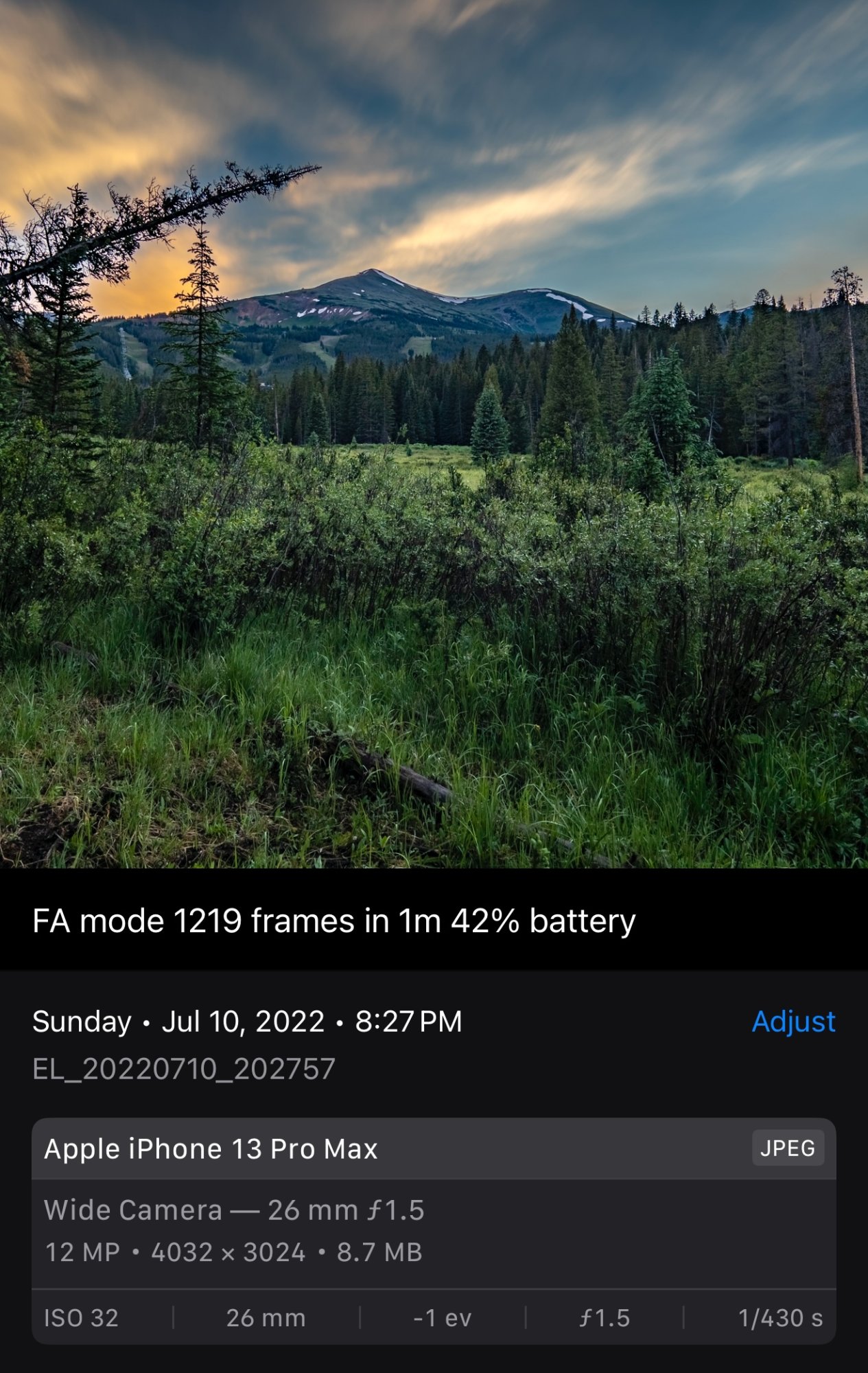

Check out the Even Longer app. Awesome dynamic range with stacked photos. Here is a perfect example. I exposed for the highlights and raised shadows in Lightroom mobile
Not the exact same photo, but taken the same time. I couldn’t find the original dark file form even longer, but this one just has a tree in the shot.
