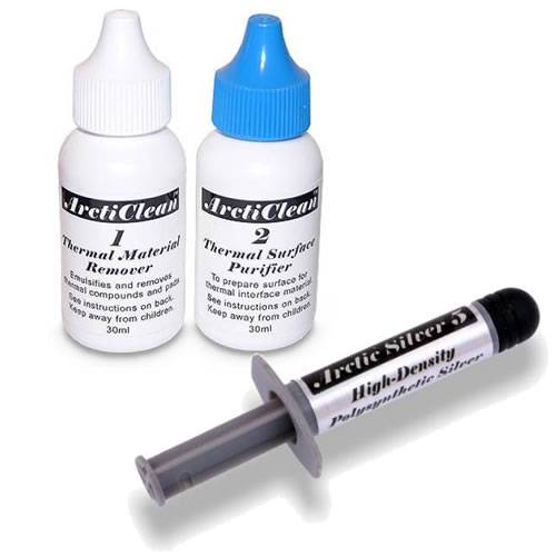

Just a correction here.
I don't use alcohol. I use Arctic Silver's cleaning solutions. They come in two bottles.
One cleans, one polishes up the surface when you're done.
The coffee filter thing was suggested by a website as a sub for a lint free cloth. When they are dirty, just toss them and get a new one.
If you have access to them, Kimwipes are the gold standard for a lint free cloth. I also like to use lab-grade solvents, which are generally cleaner than consumer grade stuff. I realize not everyone can do this, though.
When at home, I've been using cloth gun cleaning patches to clean processors and heatsinks. These are generally cut up cotton flannel, are cheap(of course, I buy them by the thousands, but a bag of 250 is $3 or so at Walmart-I mostly use the 2" square ones). Also, when at home, I use VM&P Naptha along with denatured alcohol. Acetone can be useful, but be extremely careful with it around plastic and also follow up with another solvent.
A razor blade can be useful to clean up heatsinks also. I shave with a double edge safety razor, so can just grab a blade that has been "retired" from shaving(I change them every three days). Of course, the trouble with double edges is that it can be hard to hold one without shredding your hand-if you don't have double edges on hand, buy some single edge blades intended for utility knives.
