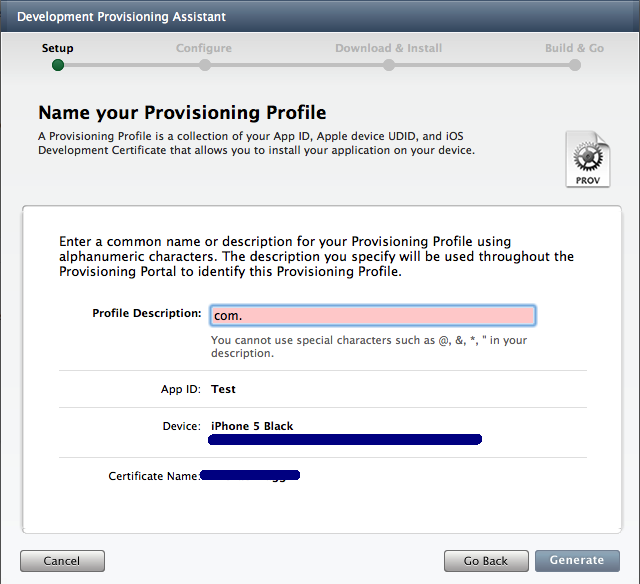

This is the screenshot:
Ah!
Your "Profile Description" shouldn't follow the "com.myname.appname" format. It's just a descriptor of your provisioning profile. One example is "iOS Team Provisioning Profile". Another might be "appname Dev Profile" or "appname Distribution Profile". It's used mostly for informational purposes.

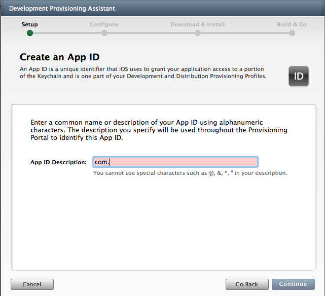

So is where the word "Test" is in the screenshot the App ID? If so, how do I check to see what on earth I typed in there last night? I don't see anything in the organiser in Xcode.
Actually, I think I've given you the wrong screenshot. This happens on the App ID screen too, which is where, in this case, I typed "Test".

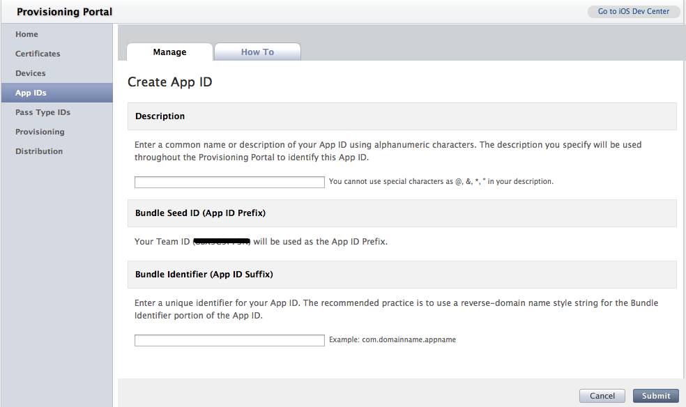

Again, that's just a description, for informational purposes. It's when you specify the Bundle Identifier that you will want to use the "com.domainname.appname" format.
Ah.
I take it this is screen where that matters.
On that basis I think all I have actually done is create a provisioning profile. I haven't actually created the App ID and specified any bundle identifiers. All I have done is created the Bundle Seed ID, I think.
I will perhaps delve into that when I need to - the wildcard one will do for now.
