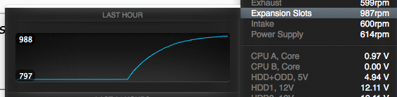

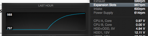

I have noticed that, when using Mavericks, my PCI fan will begin gradually climbing from 800 rpms to 1000 rpms.
I do not know what triggers this. It normally happens within the first hour of usage. There are no fluctuations. Just a gradual, gentle, steady climb in speed eventually settling at 1000 rpms.
There it will remain until I reboot, at which point, the PCI fan returns to 800 rpm.

About 30 minutes ago, my PCI fan began it's steady increase. I've been on most of the day, but it's only now just started to climb to 1000.
I was browsing through some high-resolution jpeg's using XEE, so that may have triggered it.
This never occured in Mountain Lion. I use a GTX 650 by Zotac.

And the fan is now at 1077 rpm and still going up.
