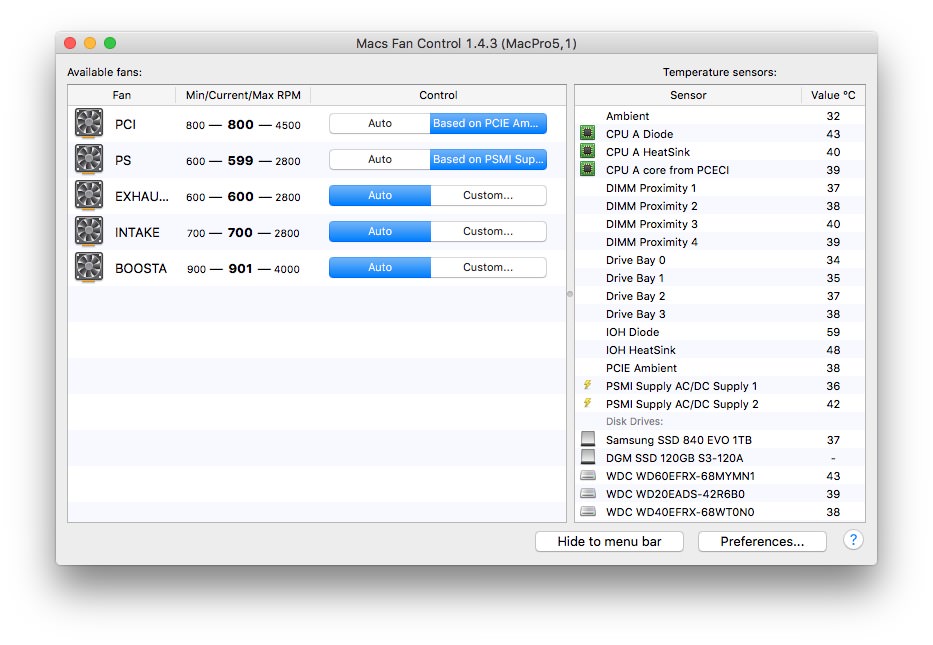

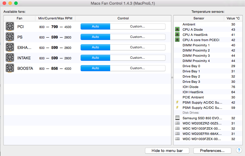

You may upload this screen capture. And check if we can find out why the CPU fan stay at 850RPM. (P.S. I manually setup the CPU fan profile, that's why it stay at 900, and intake stay at 700. I do that to lower the NB temperature for 5C during idle.)

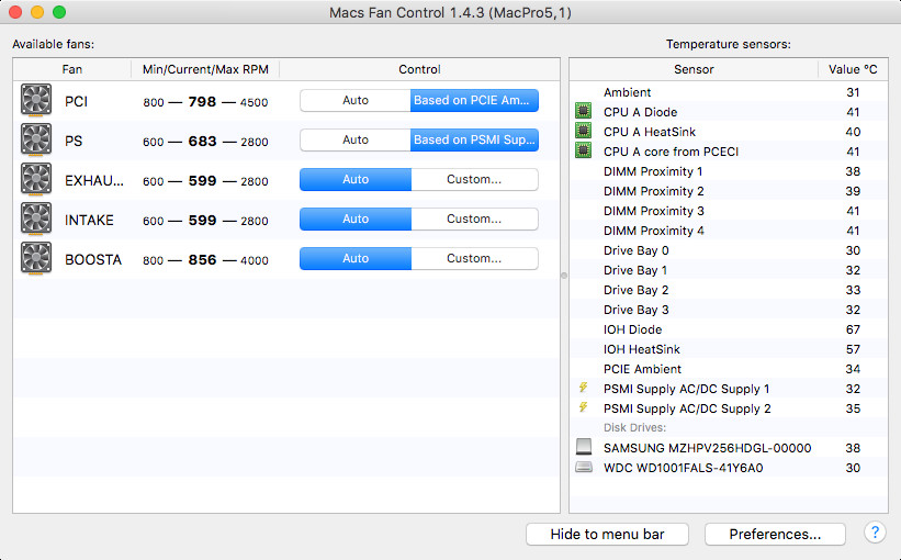

Thanks, here's how mine looks like. Usually the PS stays at 600, today is kind of warm and it's misbehaving as you can see. PCIE and PS are both controlled by the sensors on a 34-60 slope.
The IOH temperatures are substantially higher than yours. Not sure what that means. BTW it's a 2010 hex core 5,1 machine, and if I search specifically for this model, I see that the BOOSTA should actually be at 856 on these machines.

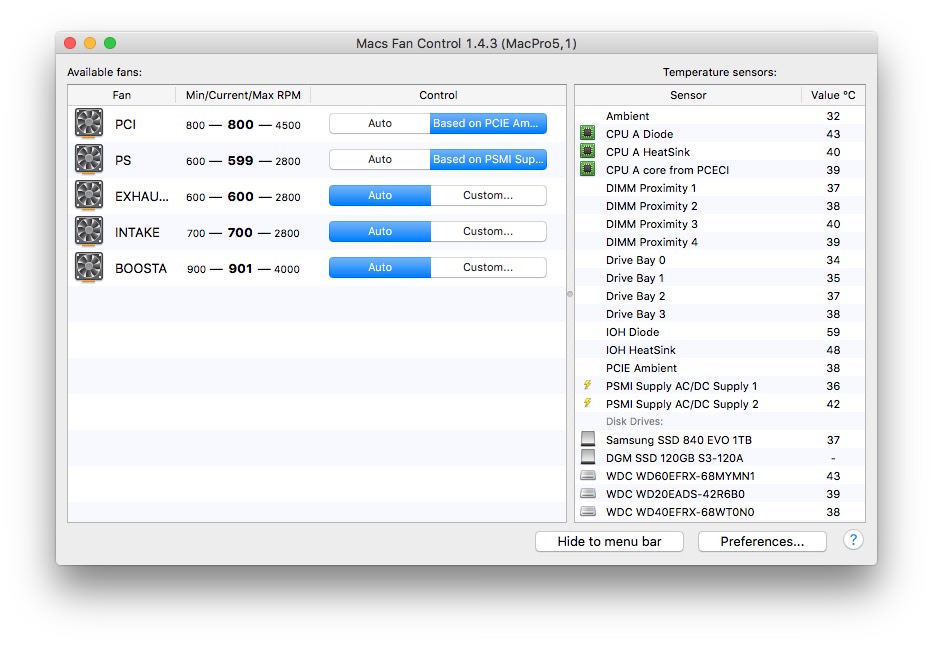

edit ps thats just with firefox open with 50ish tabs open i gess

OK, that's absolutely normal, the exhaust fan is the ultimate control of the intake and booster fan. You can try to hard tune the exhaust fan to 700, then you can expect the see the intake also go up to 700, and booster go up to around 1000.
The booster fan cannot go lower than ~1.42x of the exhaust fan speed. Since your exhaust is 600 now, so, 1.42x 600 ~ 850.
The native fan speed vary from time to time, an OS upgrade may change the default fan speed. Some time ago, the default exhaust fan speed is 100RPM lower than the intake, that's 500RPM, so, the booster fan can stay at the min 800RPM, because it's higher than 1.42 x 500.
And now, if the default is 600. I think 850RPM is the lowest you can get for the booster. Don't worry about that, you Mac is absolutely normal.
About the NB temperature, the chip is rated up to something like 105C. So, your temp is actually good. I just personally don't like that. Therefore increase the idle fan RPM a bit to cool down the NB a bit more. It's just a personal preference.
