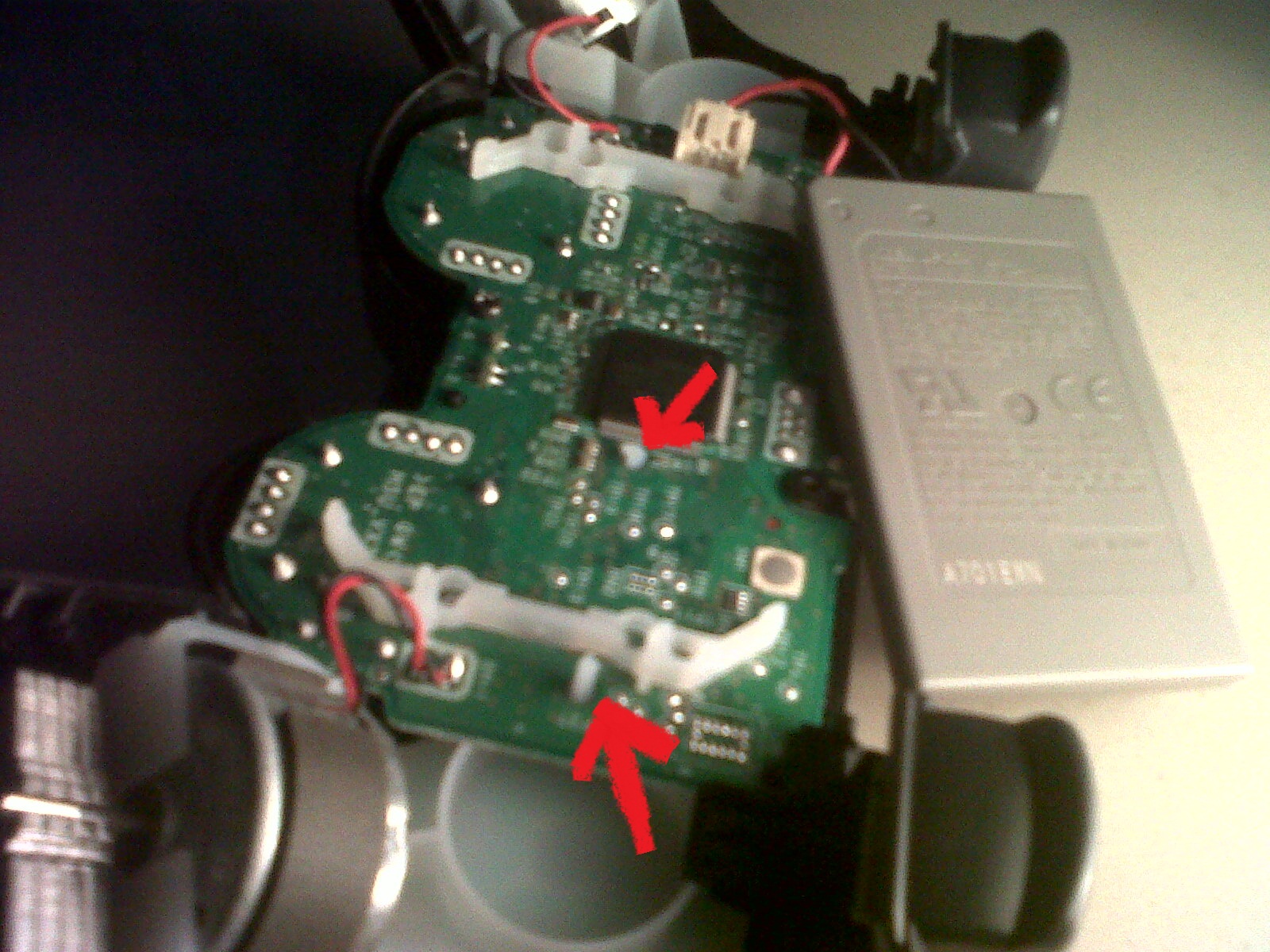

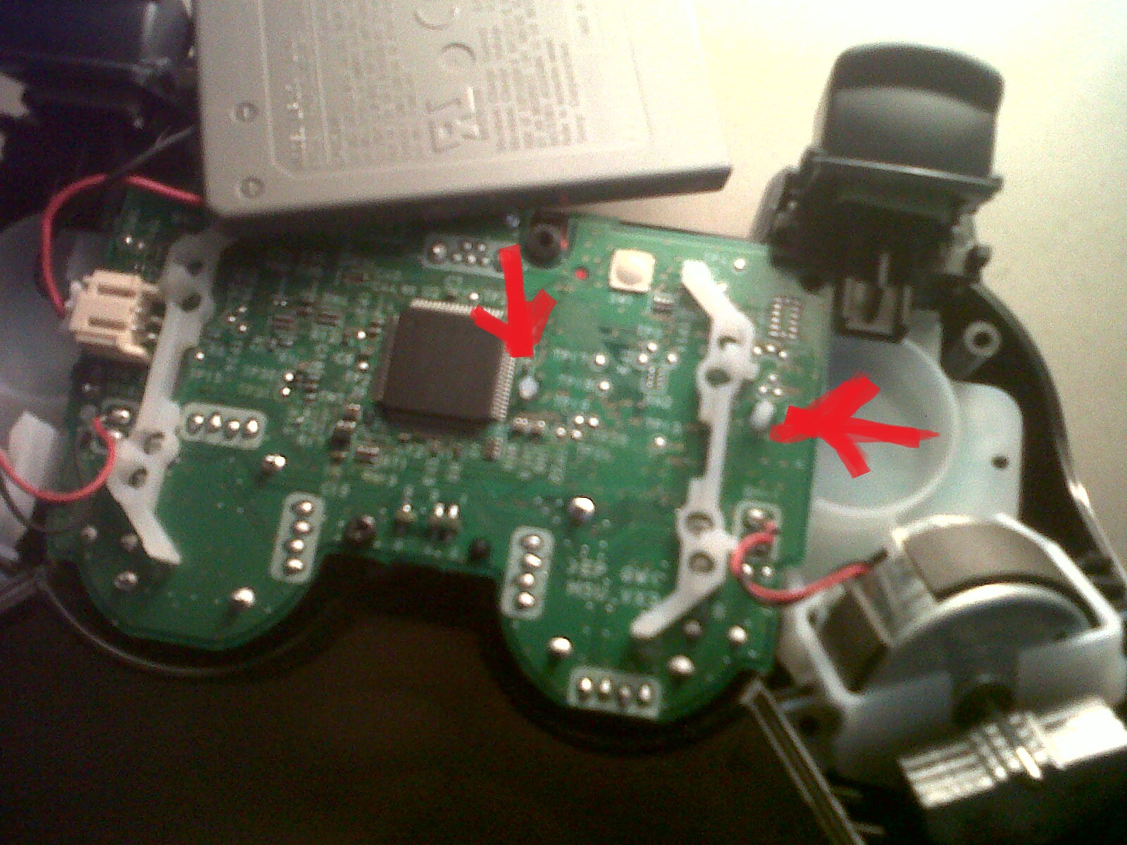

Fixed finally !
I knew it was something inside the controller.
Ok guys, i dunno about you guys, but most of you must have tried to open the controller like me.
My controller was dead. it was not powering on the PS3 by pressing the home button.
there are a couple of things you need to keep in mind.
1. all connections inside are not soldered, there is a film of connections that have to be placed perfectly on the buttons.
2. the buttons on the back of the controller, 1 and 2, (you press them using your index fingers) are tricky to assemble , so remember how you took em off to assemble them right
My issue was simple a non aligned connection. the moment i set it right , the blinking thing stopped.
As a couple of people here have mentioned that dropping the controller helped them get it working..is probably the reason you accidently got the wiring in place.
The moment my strip got into place, it came back to life instantly.
P.S. mine was completely dead, the home buttons was not responding at all.
the blinking lights used to stop flashing after some time.
I'm attaching the pictures i took, and the wire i set in place. The 2 plastic white colored pins indicate that there is a wire strip under it.
mostly it gets out of place. Fix the Wire strip under the motherboard onto the two white pins, adjusting it using the holes on the wire strip. then install the mother board on top is it ....
hope this helps ... you guys might save on some $$ in buying new remotes ...
