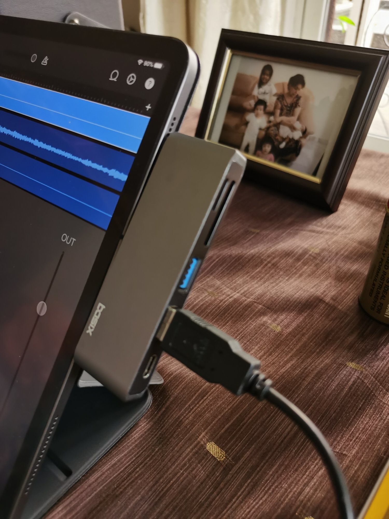

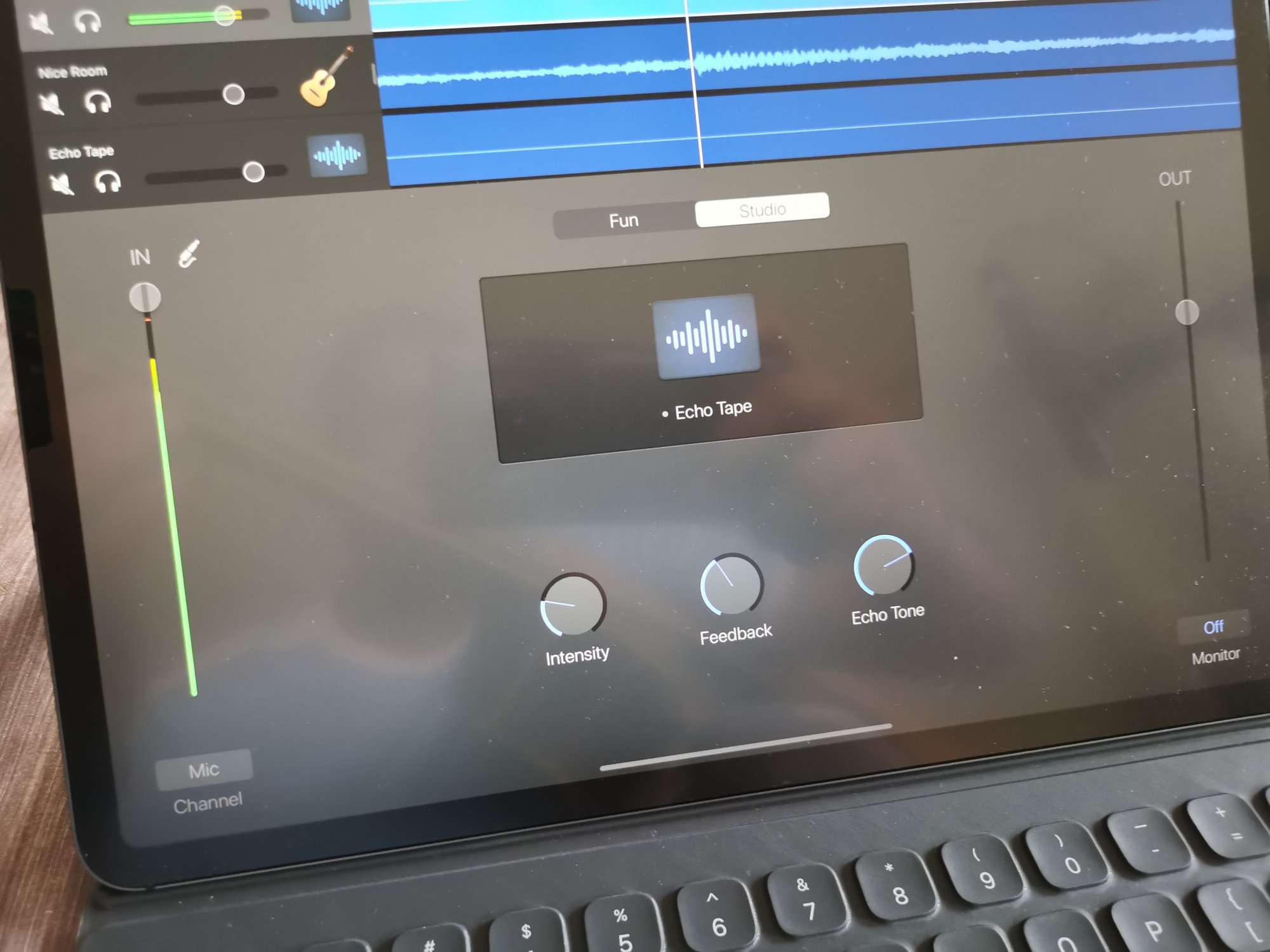

Actually, I bought an Apogee One and after reading that it was not compatible with Ipad Pro2018/2019 i left it there for a year in my store. So the other day , I read that the windows driver is up for Apogee One and i tried my Apogee One for MAC and IOS with Windows 10 machine .. and IT WORKED!!!! It sounded so good..
Then out of curiosity, I put on my USB C hub into the Ipad Pro and downloaded Apogee maestro app. I plugged in and WALLAH!!! I got full signals and i went on Garageband and tried it... it worked completely! No hiccups .. NOTHING! It was full signal. no compatibility issues.. it worked like it should. Pristine recording of my acoustic guitar..
all it took was a cheap USB C hub into my Ipad.

@AE_stc it would be great to know what type of hub you used to get this working. Did it come up in the Apogee Maestro app on the iPad Pro? I can get the audio out to work, and dial controls volume control, but not able to select the input in Garageband, or get Maestro to recognise it. Literally did the same thing and purchased without realizing the iPad Pro wasn't supported! 🙄
I’d be very interested to know what type of hub you used and what version of iPadOS you’re running. That hasn’t been my experience at all. It will WORK but I can’t change, or view, any of the settings plugged into the iPad.
Doesn’t work with my Inatek USB-C hub. Tried via USB-A & USB-C. Not recognized in Maestro.
EDIT: Apogee still has it marked as “least compatible”on their website. If you’ve discovered a unicorn work around please share the details!
Reactions: AE_stc
Its a basix Usb c hub. It also provides power to the apogee and charges when I connect it to the charger. Running iOS 13 latest version
Wow - that’s really interesting. Do you know what version of firmware you have on the Apogee One? and I’m guessing you are using the latest version of Maestro (I say latest...it was last updated two years ago it seems). Last night I tried the apogee directly into my ipad Pro and it showed up in Maestro - but when I unplugged it and then plugged it in it disappeared. Out of interest, can you see it in the ’settings’ of the iPad at all? - going to see if I can find one of those basix hubs... 🙂

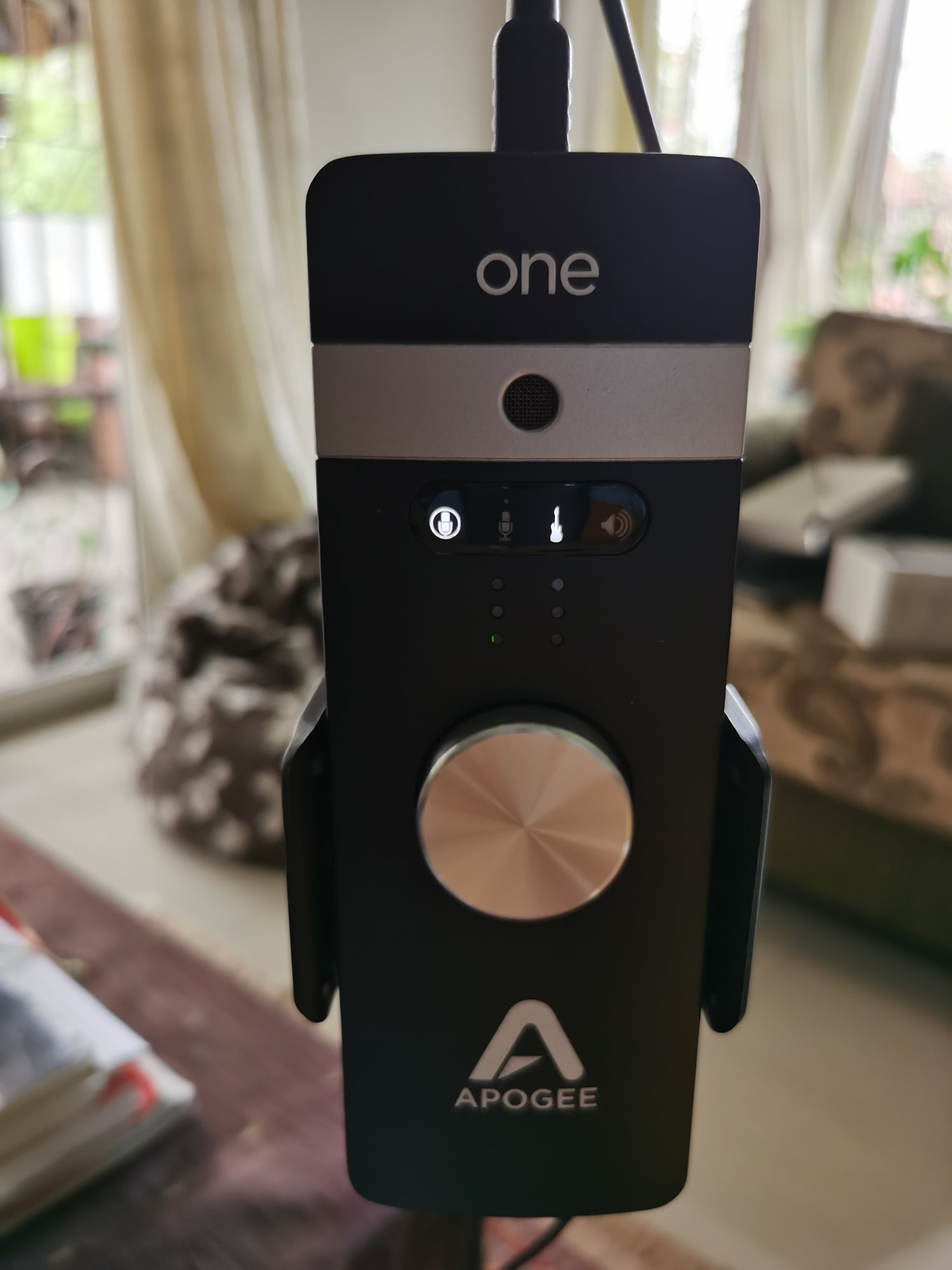

OK Update.
It is not stable. On the picture i sent on the apogee unit, notice the mic light lit up? When i tested it again .. it is not working anymore. And the gain faders do not work. Which means it is intermittent and not reliable. However when it works.. it is a beautiful unit.

This seems to be a similar experience to the one that I had, except I think @Shiva Shiva you managed to get a bit further than me. It worked, but for not very long. The fact it can work is more annoying than it not working at all, as surely it is a case that drivers could be reworked to iron this out. I've resorted to using it with the macbook air for now. Agree that when it is working, it's really great. Looks to me like devices compatible with iPad Pro for this kind of thing haven't caught up yet
