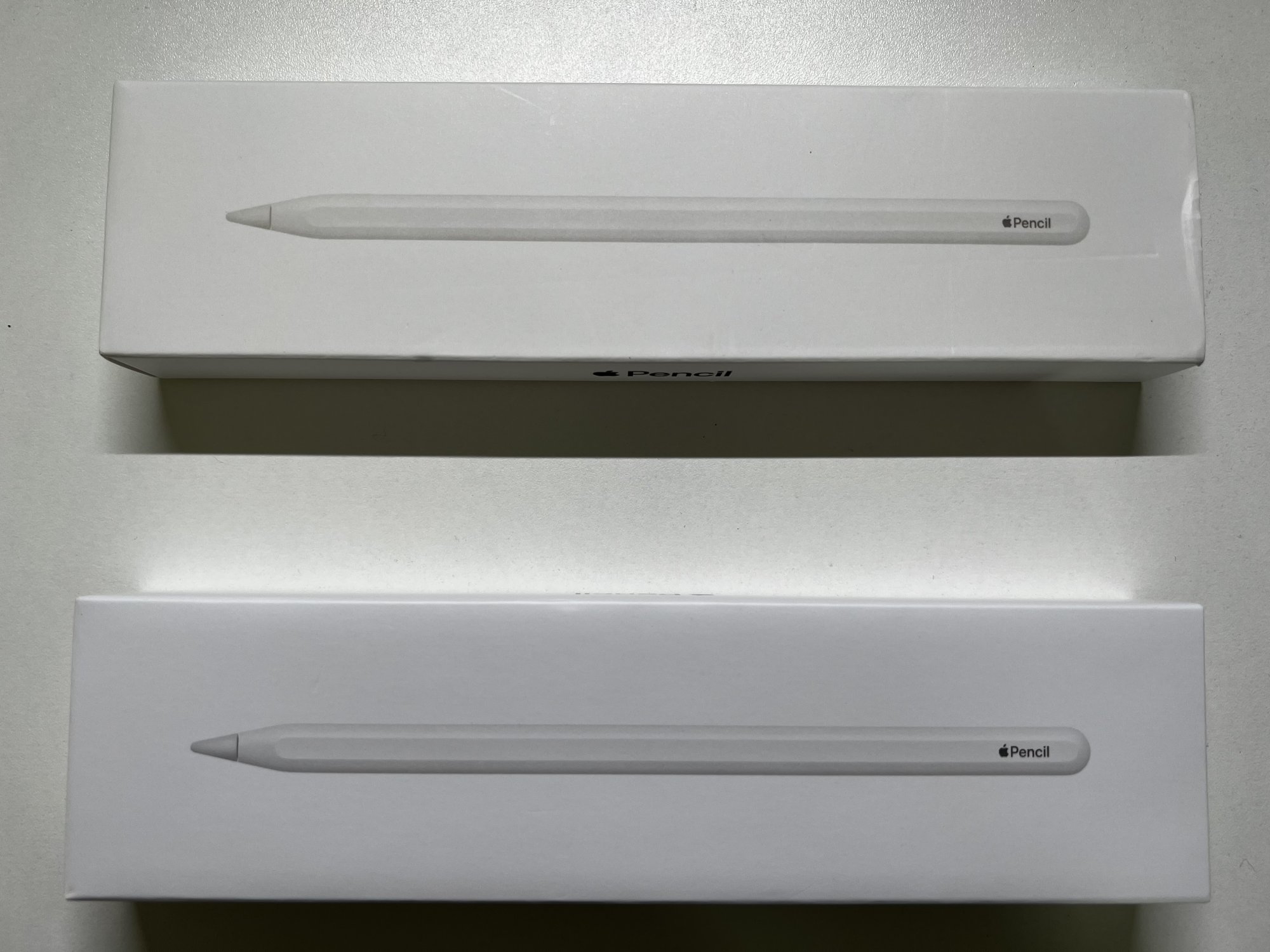

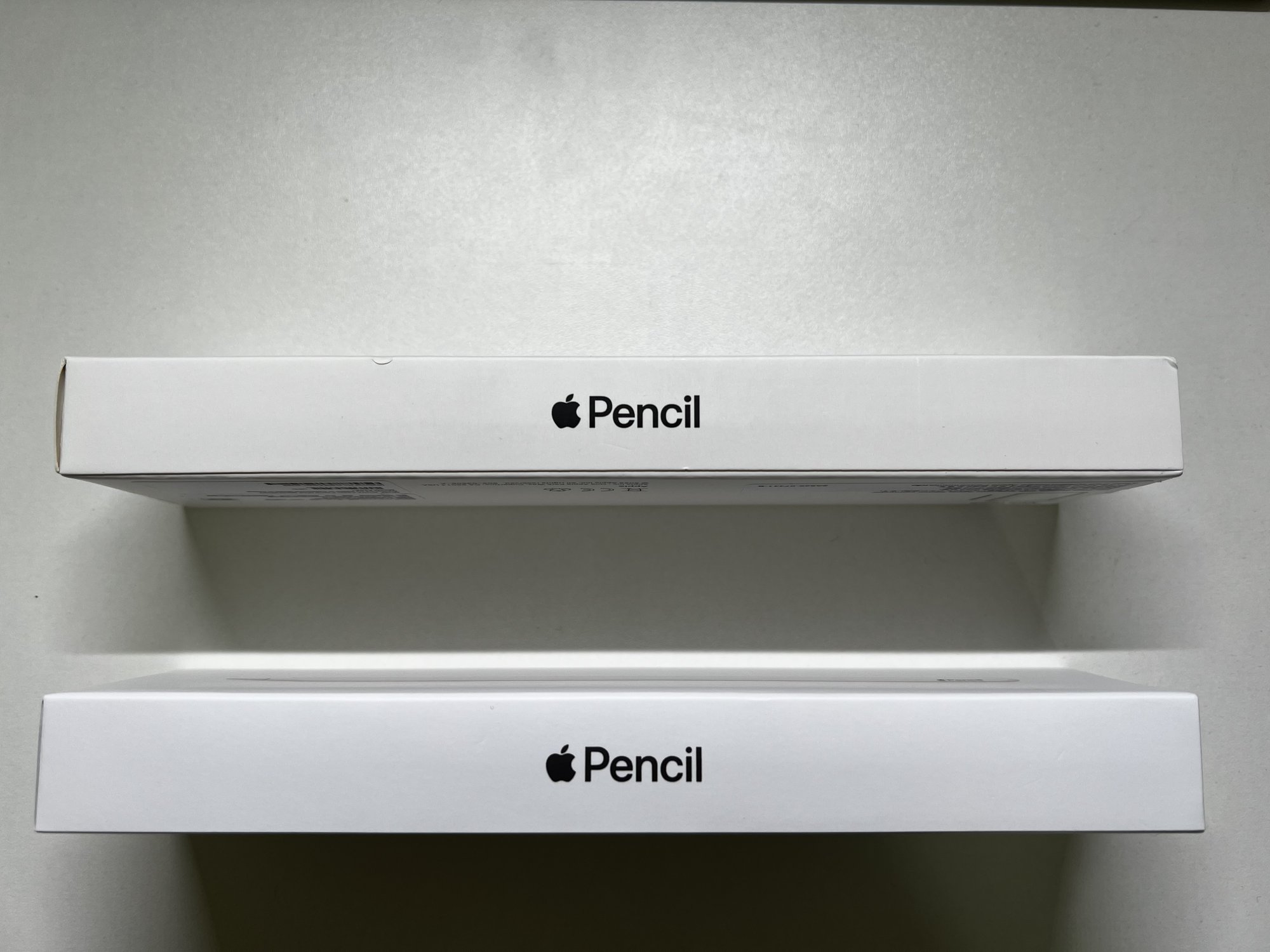

I recently bought an Apple Pencil 2 which I was told was genuine. when I received it - the packaging looked a little off (in that the clear wrap seemed a little cheap and flimsy and not like Apple's usual standards) - at first glance though it looked ok (other than the stickers on the back being a little crooked! - another tell!).

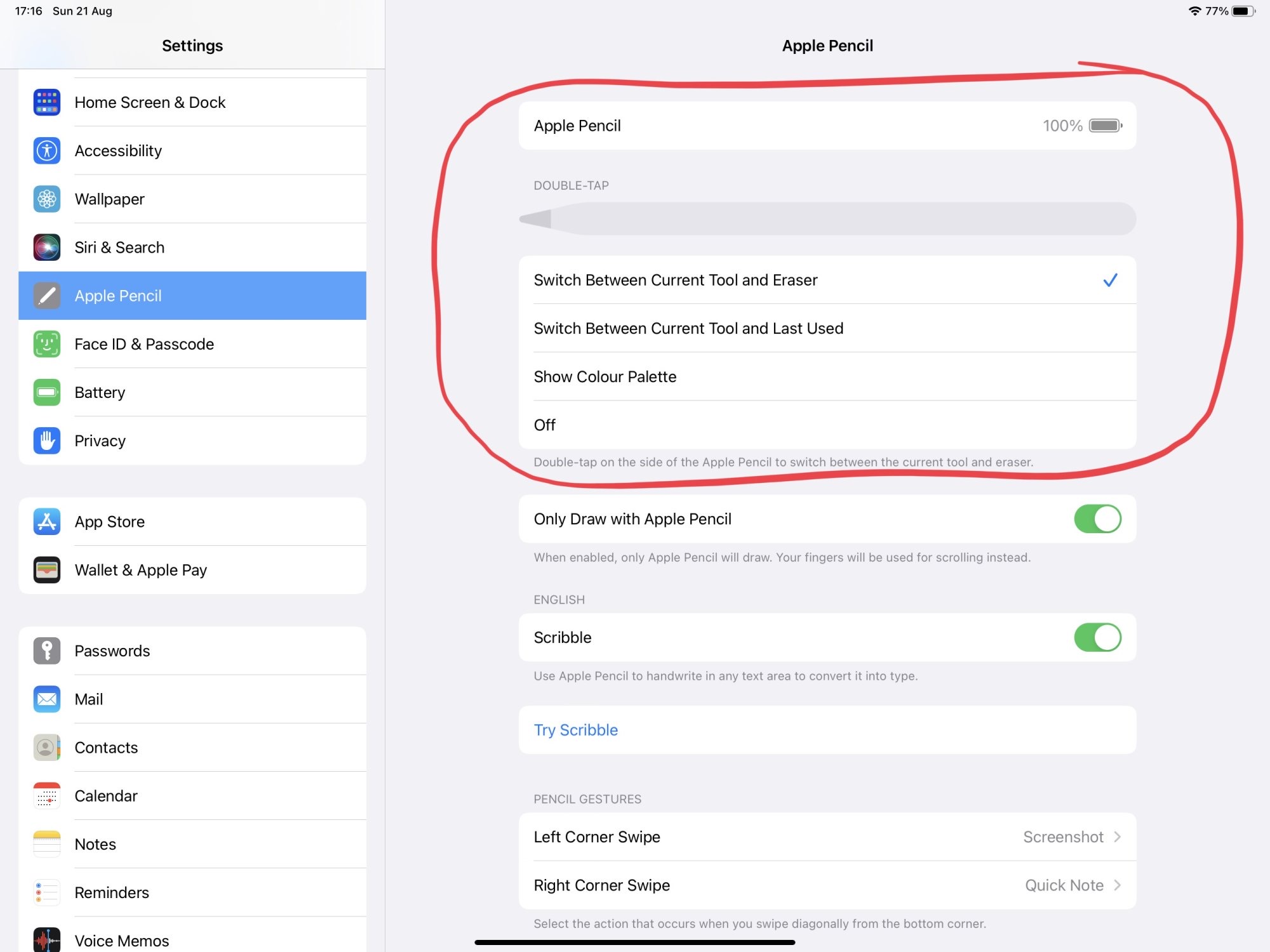

I then paired it to my iPad Pro 4th Gen 12.9" - I did this by attaching it to the magnetic strip and even got the rotating pencil animation!! - however, in the Apple Pencil settings I had no option for the double tap setting and no details of the battery (i.e. the top section of that screen was completely missing).

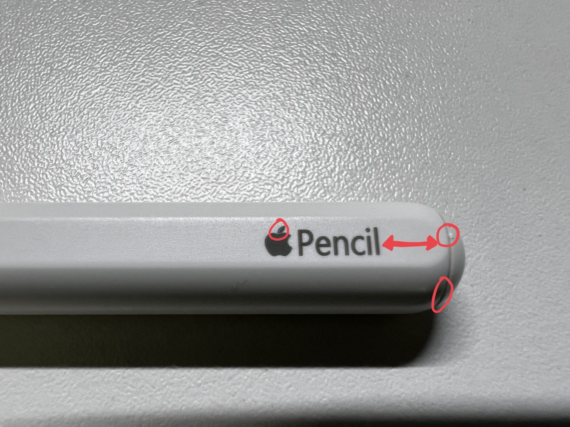

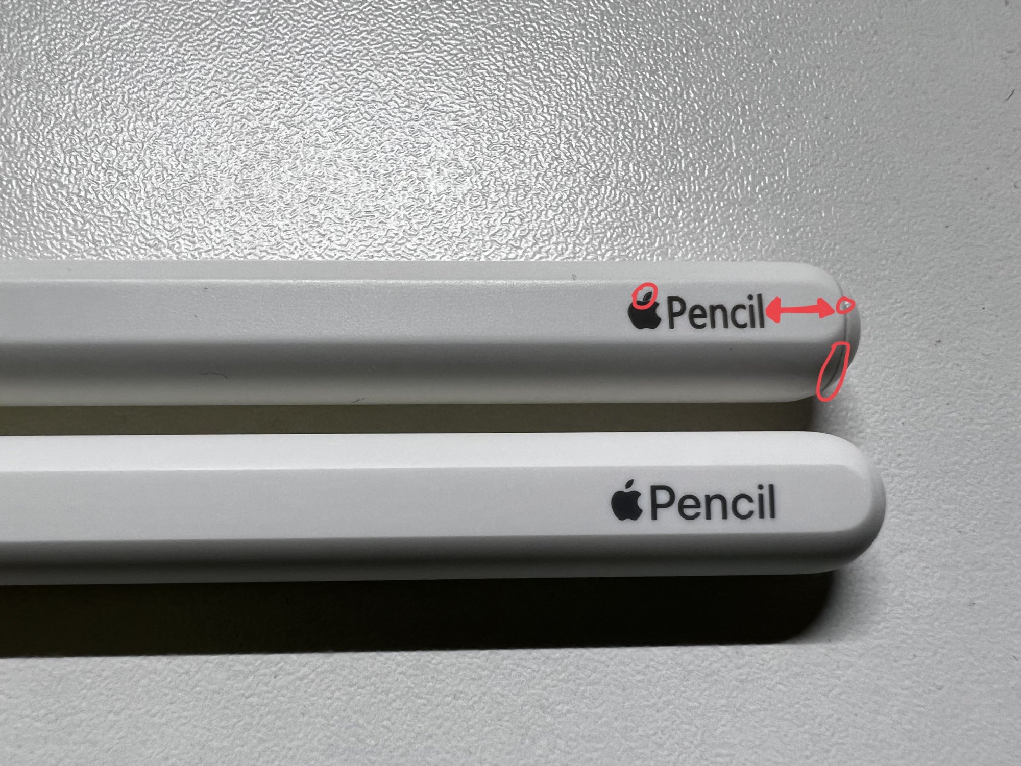

Onto the pencil itself - it didn't have any pressure sensitivity and seemed a bit skitterish when trying to use it (however, it DID work!). The plastic body of the pencil wasn't exactly smooth and I noticed the font looked a little off and it seemed to be embossed rather than printed.
It also showed in the battery widget as an 'Apple Pencil'! although, it didn't trigger the welcome to apple pencil demo that usually happens. The end cap also has a bit of a gap between the main body and a little bit rough from the casting and when I removed the top - it had a gold and black transducer instead of a gold and white one as found in the genuine Apple Pencils.

Fake on top / Genuine on bottom:

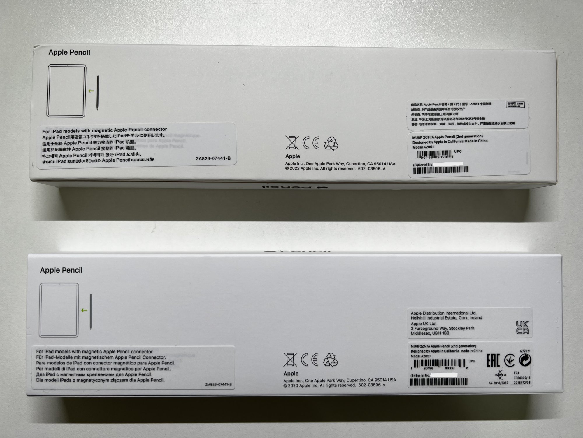

Fake on top (crooked stickers)/ Genuine on bottom:

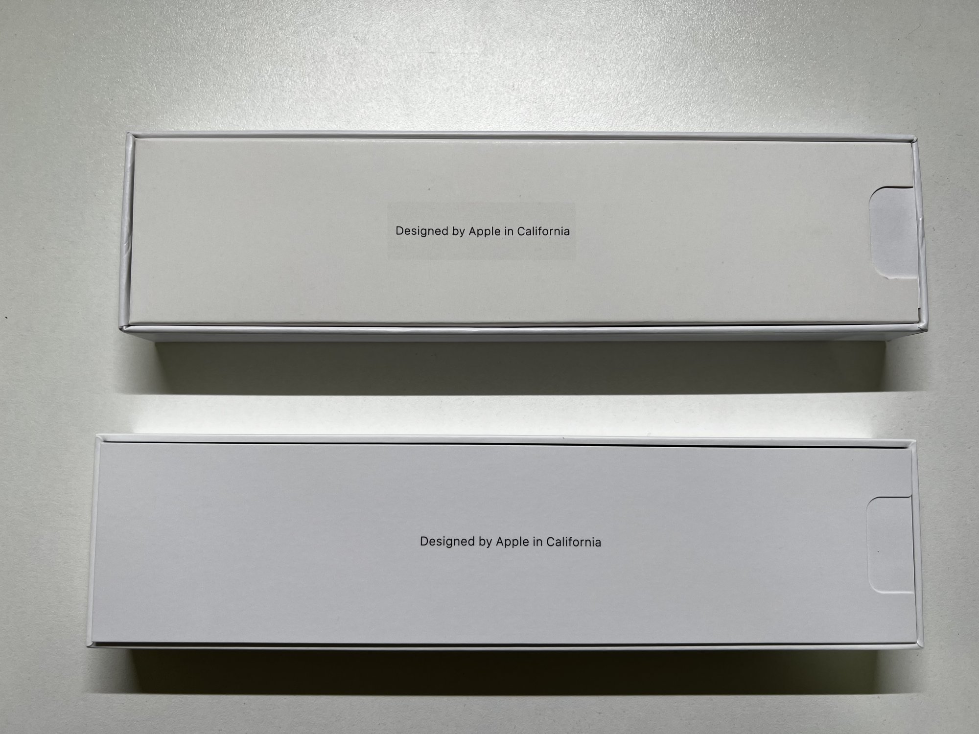

Fake on top (printing not central) / Genuine on bottom:

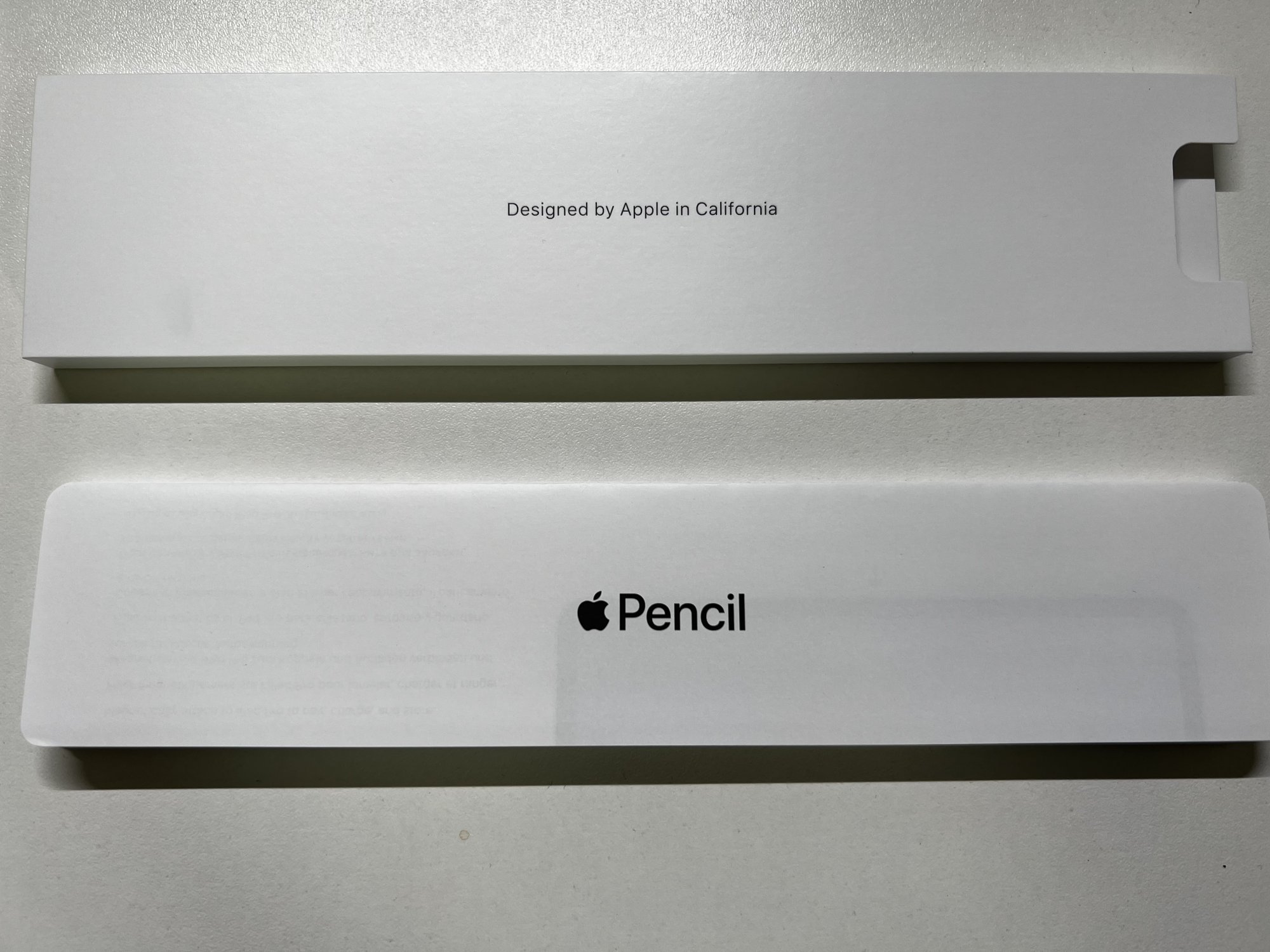

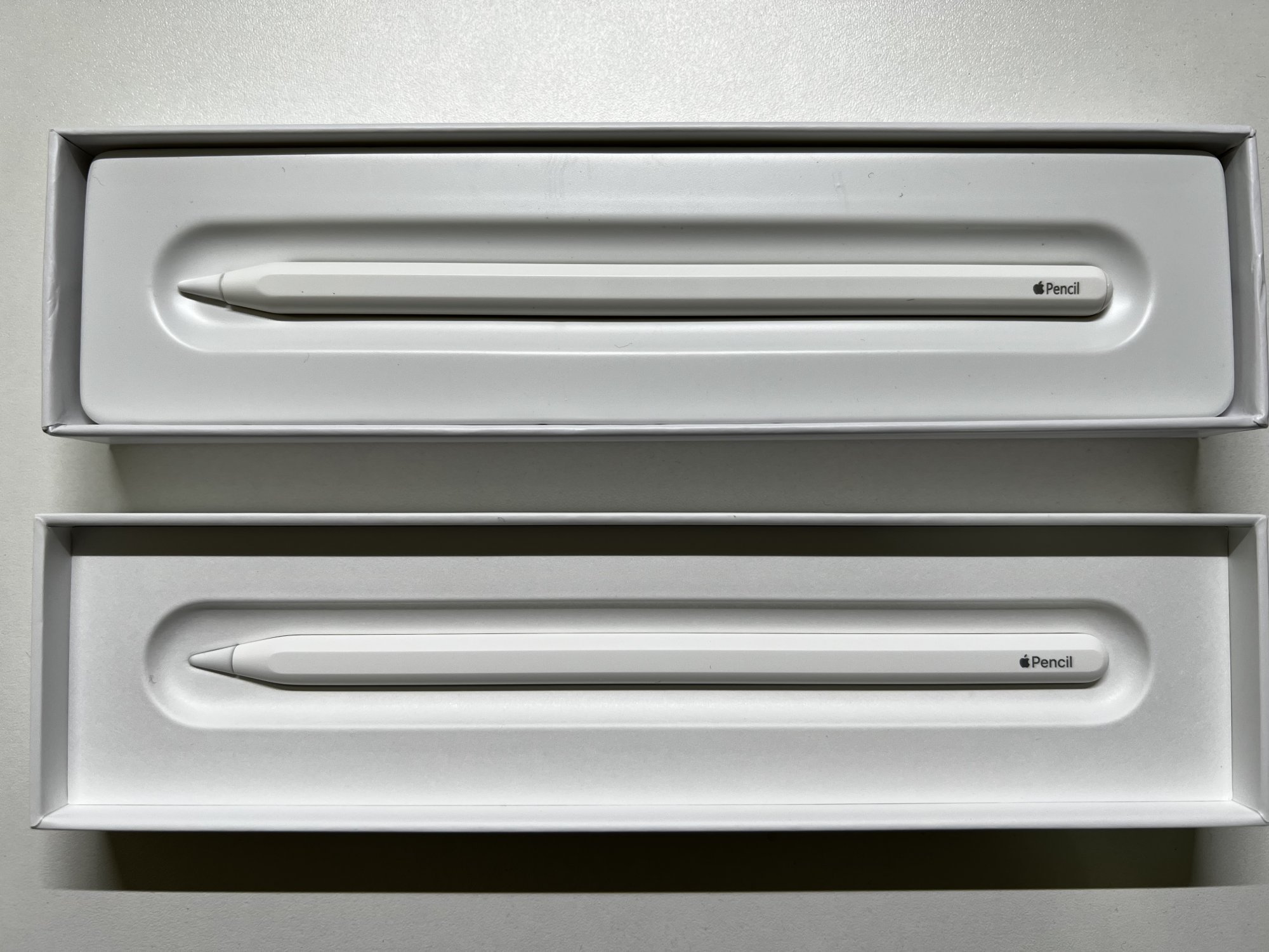

Fake on top (didn't have plastic sleeve- and mould has rounded edges)
Genuine on bottom (plastic sleeve removed)

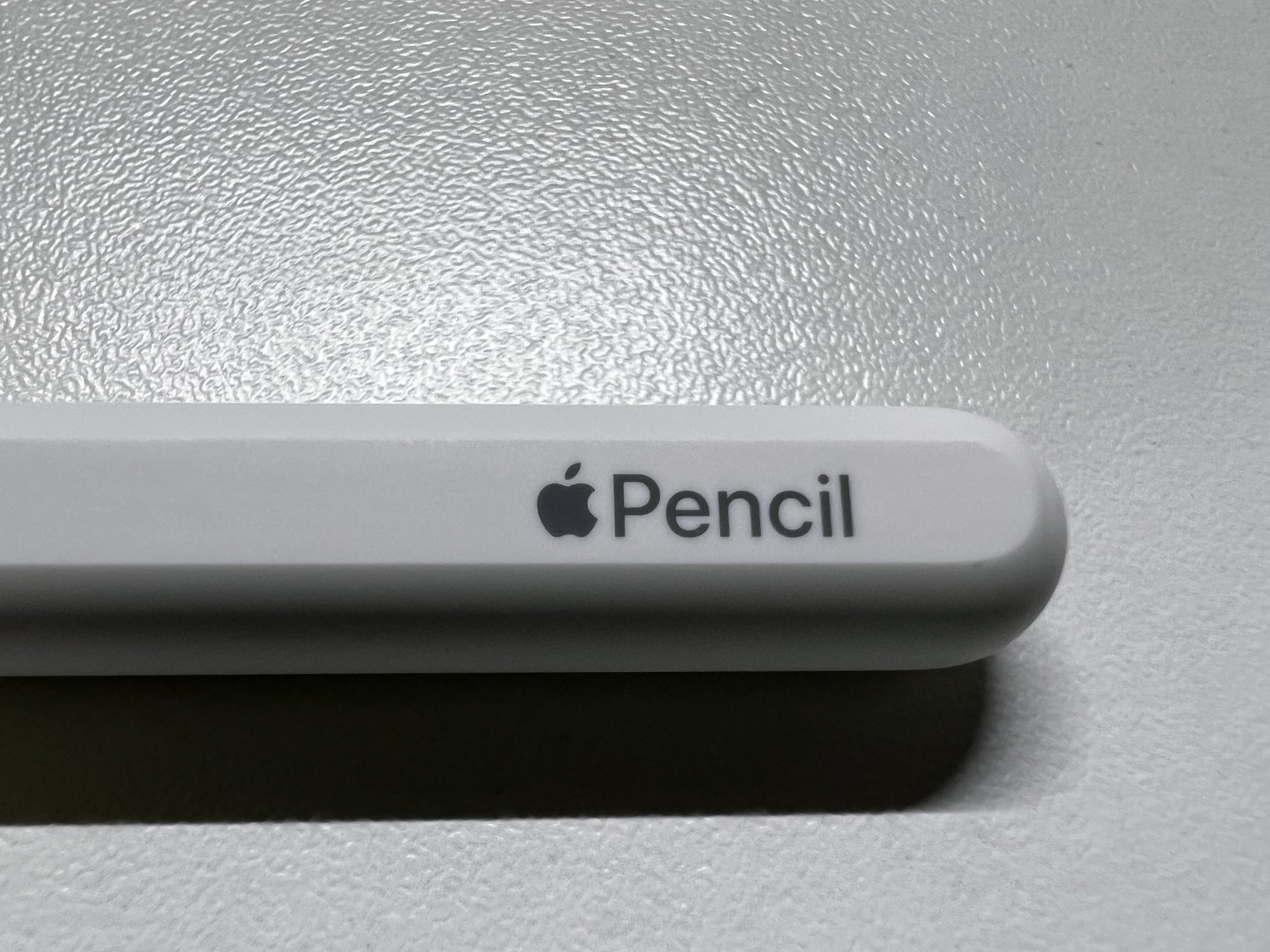

Fake on top (embossed, wrong font, leaf touching apple on logo, big gap between body and end cap, rough casting on end cap)
Genuine on bottom

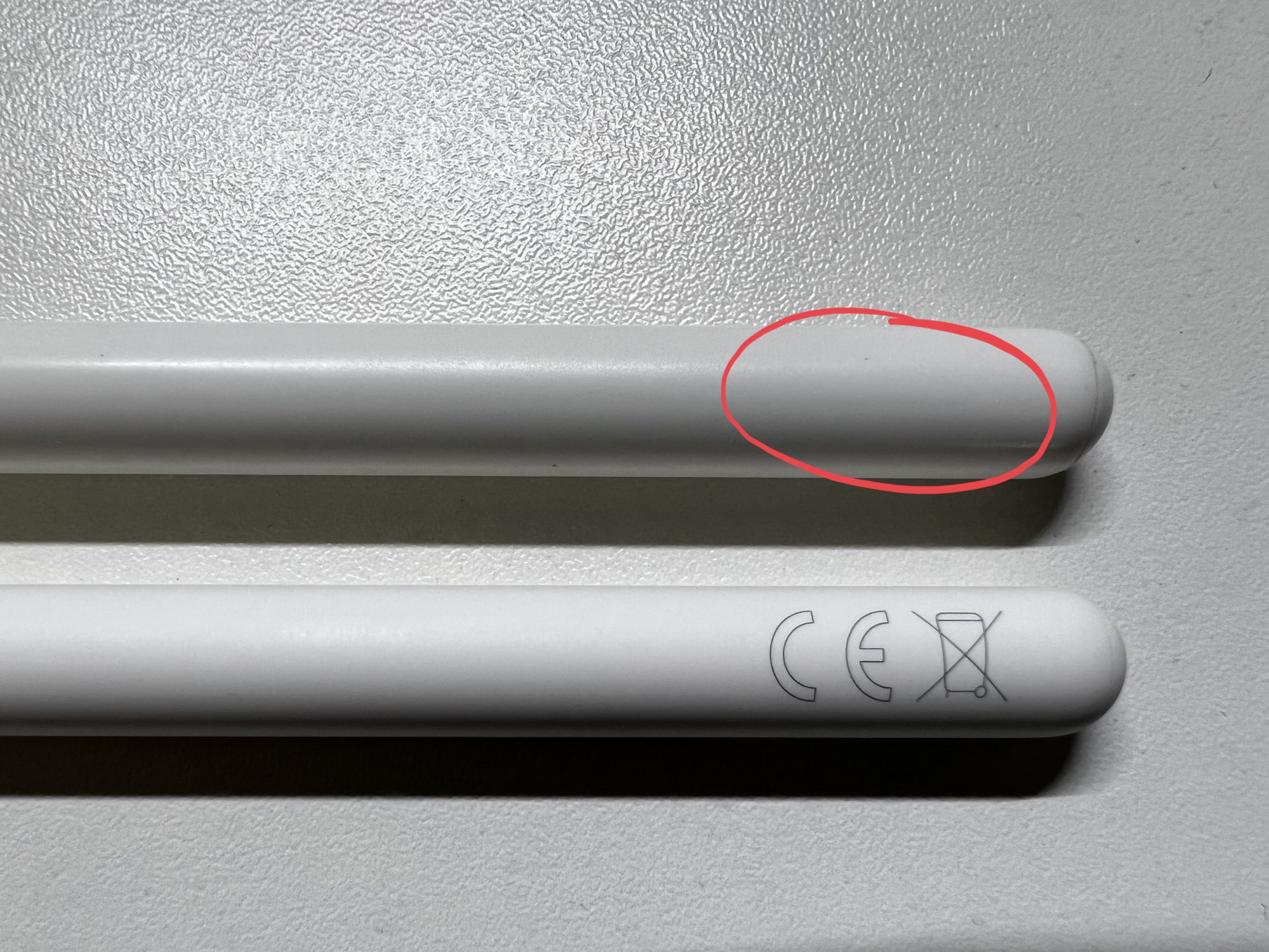

Fake on top (missing standard printing - for European Countries anyway!)
Genuine on bottom

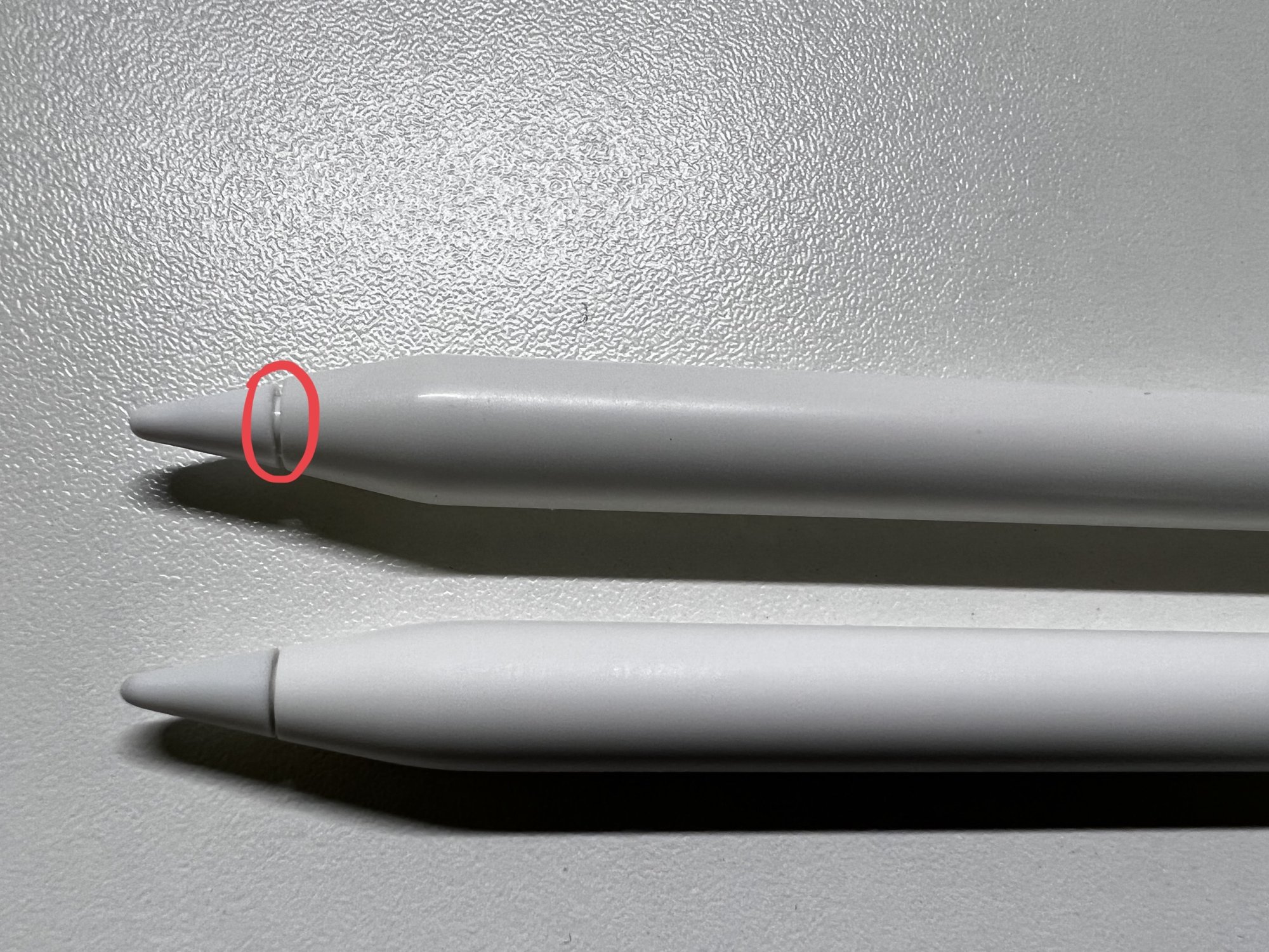

Fake on top (bigger gap between tip and body)
Genuine on bottom
Fake: apple logo has leaf touching,wrong font, embossed, big gap between font and end cap, gap between body and end cap, casting mark on end cap.

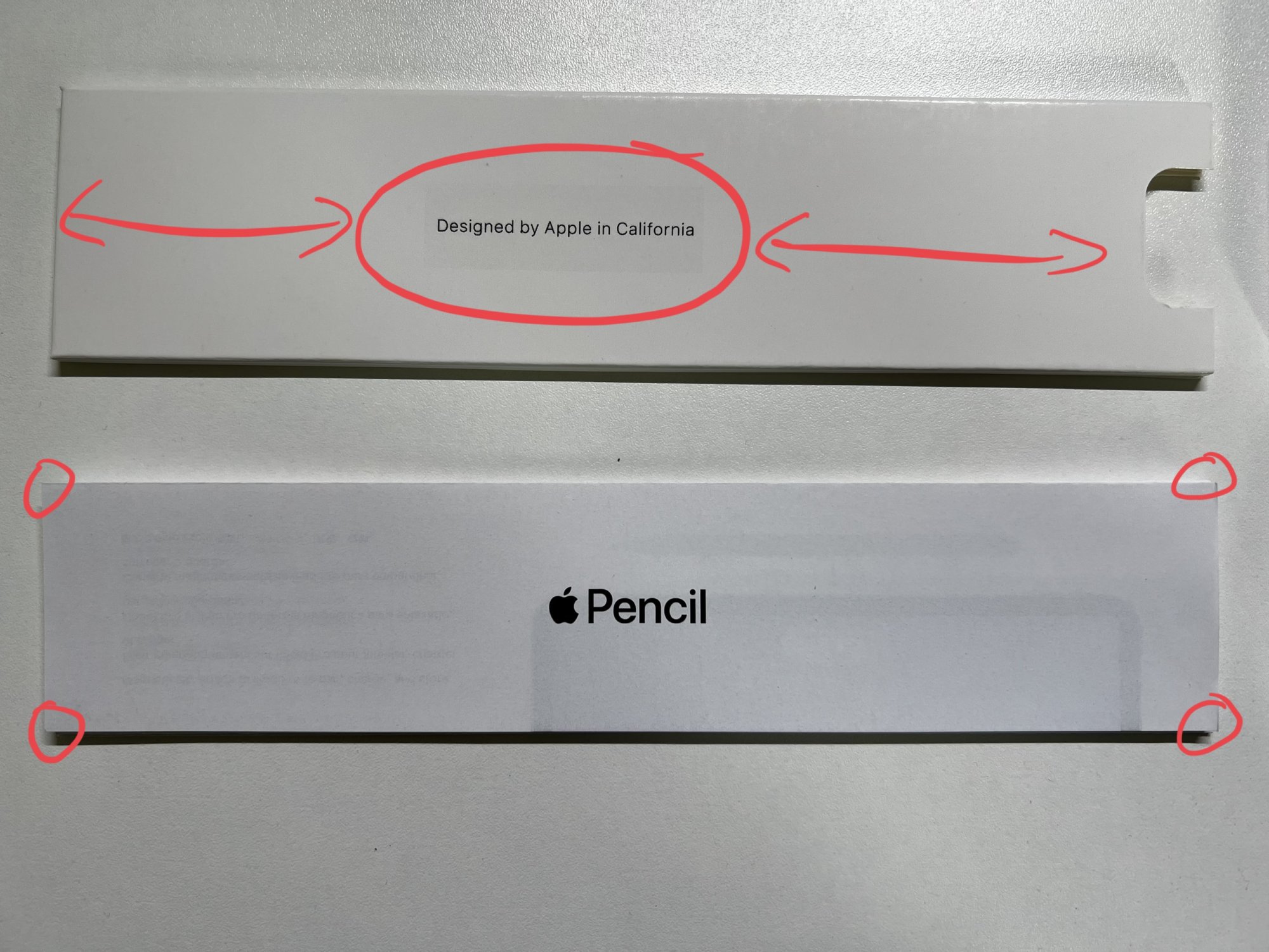

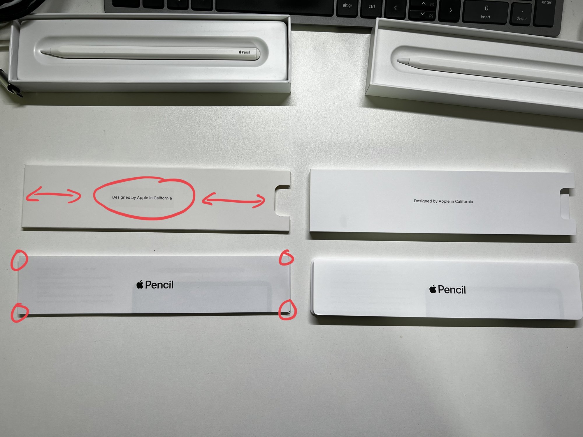

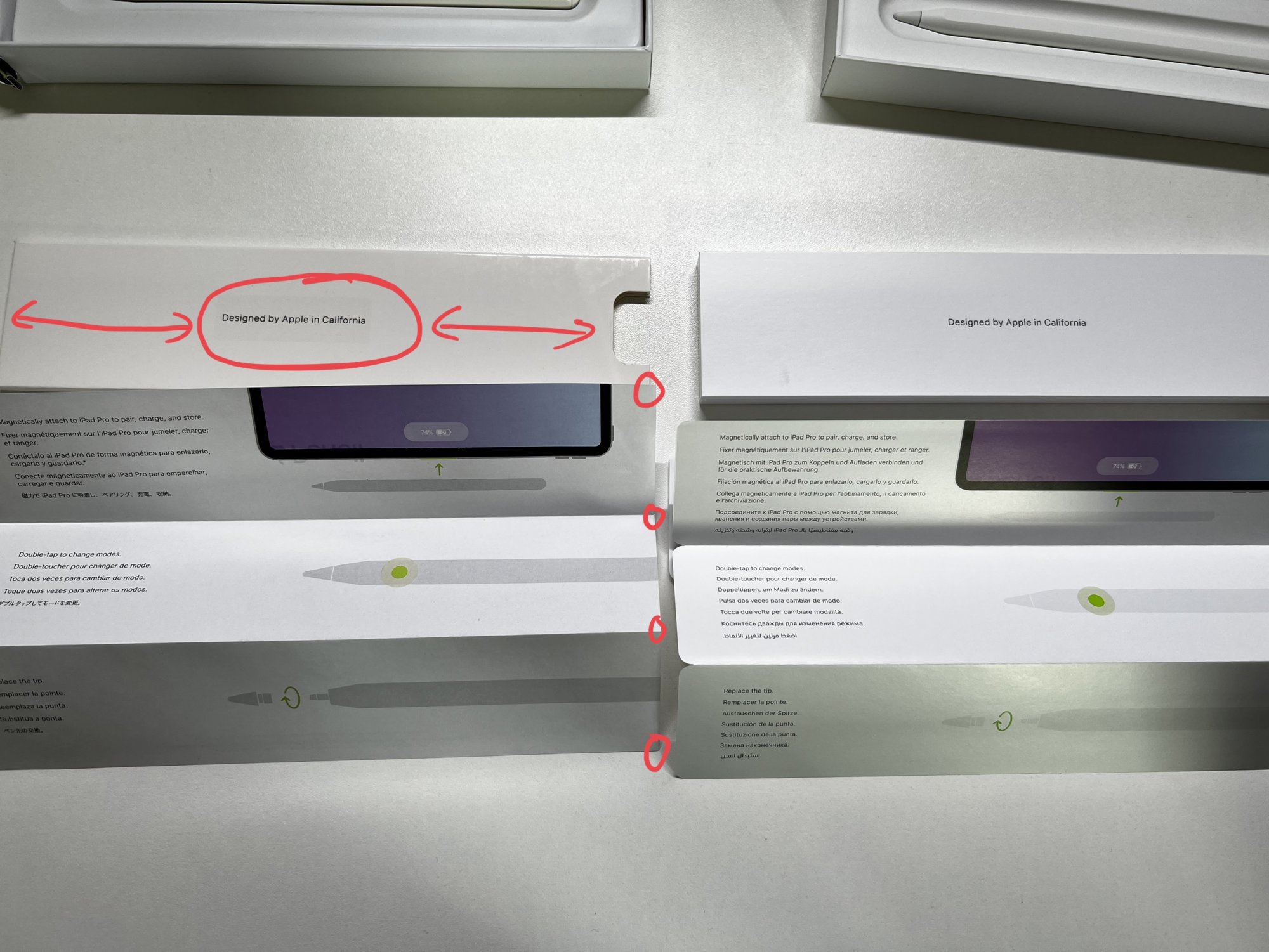

Fake on left: documentation has square corners:
Fake: documentation has square corners instead of rounded, printing isn't central on the cover

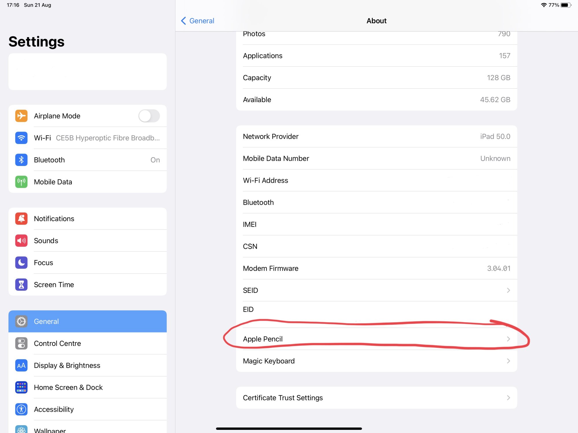

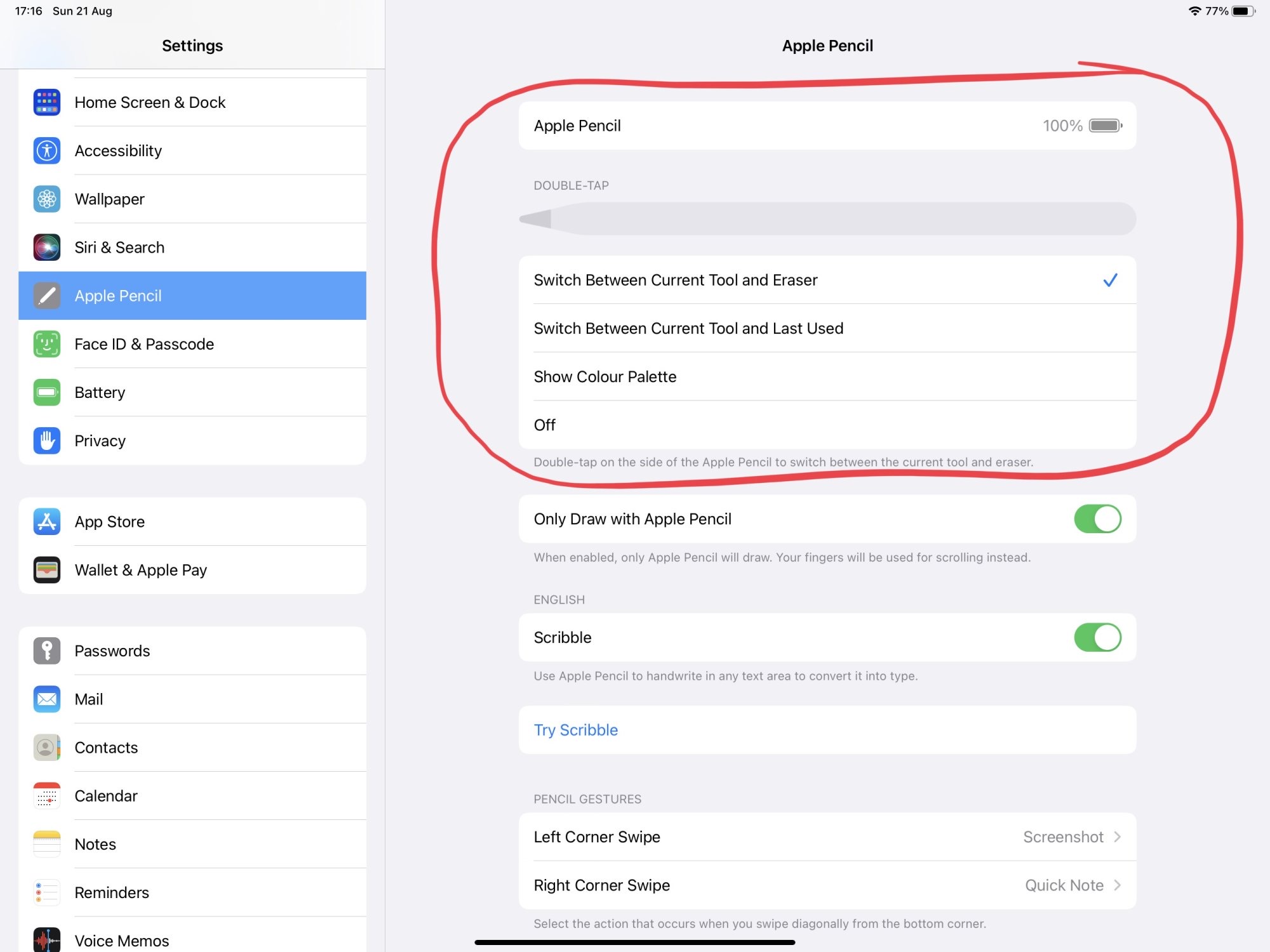

Genuine Menu: when the fake was attached this option wasn't available - it was missing
Genuine menu: this whole section was missing when connected to the fake Apple Pencil 2
Whoa. Regarding the difference in the Settings screen. Sometimes you need to pull off/re-attach the pencil to get the Battery and Double-tap options to show up.
Reactions: cerberus1846
yep I had a proper play/test with the fake one and it wasn't enabling those options or the 'Welcome to Apple Pencil' intro/demo that you normally get the first time you pair it... however, it WAS recognises as an 'Apple Pencil' but the iPad, you got the spinning animation when you connected it and it also worked in the battery widget (i.e. showed the pencil icon and the battery charge!)..

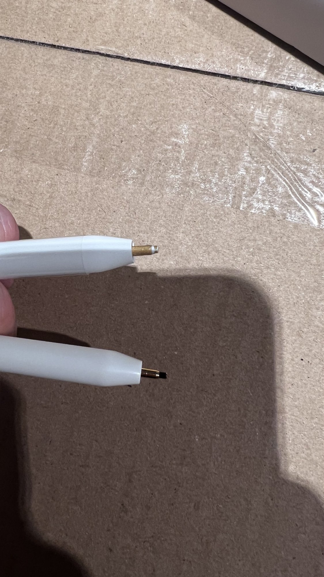

I bought an Apple Pencil 2 through eBay, normal price seller had good reviews but I have same issues as you it shows the animation and cant link it. Upon further inspection comparing it to a genuine one there are differences, I am curious what did yours look like without the tip of the pencil on? The electronics in mine look different.
I got the Apple Pencil animation when I connected it but didnt get the prompt to pair it unless I went into the bluetooth settings and pair it. When its paired it doesnt do anything besides showing the battery status and that its paired. I cant write with it in any app or try the scibble test in the Apple Pencil menu (all the other options are also missing in this menu)
Genuine Apple Pencil 2 on top
I assume the fake on the bottom.

Yep it looked exactly the same (though I explained this in my original post -eeek!.) the fake ones have a black tip and originals have white… pressure sensitivity also doesn’t work on the fakes.. they wouldn’t have had a plastic sleeve on the pen and the documentation is way off per my images..
