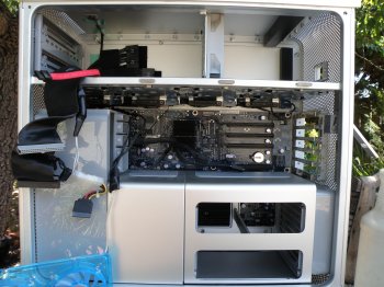

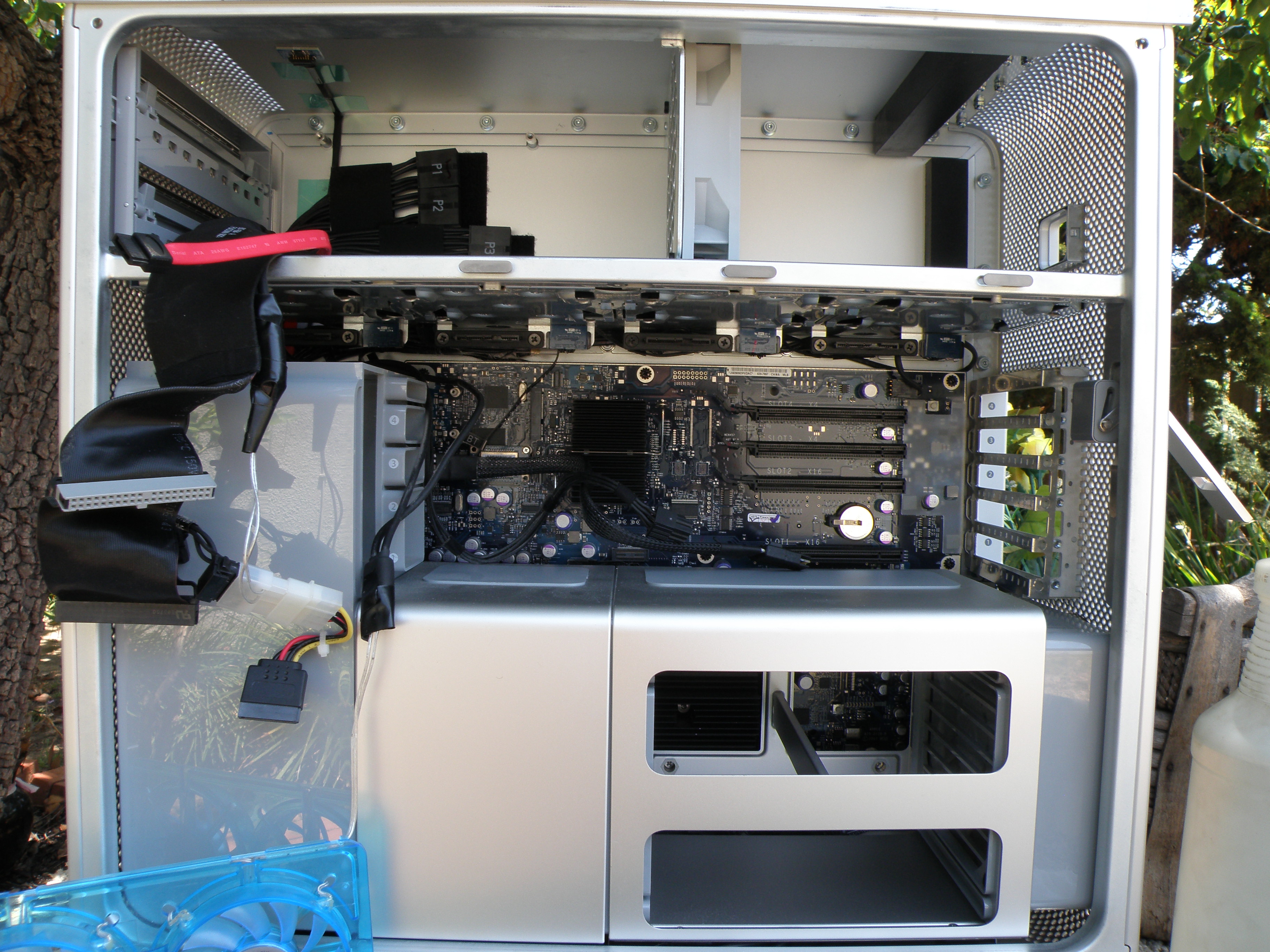

This is performed at least 1x a year which includes removing the PS and giving it a separate blast!
