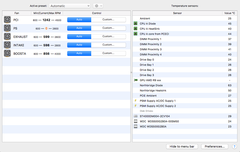

I installed Mac Fan Control 1.5.11 and it's showing a zero value for the PS fan RPMs and yet it seems like it is going at full speed judging by the noise. (screenshot attached) I can not increase or decrease or control the fan at all with the App. I can control all the other fans however.

Airout is mainly for the fan in the PCI bay, so it wouldn‘t make a difference for the PSU fan anyway (although they are in some way intertwined).
Judging by the PSU temps and your description, I suspect the fan doesn‘t report its tacho signal to the SMC and therefore your Mac rises the voltage of the fan to the maximum.
Other than a SMC reset and joggling the fan connector (on the motherboard upper left side) only a fan swap comes to my mind.

As mentioned by @arw the fan tacho reading is missing, so the SMC increases voltage to the max (12V).
I'd clean and reseat the fan plug ; the fan connector is on the upper left corner of the LogicBoard.
The fan cable is routed behind the LogicBoard.
If this doesnt solve the issue and/or you want to replace the PSU fan (for a OEM Delta or e.g. a Noctua), you can leave the old fan cable behind the LogicBoard and route the new cable through the optical bay .
This way you dont have to remove the LogicBoard and lots of other parts.
The link ( post#2 ) provides lots of info about how to replace the fans and mentions different fans that are tested and confirmed as a replacement fan.
Btw: MFC shows a R9 as GPU (not RX580)...

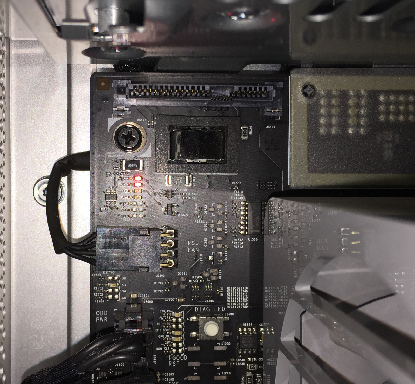

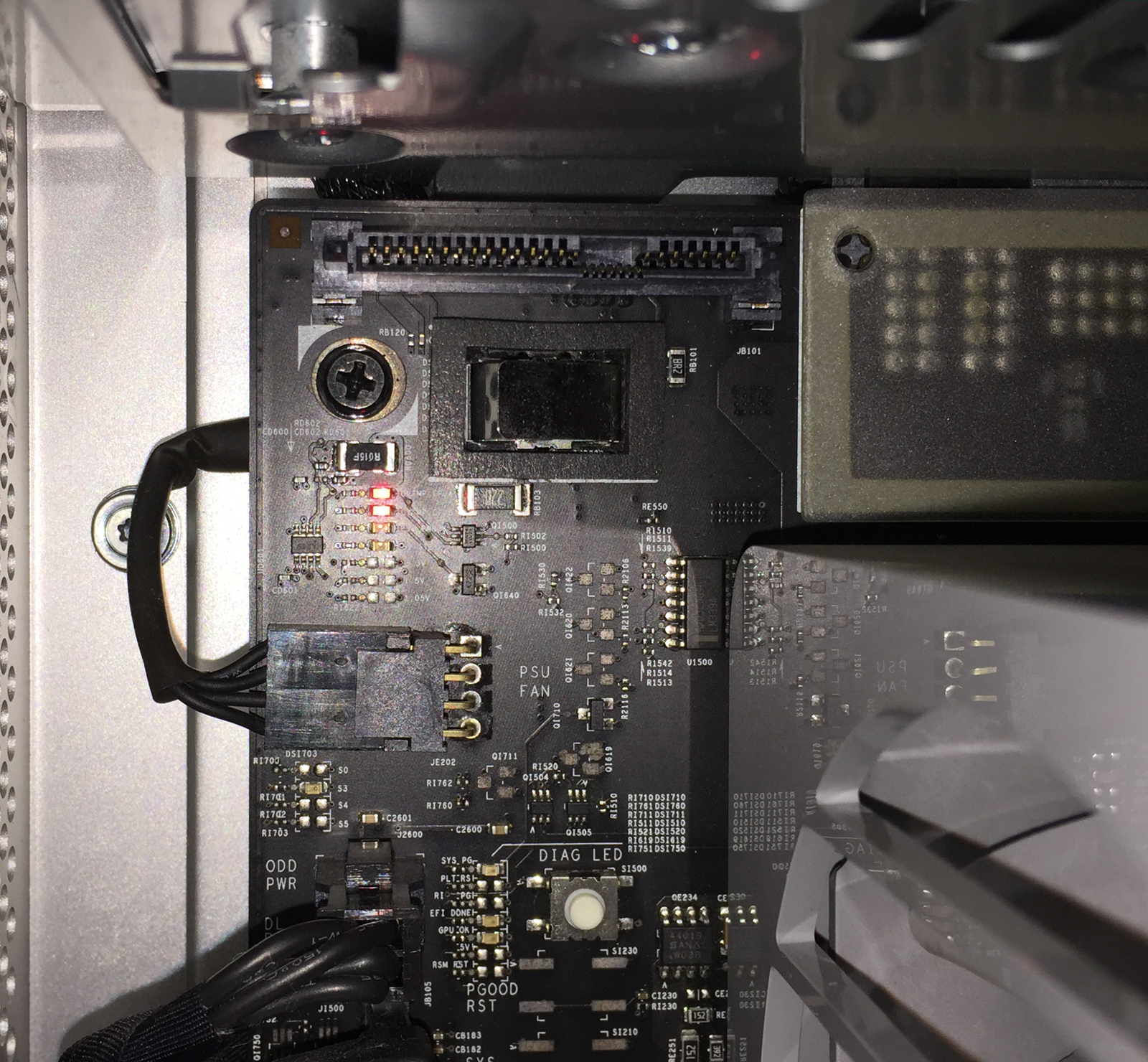

The one labled "PSU FAN". Upper left of the motherboard.
But as you say "fans" and "during boot" it sounds like a different problem.
