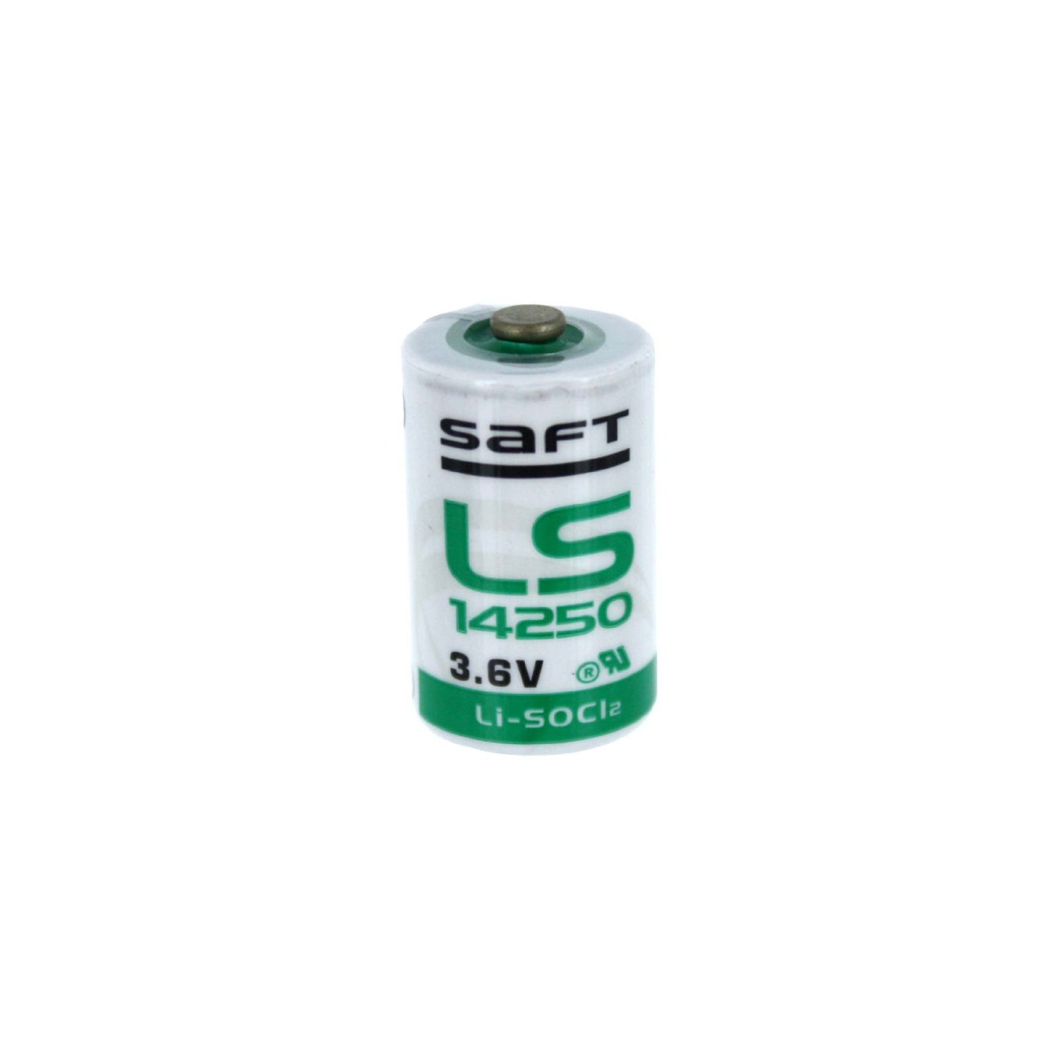

This is what you need (+ PMU reset):
whats the name of it and where can I get it? is it expensive??
Search for "er14250/s" on ebay or elsewhere. Here in Germany results are listed for between 3 and 10 Euro, old stock, but still orginally packed.
Dying battery can cause all kind of havoc on startup, if it's missing /100% dead the PMac should go back to defaults (and boot o.k. if you have a standard setup). If it has just slighly low voltage info in the NVRam might get corrupted to the point of a non booting Mac.
...or just "3.6 V Lithium 1/2 AA battery".
OP: Open up your QS and you'll see it on logic board. Most likely it will be violet-black-green (Tadiran). Any meeting these specs (not necesarilly colors 😉) will do.
Did I mention that when I do cold boot on the computer the date changes to 1969? Hopefully resetting the PMU will fix it all!!!
Just to expand on what the others said, If it's not keeping the date anymore that just means the battery is dead. It's also on the logic board close to the PMU reset button. Be careful taking it out so you don't damage the connectors it fits into. And don't use a butter knife to pry it out! If you need to use something and don't have a spudger or computer specific tool, you could use a sturdy plastic knife, maybe even a toothpick might help pry it up enough to pull out. Here in the U.S. they cost around $10, just for reference, but you won't find them in a regular store, have to look online or in a specialized battery shop. If you go to a store take the old one with you to compare.
