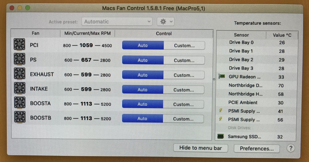

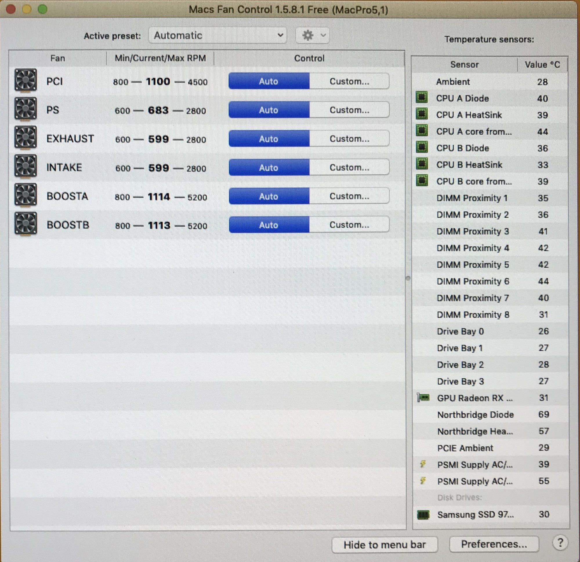

Hello,
I just noticed that my PSU temperatures are 41 C and 56 C. These are after a couple of hours on idle. They seem rather high, don't they? Or are these temperatures normal? Specs are: Mac Pro 2009 4.1->5.1, dual X5675, RX580, 970 EVO NVMe. No other disks at the moment.

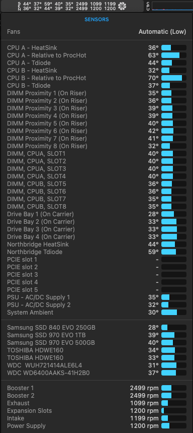

I would say yes, they seem on the high side based on my temps. When I have ambient temp reading at about 30C, the highest PSU temps I get are around 40C, usually with about 1-3C difference between PSU sensors. Others should share their temps and thoughts, I am not sure if you have a problem or not, even if they seem above my average temps....
Thank you all for your reply! I really appreciate it.
Stex, your setup is quite similar to mine but your PSU temps are lower. Do you use some custom fan controls by MFC etc.?

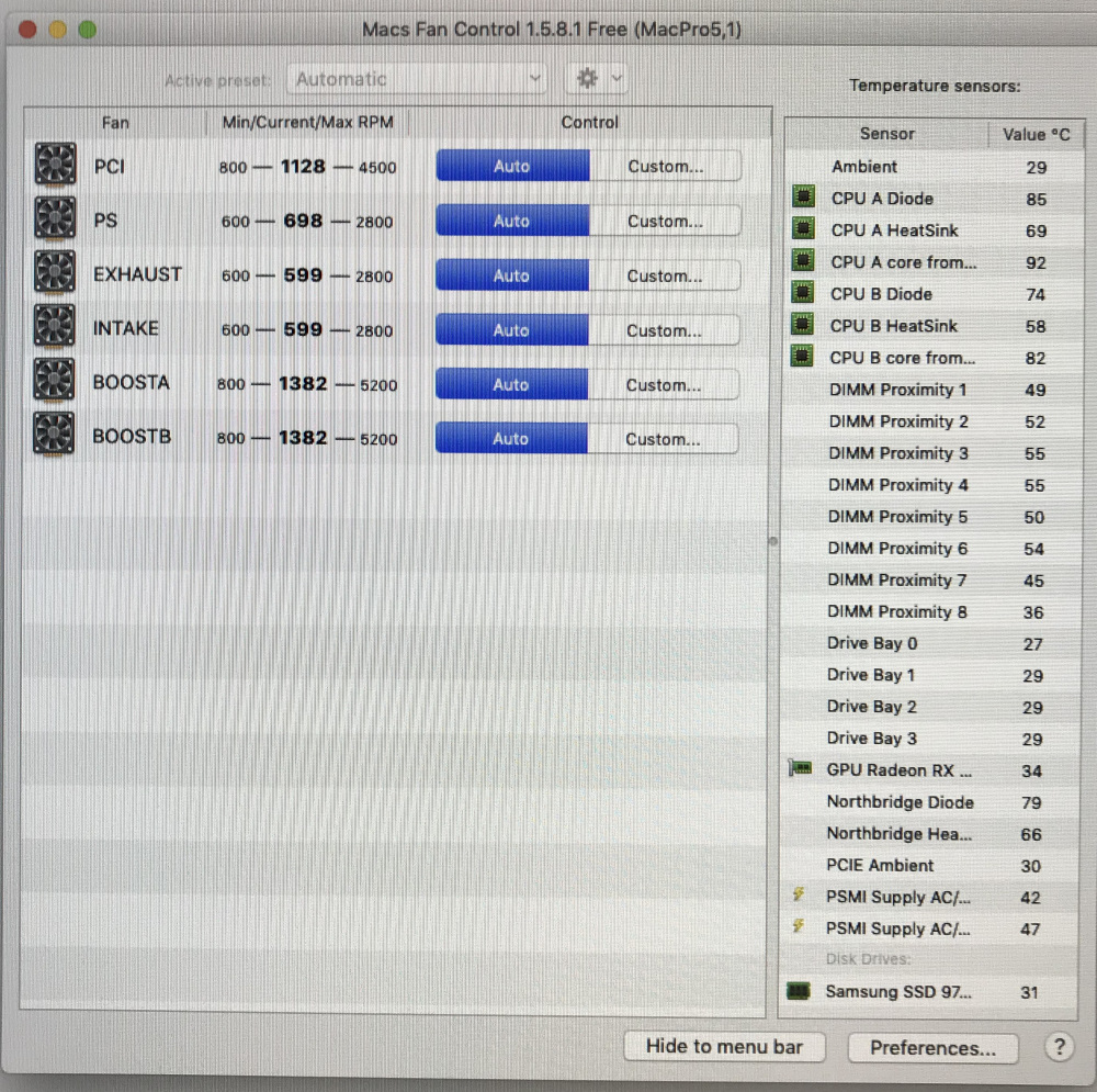

When idling, the temps are:

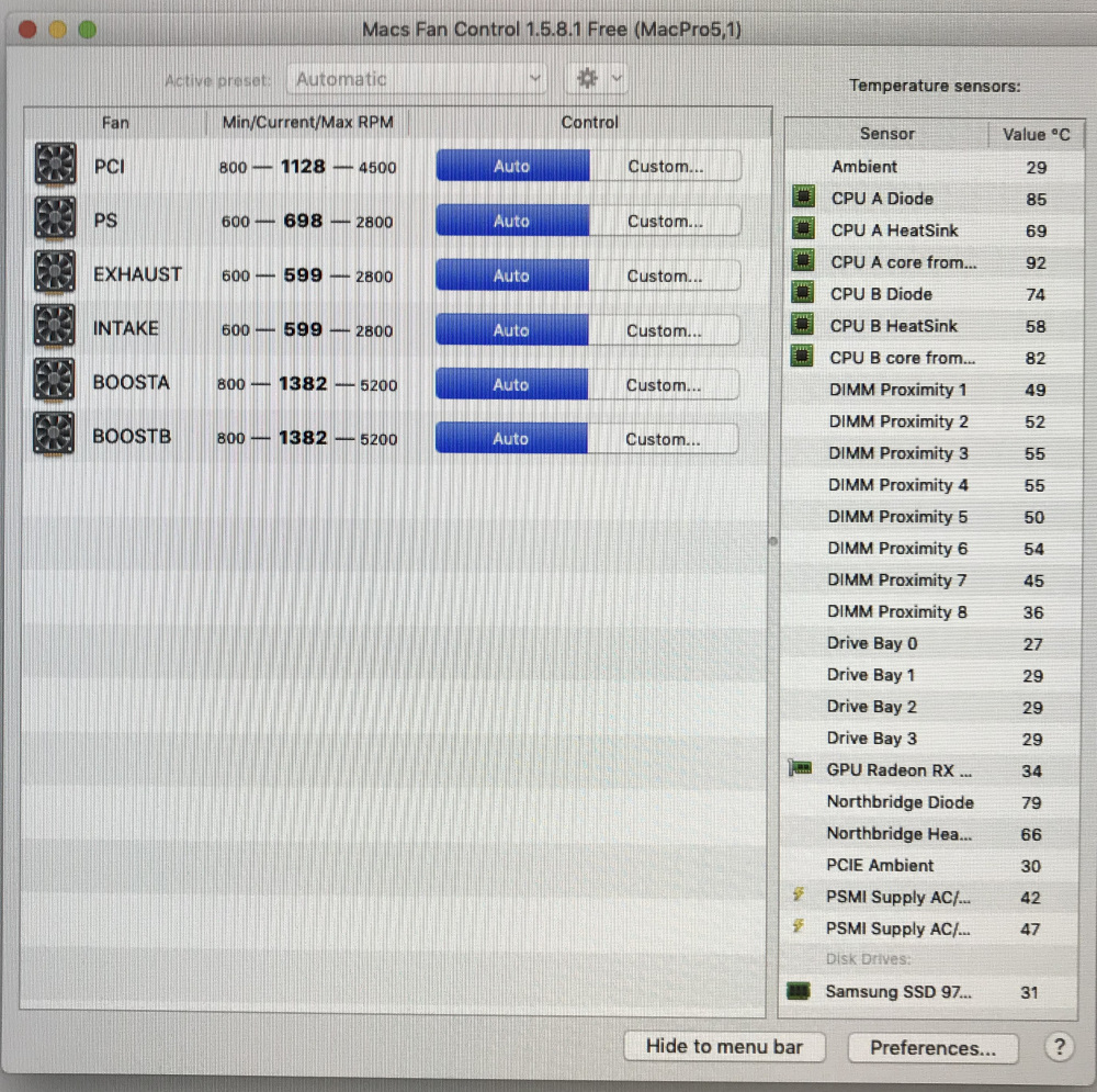

After running "yes > /dev/null &" (times 12) in Terminal for 10 min, the temps were:
Notice that the PSMI Supply 2 temp is 8 degrees of C lower that at idle even though the PS fan speed is the same.

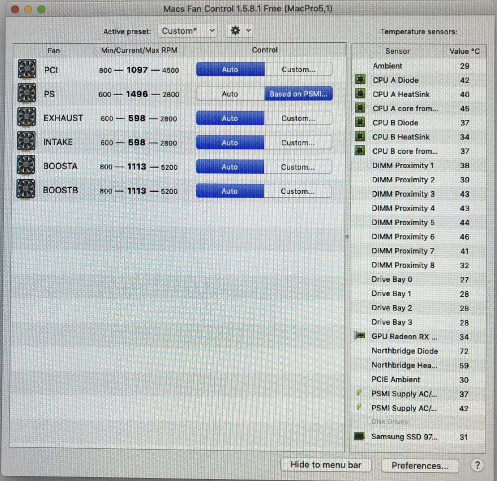

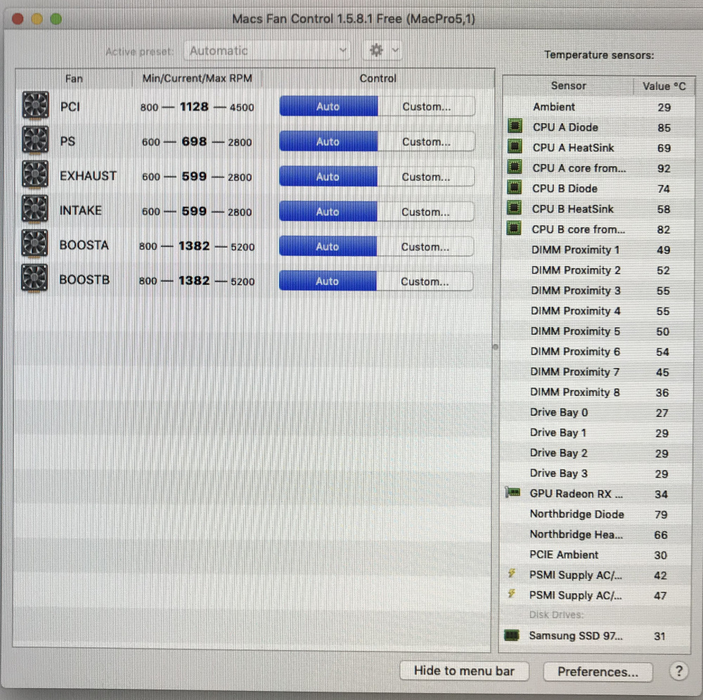

If I use the settings proposed by KeesMacPro, I will end up with these temps and fan speeds:
The PSMI Supply 2 temp is 13 degrees of C lower than before but the PS fan speed and the noise are a lot higher.

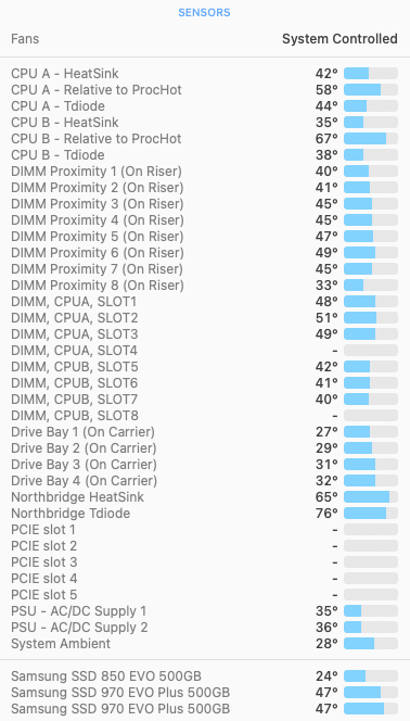

@Tommi14 -Yes we have similar setups. You probably found some of my old posts in those threads were I got great suggestions from @KeesMacPro and other helpful members.
At this time I am using iStat Menus for fan control and general monitoring. I tend to keep the PS fan rpm quite high to keep the PS temps below 35C. My PS fan is always at a minimum 1050rpm, and lately with warmer weather I push it to 1150rpm. But yes, that fan above 1000rpm is very noisy. In fact, today I finally bought a new Noctua fan to replace the PS fan - a suggested upgrade if you want quieter cMP fans in general.
Regardless of my ambient temps and fan settings, I have never had such wide difference between the two PS sensor readings. Your PS temp difference does not look normal to me. At most, I have 1-3C difference (as previously stated). Your last screenshot has better PS temps for sure, but 1500rpm is very high. I never had to push the PS fan that high even with 30C ambient reading.
Maybe test the higher rpm fan setting for a few days and keep an eye on the numbers to see if there any changes based on use/internal temps etc. I am not sure, maybe others can let us know if they have (or have had) wide difference between PS readings like you...

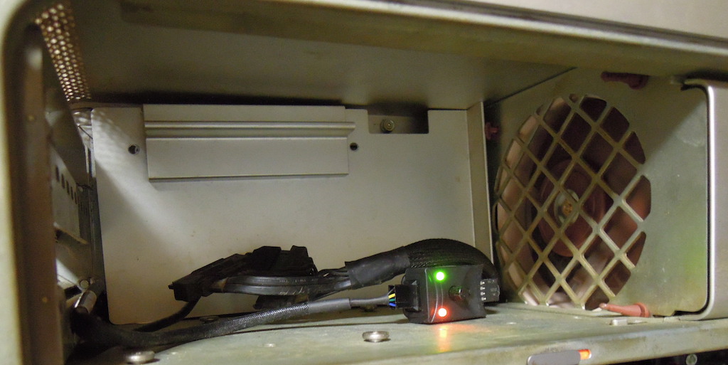

The Delta PSU runs cooler, also much lower temperature between sensor 1 and 2 (than the AcBel PSU)
I replaced my 4,1>5,1 cMP's PSU fan with a Noctua fan and their fan speed controller.
Total temp control + fan silence.

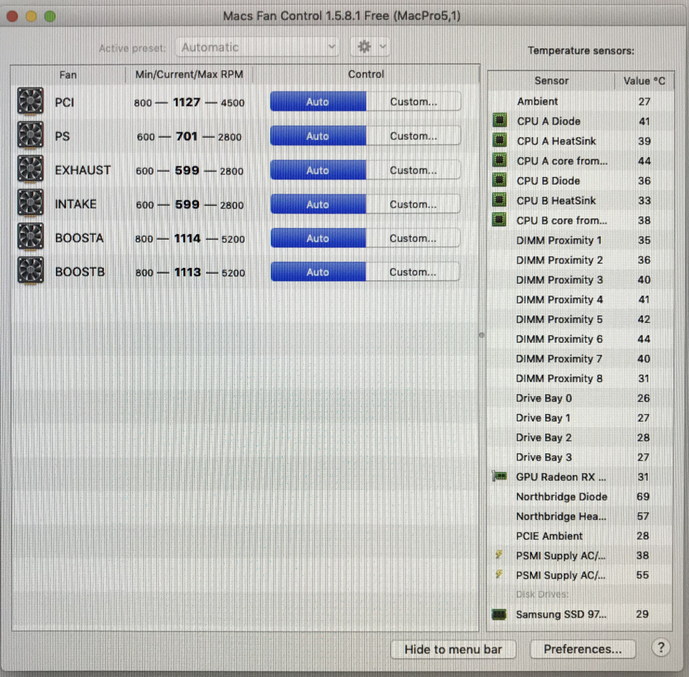

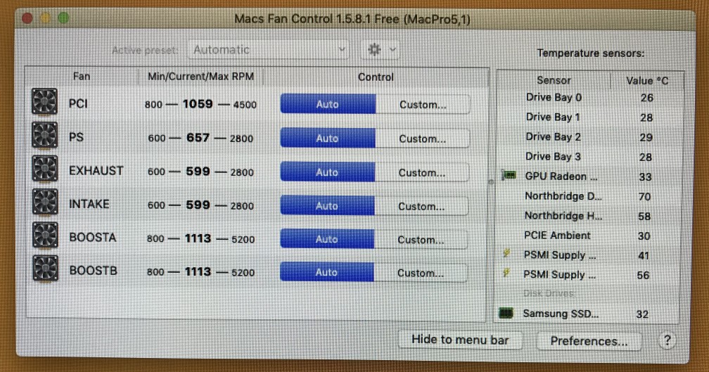

I finally got the time to take the PSU out. It was easier than I thought. The brand of the PSU was AcBel. The PSU did not look particularly dusty, but I blew it thoroughly with CompuCleaner Xpert anyway.
And the result: no effect on the PSU temp readings. Below are the idle temp readings after the cleaning:
So, the PSU temp readings are still high.

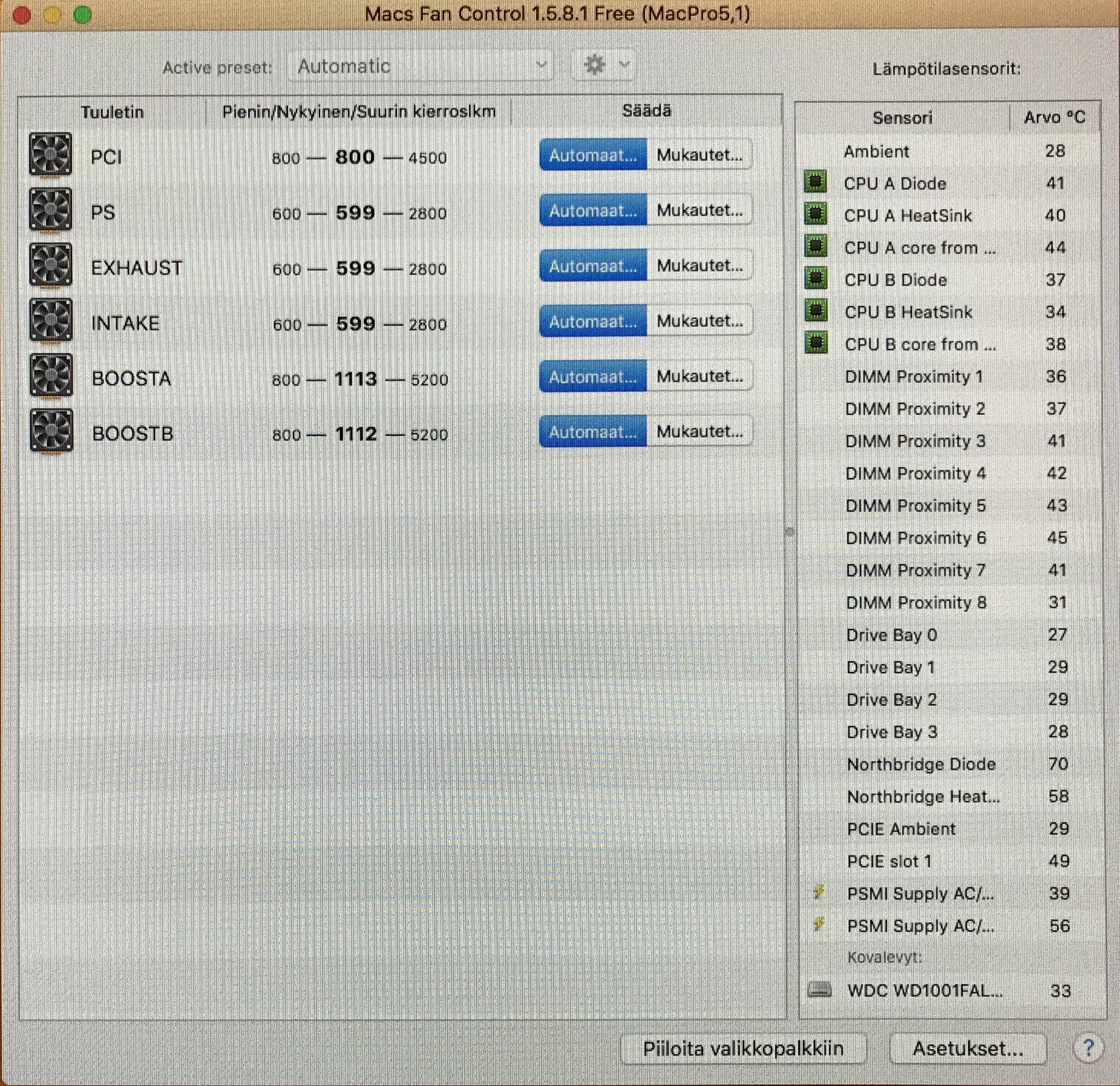

I also tried what will happen if I replace RX 580 with GT 120: no effect either. Below are the idle temp readings with GT 120:
The PSU temp readings are the same with RX 580 and GT 120, but the PCI and PS fan speeds are slightly higher with RX 580.
So, any idea what could be deduced from this? At least it seems that the high PSU temp readings are not related to the GPU.
As a side note: with GT 120 there was a temp reading for "PCIE slot 1", which I think is related to GT 120 and it was around 50 C. This also is quite high, isn't it?
The PCI and PS fan , when controlled by the SMC (=auto) , seem to respond a lot to the PCI power draw and not only the PSU and/ or PCI Temp readings. The RX580 draws more power than a GT120 .
Yes, the GT120 shows up as "PCIE slot x".
The GT120 is a very basic GPU , about 1 decade old , and easy to heat up with graphic demands normal for today's standard.
When I install a GT120 for e.g. testing I always read Temps of 50C (at idle) and upwards.
So, besides the quite poor performance, the GT120 runs hot in general...
I have made some progress in lowering the PSU temps in my Mac Pro.
Firstly, I set in Macs Fan Control for PS a sensor-based value: PSMI Supply AC/DC Supply 2, min 35 C, max 75 C.
Secondly, I put hard drives in bays 3 and 4.
These two changes lowered the PSU Supply 2 temp from 56 C to 40 C at idle.
It seems that for some reason having hard drives in bays 3 and 4 has significant affect to the PSU Supply 2 temp. The temp is a lot higher if the bays are empty.
