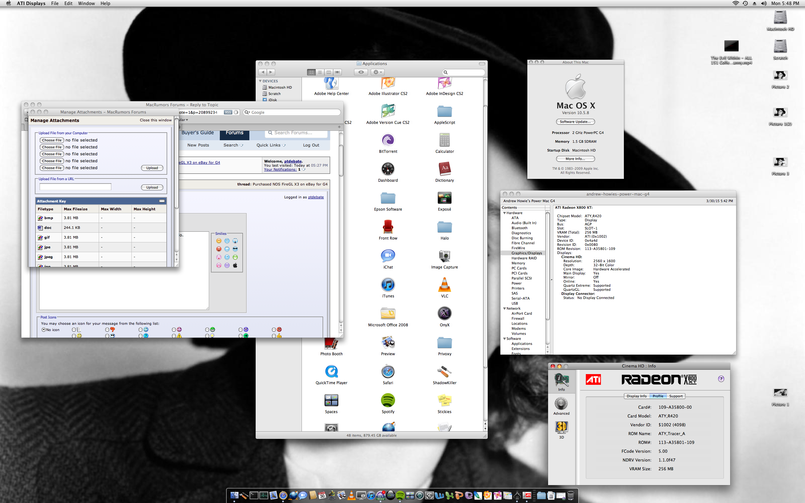

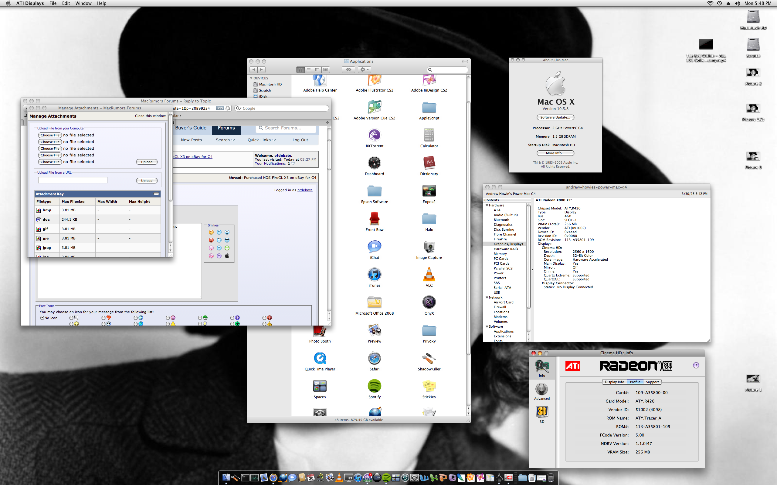

It worked!
Check it out, guys! A FireGL X3 running in my humble Digital Audio.

Now I'm really itching to try it in my Digital Audio-I don't think I've actually done that.
I've done a lot of testing in one of my DAs, as I don't really do any serious work on it and it's easy for me to get to and work on. For most purposes I consider it "close enough" to a Quicksilver that what works(or doesn't work) on it is applicable to QSs.
That card is a good match for your 30" Cinema. I think both ports are dual link and it has enough "horsepower" to drive two of the if you really wanted to go crazy 🙂
