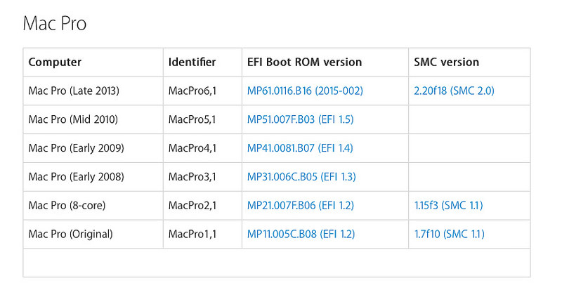

As BillyBobBongo stated above, the dual CPU boards between the 2009 and 2010 MacPros are not interchangeable. The SMC firmware between the two boards are different. There is a firmware upgrade (EFI Boot) to upgrade the MacPro 4,1 to a 5,1 but that firmware upgrade does not update the SMC firmware resident on these boards. It is not a direct way to do the firmware update to make a 4,1 MacPro into a 5,1 MacPro but there is a thread that tells you how you can do this.
Anyway... there is a more in-depth discussion regarding this somewhere in this forum so in short, the answer is no. Below is what EFI/SMC firmwares are available for the MacPro...
Mac Pro 4,1 SMC version is 1.39f5 whereas Mac Pro 5,1 SMC is version 1.39f11. As far as I know there is no mechanism in place to update the SMC firmware in Mac Pro 4,1.
Putting a 5,1 CPU board into a 4,1 will cause the case fans to run erratically due to SMC firmware mismatch between the CPU board and motherboard.
