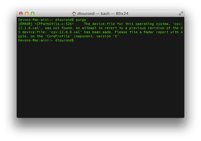

Just updated to 10.8.1 on my 2012 MBA. Someone had commented on OSXDaily that their purge command in terminal was now returning this error.
[ERROR] <CPPathUtils.c:526> The device-file for this operating system, 'osx-12.1.0.xml', was not found. An attempt to revert to a previous revision of the OS device-file: 'osx-12.0.0.xml' has been made. Please file a Radar report with Apple, on the 'CoreProfile' component, version 'X'.
I tested the command on my machine and it also returns this error. OS X 12.1.0? Anyone else having this issue?
I recently updated to 10.8.1 on my Mac Mini (mid-2011) and ever since I did that I get that error too. I think it still works though because every time I use that command I still see a gain in memory.

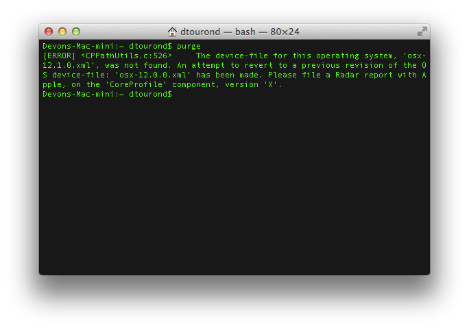

Error when trying to purge in Terminal
I haven't purged in a while but today I noticed this when I tried to purge and I have no idea what it means. I don't really know much about Terminal.

Here's the fix..
Create a symlink from osx-12.0.0.xml to osx-12.1.0.xml.
How to:
Open Terminal
Code:
cd /System/Library/PrivateFrameworks/CoreProfile.framework/Versions/A/Resources/Devices
sudo ln -s osx-12.0.0.xml osx-12.1.0.xml
Running ln as sudo mode will probably prompt for your password, type your normal login password.
After this, you may run purge in peace.

This is not necessary if you upgrade to 10.8.2.
