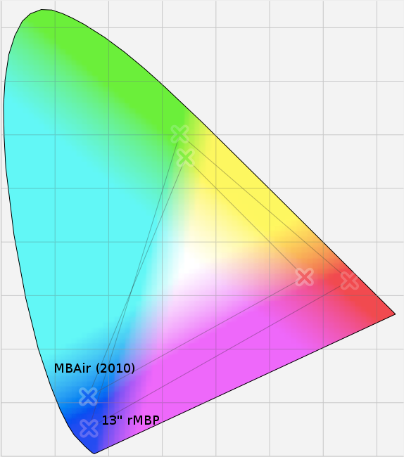

Ok, here are the profiles generated by the i1 software -- have not tried BasicColor 5 yet.
I also noticed that the built-in Color Sync utility does low-rent gamut charts, so I've included an overlay of my 2010 MBAir and the 13" rMBP. I don't know how to get it to plot the HD colorspace otherwise I'd have overlaid that too.
