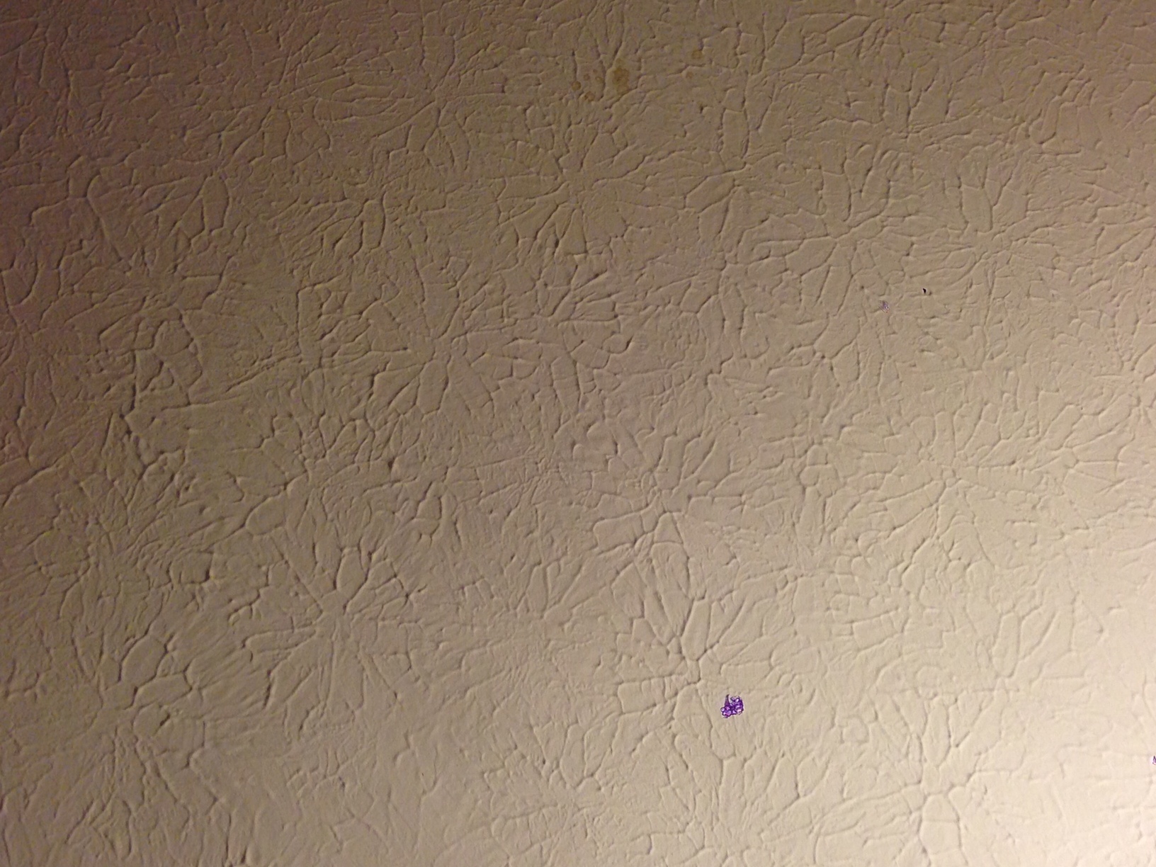

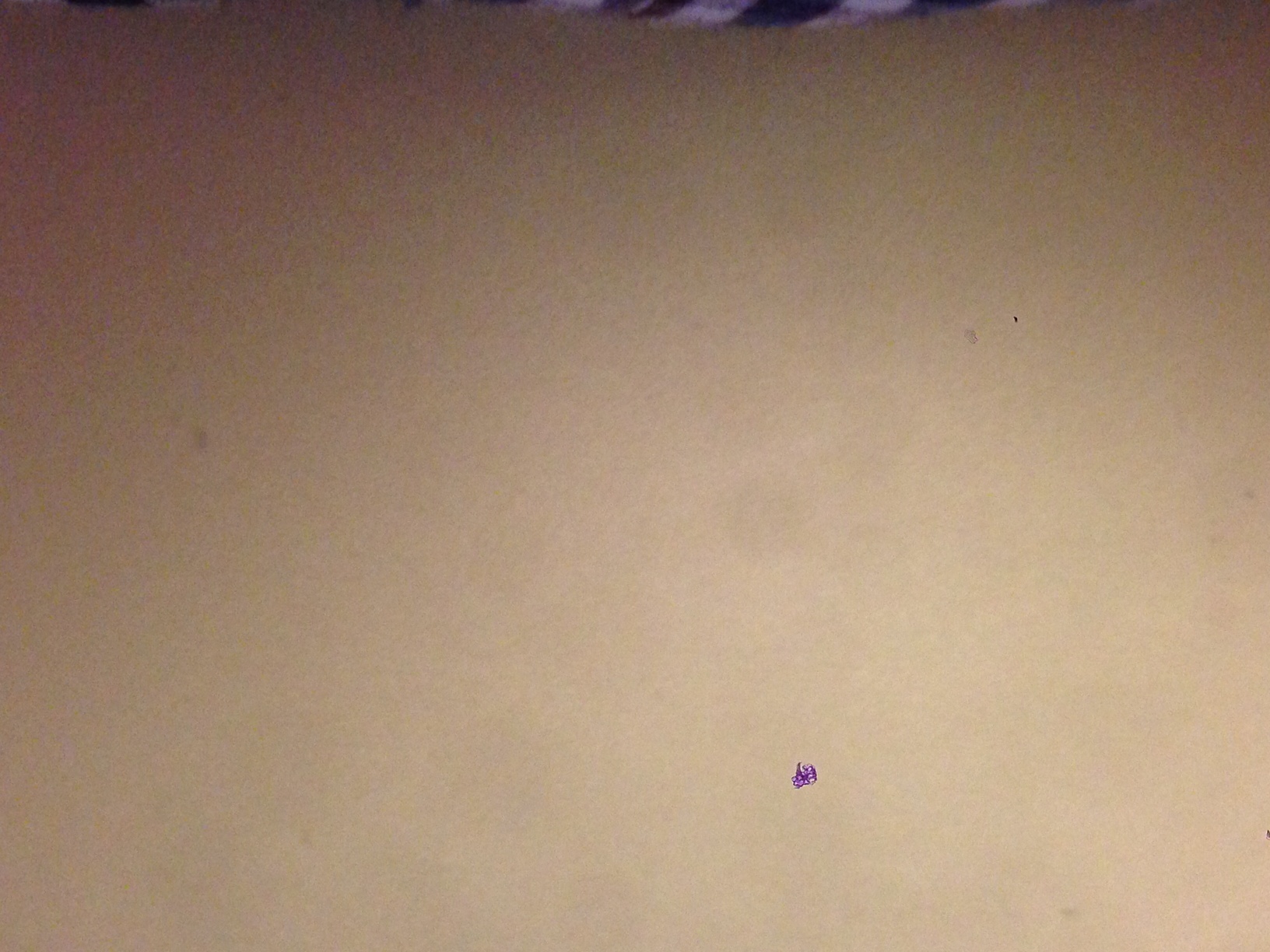

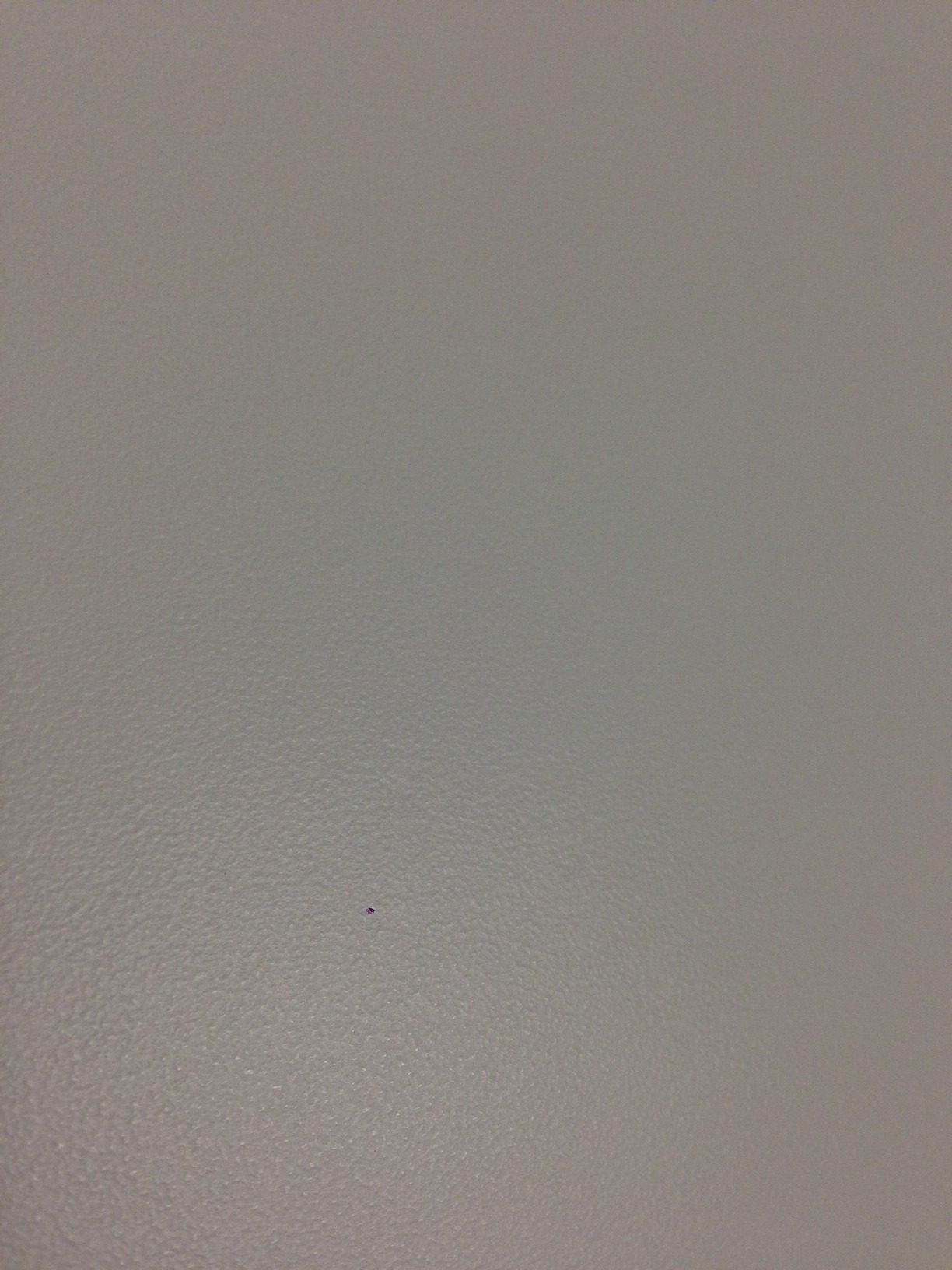

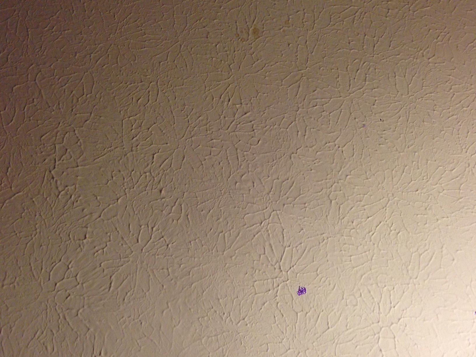

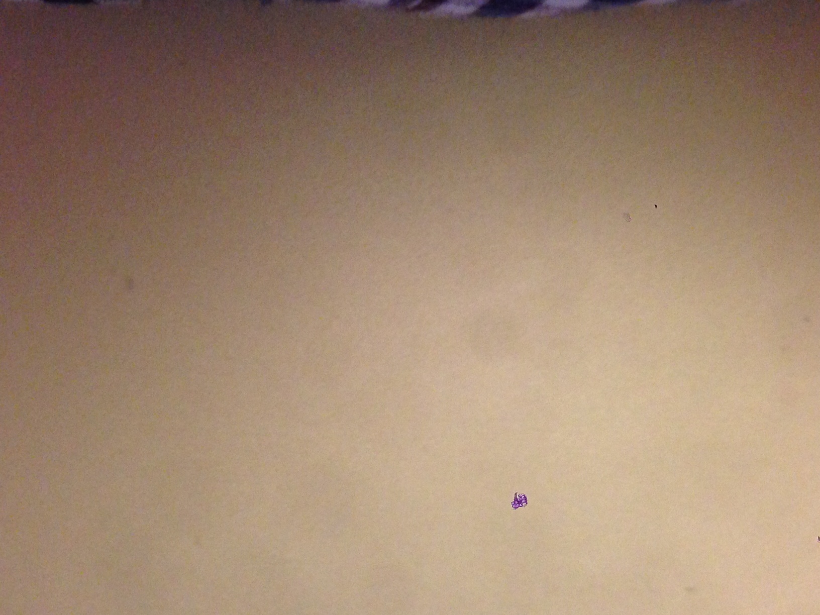

When using the rear camera on my iPhone 5, I'm seeing a purple dot no matter where I point the camera. It's not the purple haze reported a month or two ago, but just a solid purple dot. Is there something to do to clean the lens, or is a trip to my local Apple Store in order to swap out?
Images attached as reference. Top is the ceiling of the current room I'm in, and the bottom is of the trackpad on my MacBook

The blemish illustrated by the OP is due to a speck of dust or imperfection on or with the camera sensor. Replacement is the only solution. This is explained by the fact that the spec is sharply defined and in the same position on all photos. It is nothing to do with the lens - if it was it would be larger and ill-defined.
This problem is well known to photographers who own DSL cameras with detachable lenses. When changing lenses, dust can get into the camera and settle on the exposed sensor. The result is similar to the OP's example.

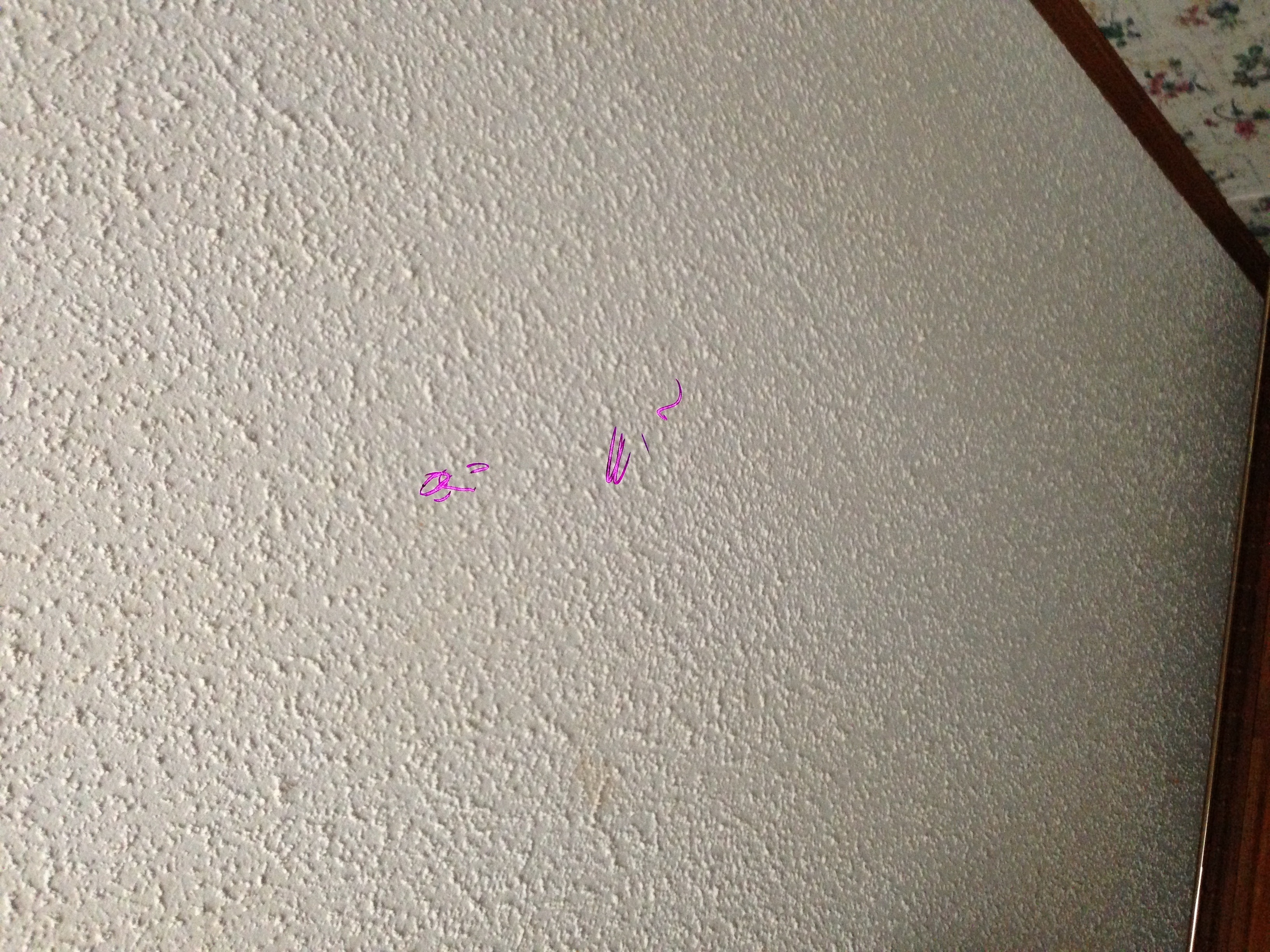

I just thought I would share that I'm having major problems with my camera!
This is insane!

Apparently this is a problem with the majority of iPhone 5's. I've already had one replaced and the purple specks are appearing on my newest one now, too. So I thought I'd share a temporary fix. There's an app called TouchRetouch that gets rid of blemishes. You can highlight the dots and virtually erase them. It's a pain that you have to do it in the first place but until I can get ANOTHER replacement it's been a big help for me. Good luck!
same problem here!! 🙁 I've just seen that all my pics taken in the last 2 months have 2 small squiggles .. really pissed 🙁
