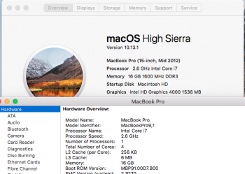

You may have a Late 2011, and not a 2012 version. The 2011 was dropped from that repair program at the end of 2016.
Quickest way to make sure about which one you have is to view the Model Identifier, which is in your System Information/Hardware Overview.
2011 is MacBookPro8,2
2012 is MacBookPro9,1

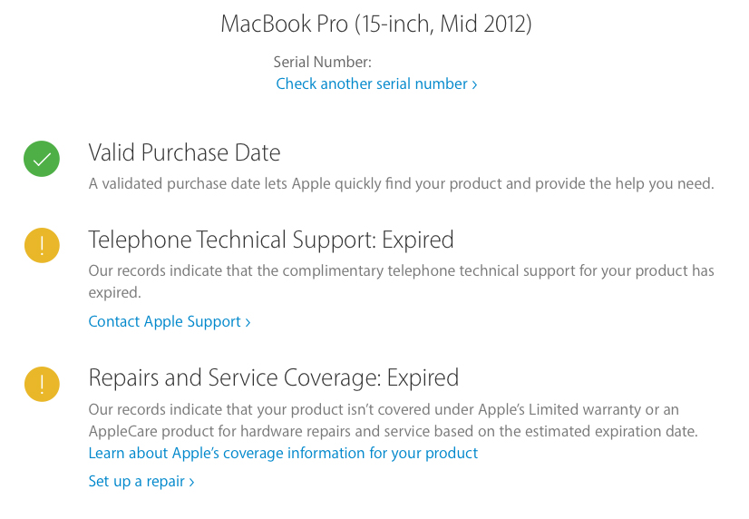

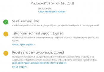

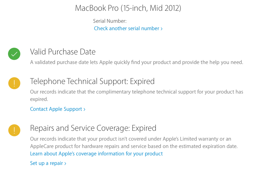

ok i had to check again my MBP, i have the 9,1. I follow your link to check the support coverage and had this:
That tool simply tells you that you are outside of the normal warranty coverage.
The program mentioned at the video issues support page MIGHT still apply to your MBPro.
Best way to discover for sure is to call AppleCare, and let them tell you at that time that you are no longer included in that video issues repair program.
