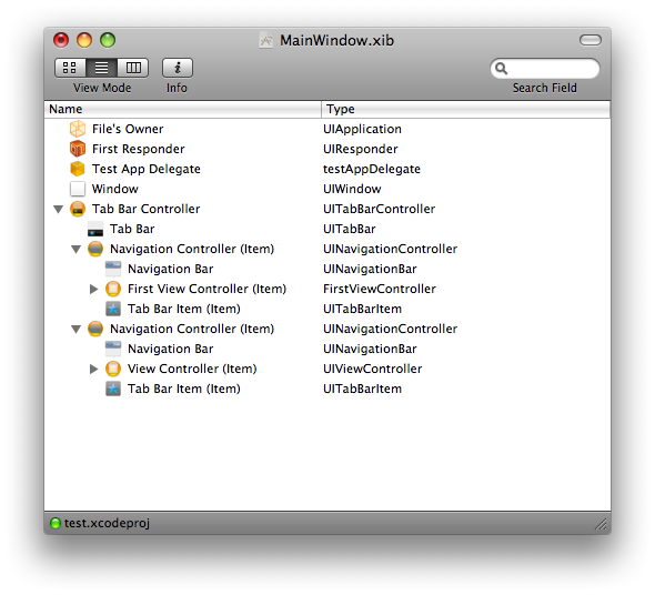

Hi Yoga,
The problem actually spawned from my xib files and actually the solution is quite simple. In my main window where I created a UITabViewController through Interface Builder, I had to create/drag a UINavigationController under the Tab Bar Controller for each tab I had. So the new hiearchy is as follows: Tab Bar Controller -> UINavigationController -> View Controller. So if you have 4 tabs for example, you'll have 4 of the above for each tab. And each move each view controller into its respective navigation controller. From there on you just need to associate and link things as you normally would.
Hope that helps.
I attached a picture as a sample. Pictures always helps me...hope it helps you!

Hi Yoga,
Hope that helps.
