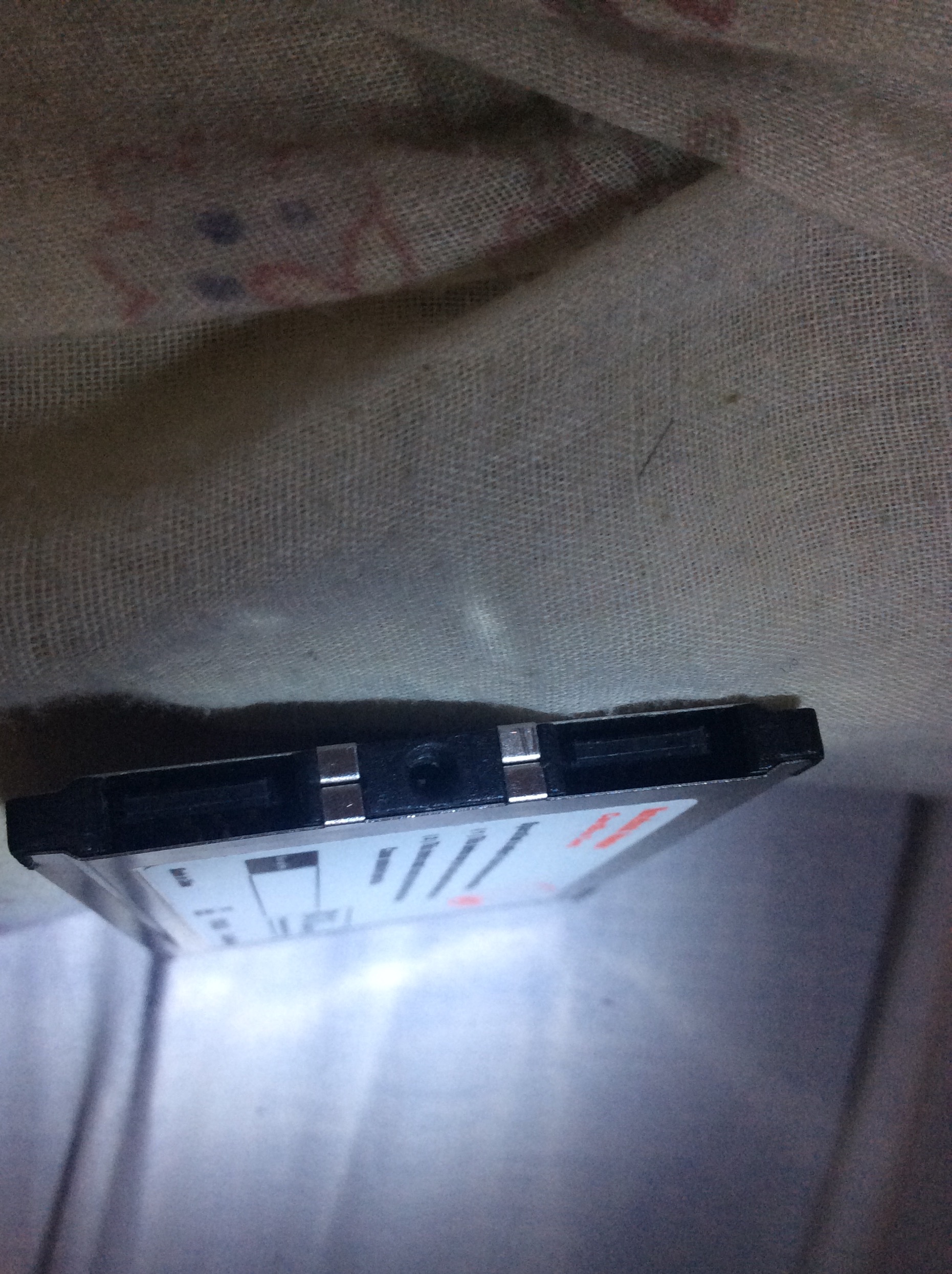

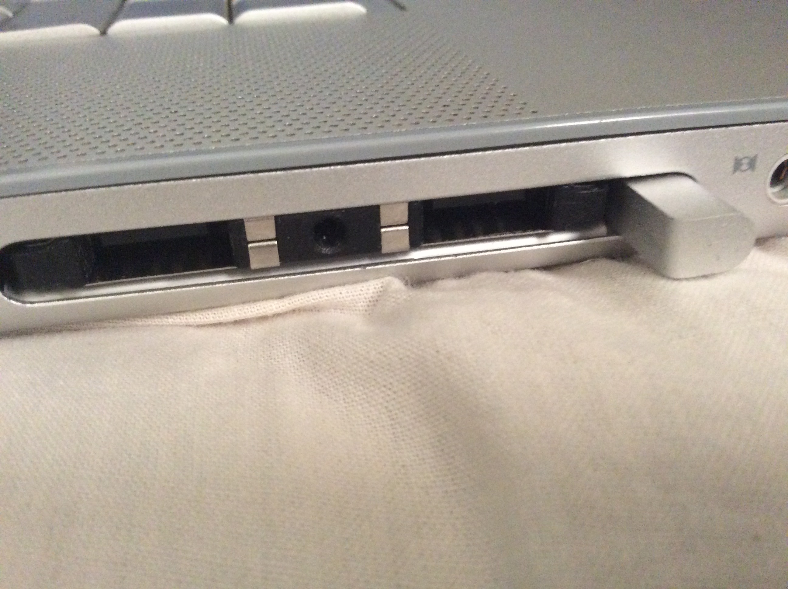

So, today, I received my NEC AKE BC168 USB 2.0 card, put it in and this happened... Can't yank it out because the ejector stays out. Computer doesn't detect it either. Tried pulling it out with tweezers but I didn't try tooo hard..

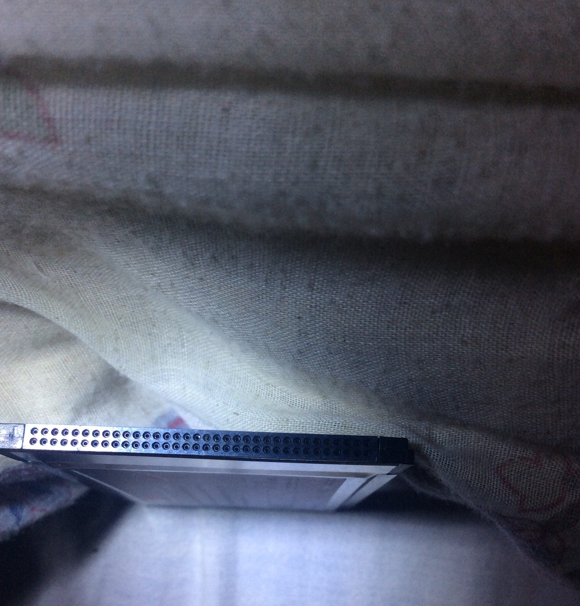

Hmm, pins look ok and all point up in the same direction. I took the card out by putting a pair of small tweezers to an end and pushing up and it slowly came out. Not by literally brute forcing it out. Put it in again and I'll hope for the best :/

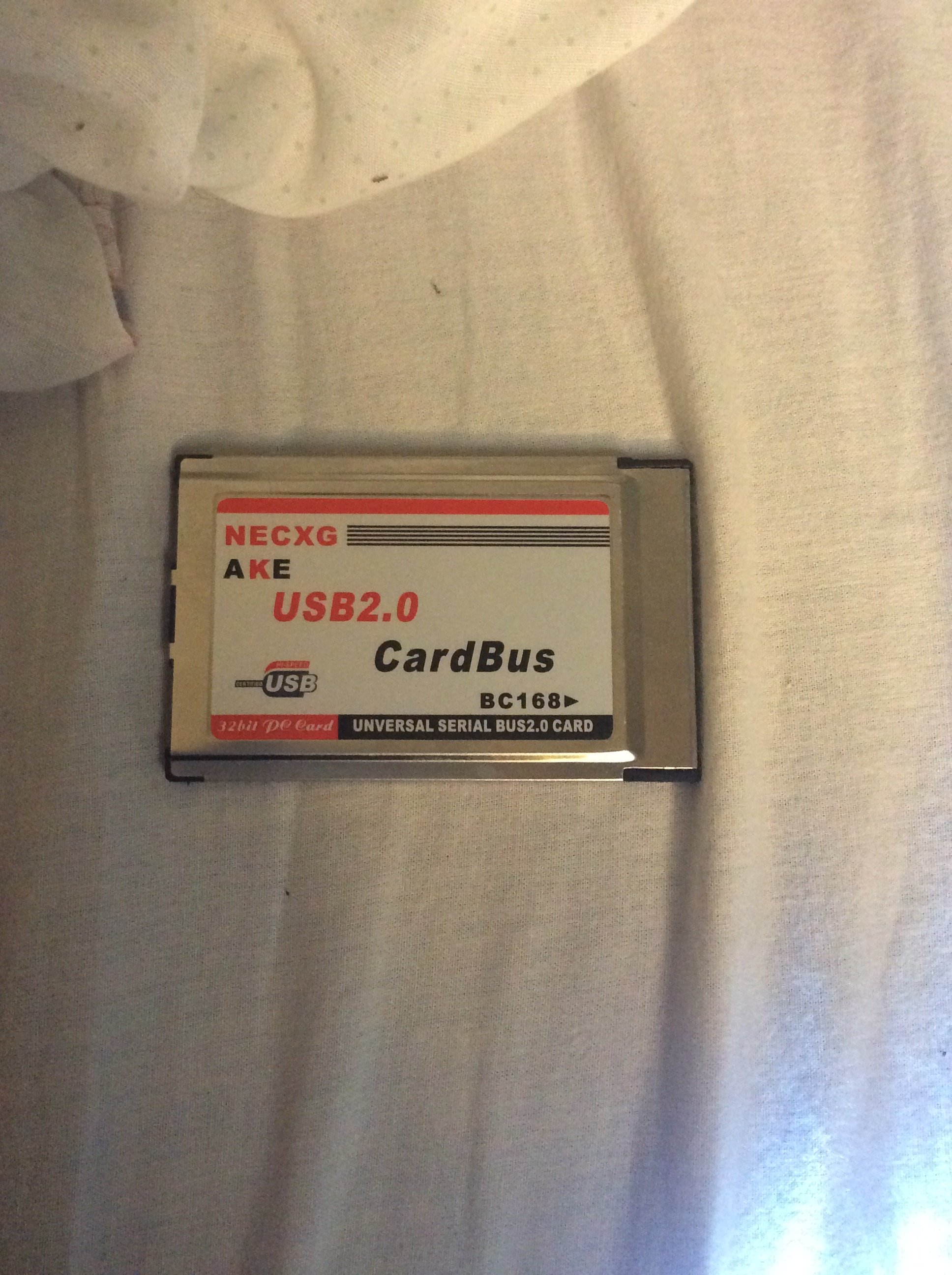

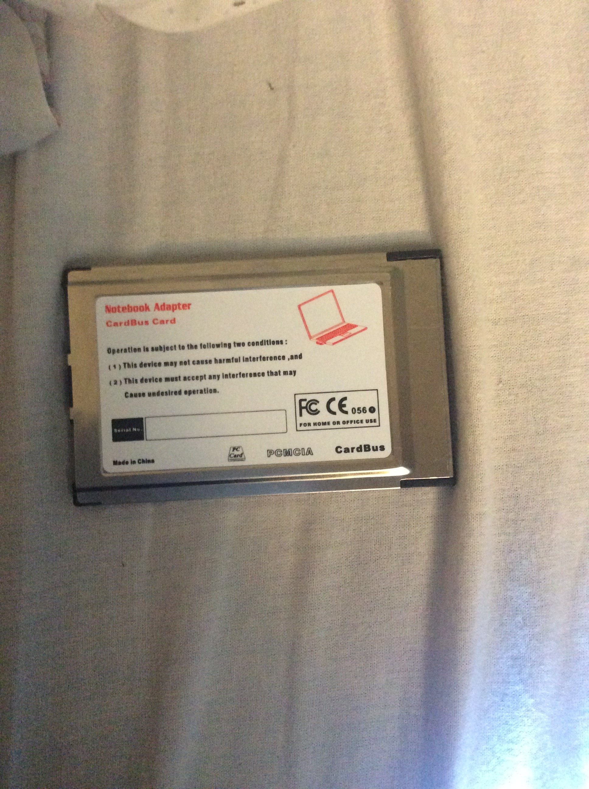

Hmm, who knows.. It looks the right card. (And I can't really do a buyer complaint since I don't have another computer with a PCMCIA card as the oldest laptop I have is a ~3GHz C2D). I have some pics here
That looks right. It should work.
Assuming it is not defective, assuming your PC slot is working as well.
I don't know why it's not.
