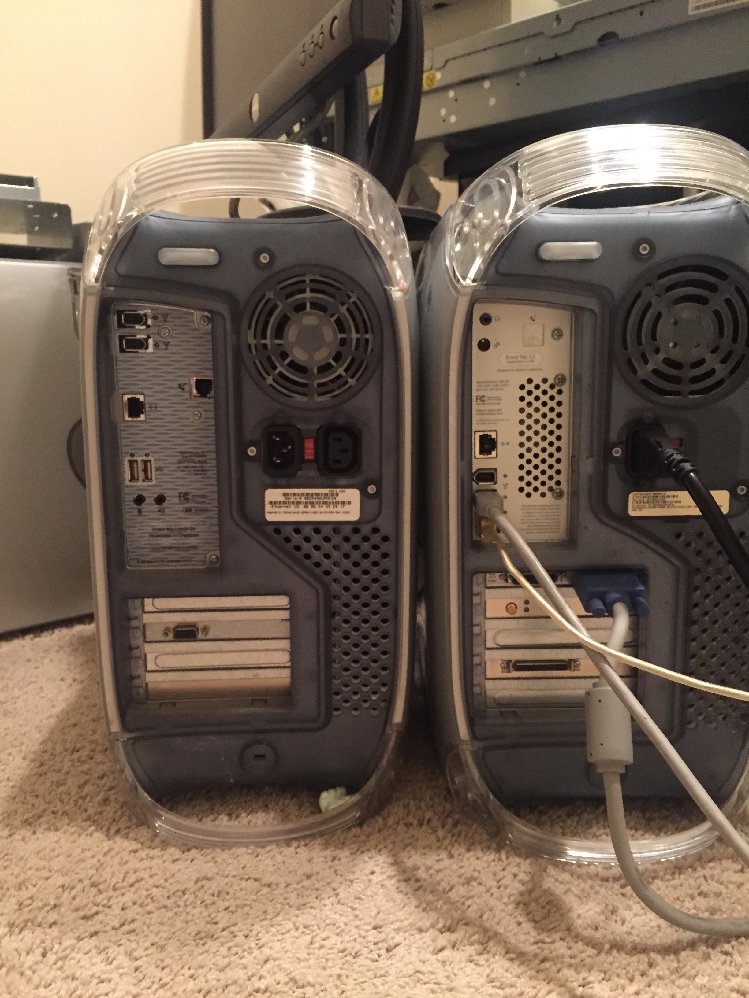

Here's a DA(right) next to a Yikes! G4(left). I didn't feel like dragging out a B&W, and the Yikes! is essentially a B&W with a G4 and without an ADB port. The fan grille on the DA only has a fan behind it on the dual 533(I think that's what the one pictured is) and faster, but even on the 466 and single 533 it's still good for airflow over the heatsink.
