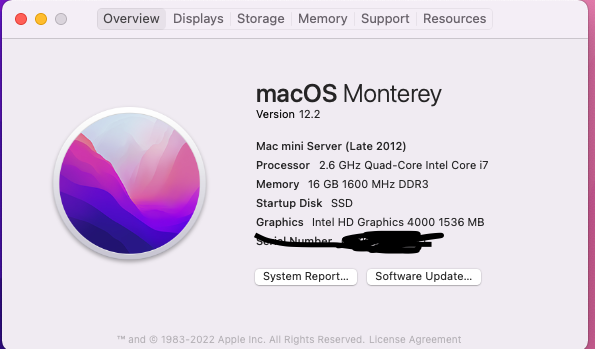

I have the same 2012 Mini and have no problems with the HD4000 being correctly recognised.

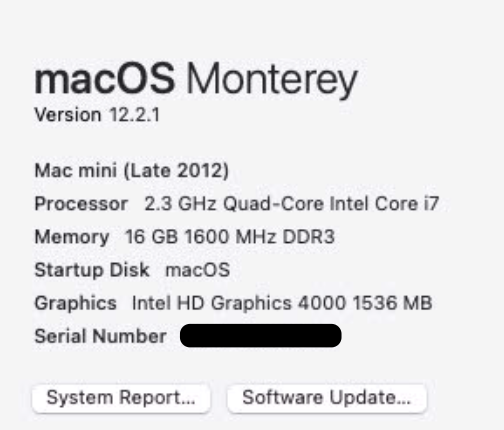

[Edit #2 -- worked this time. I think I made a mistake in selecting a boot disk part way through the process. I think picking "Macintosh HD" probably booted up a failsafe backout? Anyway, letting all the defaults boot worked, though I had to use OCLP again to get graphics acceleration back.]
