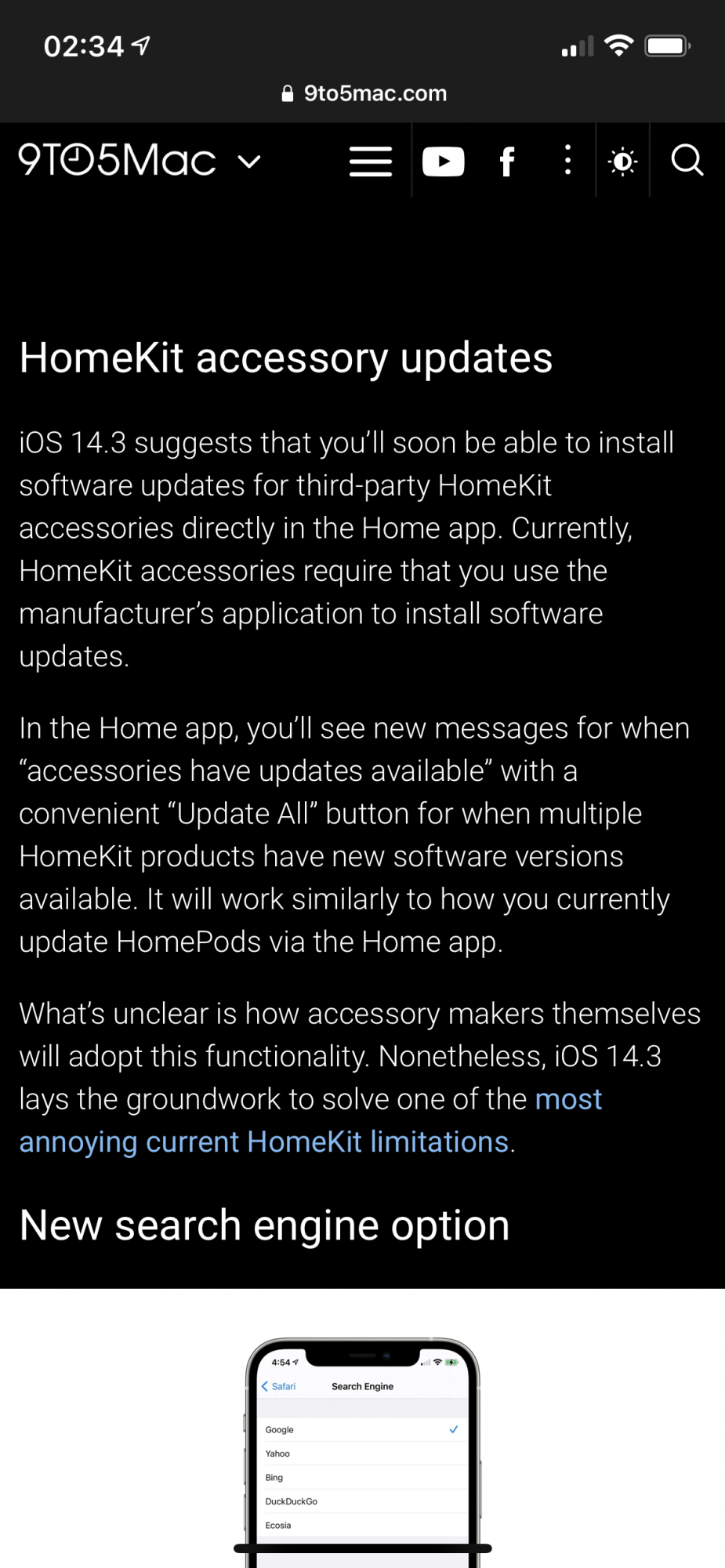

When I add a device via the Home app, I know that I am taking advantage of Apple's security model. But when a device needs a firmware update, I have to use the device makers app, connect the device to an account I have to create with the device maker, and then I can finally update firmware. Doesn't this defeat some of the security aspects of using HomeKit?
The only way around this is to not do firmware updates. A smart home and tech in general is inherently not secure. No matter what’s advertised, how do you really know what of your personal information is being released out there. The only way is with completely dumb devices. Unless you’re hiding Hoffa’s body and the Feds are watching you, I wouldn’t worry about it too much. You can get a HomeKit secure router like eero or Linksys and restrict everything else to the home while you update one device. Apple is not going to push firmware updates for these other companies.
Well well well...
That’s great! From a security perspective that’s how it should have always been. Hopefully it makes the actual 14.3 release cut.
The only thing I’m wondering is if it will truly be a security thing or if it’s only for the convenience factor of getting all updates under one roof. The third party manufacturer is still creating the firmware update and pushing it to HomeKit therefore opening up the line of internet communication. I’m not an internet network encryption engineer by any means but I’m trying to think using some logic. Even with HomeKit secure routers, you have to open up the communication with the third party for updates. Just thinking out loud.
... The third party manufacturer is still creating the firmware update and pushing it to HomeKit therefore opening up the line of internet communication. ..
I would be surprised if that is how it worked. I would assume it would funnel through Apple and they would validate the authenticity similar to what they do with apps.

Still a lot of questions but I guess time will tell... according to the article, it seems the third party will have to support this as well and they’re usually slow at adopting new HomeKit features. It’s definitely a start though...
