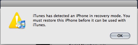

    I have done this several times and continue to either get error 2005 or 6.
    Itunes pulls up and says there is an iphone in recovery mode. It's not restoring the software that the pwnage tool made nor the true file from apple

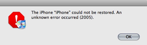

    I already tried this several times, but have tried it once more.
    I get this error message and then the phone has an apple logo and sits until I do something to it.

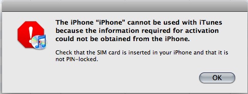

    i plugged it into another machine and it appears to be restoring the device. If it's restored I'll try again.
    It says no sim card installed and that a valid sim will be need to activate iphone. i wonder if i will be able to do it with the phone like this?

    I have now restored by using another machine, and am going to rerun the pwnage tool and see whattado

    I restored to apple firmware, and then ran the pwnage tool again to get a new custom restore file. I ran the alt-restore and selected the "iPhone1,1_2.0_5A347_Custom_Restore.ipsw" file and got the same 2005 error.
    The pwnage tool said everything was fine entered DFU mode, etc.
    Does anyone know what I am doing wrong? Am I supposed to remove the sim card at some point??
