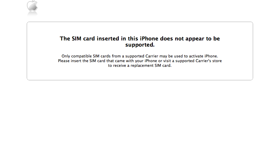

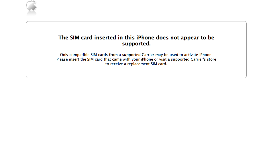

Guys i used pwnge tool 2.2 and now when i reconnect to itunes it says, any help?
Did you make sure to use expert mode and untick the activate switch?

Actually untick the activate is the reason why I got that screen, i just went expert and increased the size to 1000 left it ticked and it worked without a hitch, now im running 2.2 on TMobile 3G
