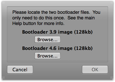

I have gotten through most of this process but it says I need to locate the bootloader files. Sorry, I am kinda a newb here. Can anyone help me out?
If IPSW Builder asks you for the bootloader images.

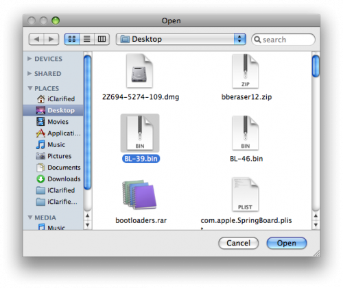

Download bootloaders.rar from the link onto your Desktop. Double click this to extract its contents.
Click the browse button for the bootloader 3.9 image and select BL-39.bin file from your Desktop.

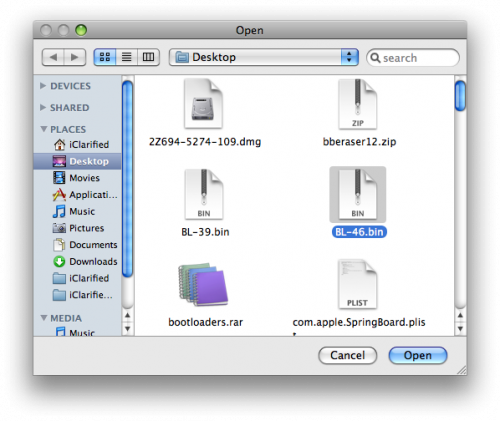

Click the browse button for the bootloader 4.6 image and select BL-46.bin file from your Desktop.

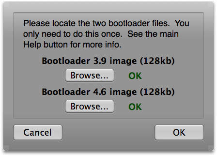

Click OK button!
