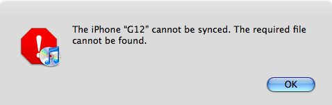

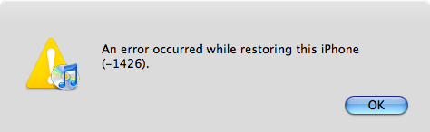

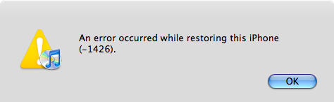

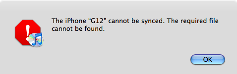

Umm...ok i think my phone might be hosed. I did everything by the book and restored the firmware. It restored and then launched the BootNeuter and got "Flashing Baseband. This may take up to 2 minutes" and its been stuck there for the past 13 minutes.
I dont want to touch it just because it maybe taking longer than usual but i dont think it should take this long. What do i do?
Make that 15 mins
PS my phone was a 4GB iPhone running a Pwned 1.1.4 FW
PS i also get these from iTunes
PS My phone is also getting hot

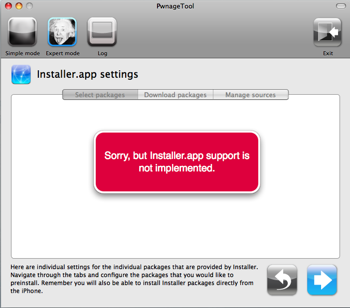

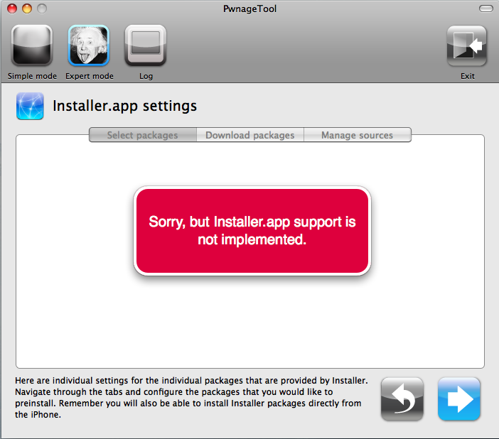

Well, I will hold off until there's a way to install app support. Without it it's kinda useless.
According to the Pwnage tool, Installer is not implemented and some say it won't be because Nullriver is on the App store.
