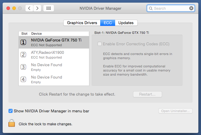

I'm running 10.10.5 (14F1605), and 346.02.03f05 When I boot with the X1900, and use the PCIE tool to force the slot to 8x, it is recognized, but when it's by itself, I can't get it working.
