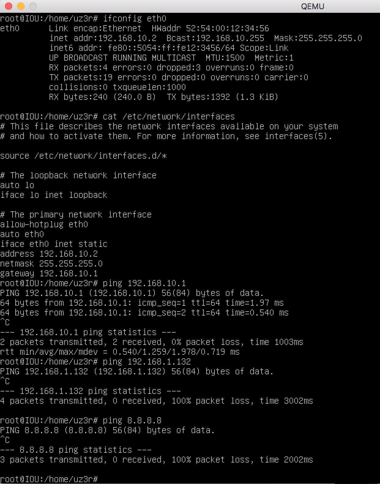

uz3r@IOU:~$ uname -a
Linux IOU 3.16.0-4-686-pae #1 SMP Debian 3.16.7-ckt25-2 (2016-04-08) i686 GNU/Linux
uz3r@IOU:~$ This is my VM accessed via SSH
The tap0 interface (which is created once your VM boots) is hence the gateway between OS X and the VM so I assigned
192.168.10.1 and assigned the VM 192.168.10.2 with a default gateway pointing to 192.68.10.1
In this screenshot I try to ping to Google DNS and the IP adres of my MBp WiFi addres but the VM can only reach the tap0
interface which is it's gateway
If you need any further help, just let me know
