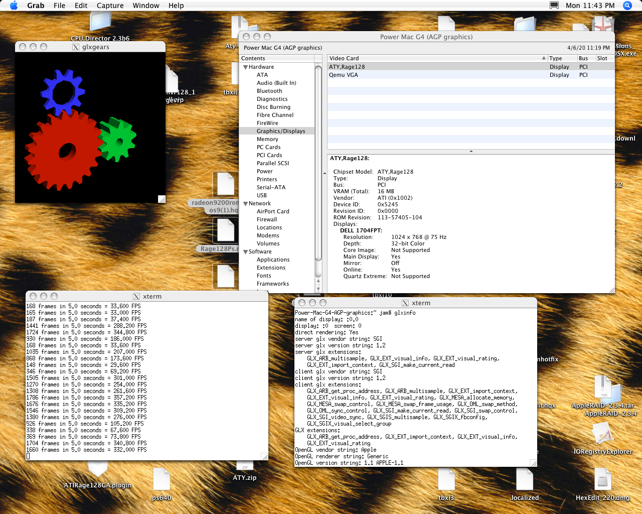

I've had some success with VGA passthough of an ATI Mac Edition Rage 128GL PCI card.

I saw some posts about it on the emaculation forum,
nice to see its working, although going by the OpenGL render string I see thats still an issue?
did the OpenBIOS issues ever get resolved to let NVIDIA fcode roms work?

@DearthnVader can you share some more details? Build, config, etc?
Does this mean you have that specific Rage 128 PCI Card installed on the host or is this card being emulated in the guest with OpenGL passthrough from the host’s modern GPU?
It's a a Ryzen 7 1700 host running Debian, with a PCI-E to PCI bridge hosting a Rage 128 GL PCI card being used for PCI Passthough.

We still need to implement some words to Openbios for nVidia FCode ROM's, and I don't think the patch Zotan commited for the Rage128's words are upstream in Openbios, yet.
I'd have to look to see if later ATI cards use words that are not implemented in Openbios, but I did try a ATI Radeon 9200 PCI awhile back, in my old PCI-E to PCI bridge, and my host system would not power on with that card installed in the bridge. The card was keyed PCI universal, but maybe it was 3.3v only, and all my bridges are 5v PCI.

Awesome 🙂 Have you tried the hack to enable Quartz Extreme on PCI graphics cards (disclaimer: I'm not sure if it even works with 10.4.11)
The Rage128 GPU does not support non-power of 2, so no QE, requires Radeon graphics, or GeForce2+.

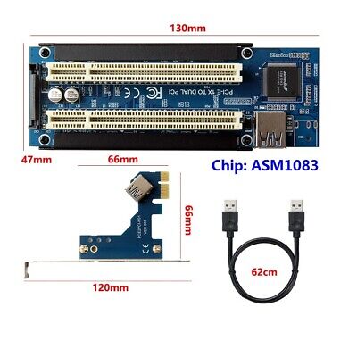

So you have bridged VGA+USB+FW ?
Really interesting. I have a bunch of old PCI Audio Cards only meant for Win 9x and Panther, and a bunch of old graphics cards as most of us. And modern boards, so this is mindblowing.
Can you point us the bridges you have used?
This little setup works well, not my listing.
Reactions: G4fanboy
ah forgot about those!
given its on the end of a flying USB lead, might actually be able to use that with my Xserve3,1...
will have to look at getting one at some point 🙂 (would still have to supply it with power somehow)
I assume when you pass devices through, your "just" passing the actual PCIe to PCI bridge through so everything on the PCI end shows up in QEMU/the guest OS inc the bridge itself?
as a side note, Id love to get the reverse, ie
a PCI to PCIe 1x adapter or such, I know they exist from startech etc, but are still somewhat pricey sadly https://www.startech.com/uk/Cards-Adapters/Slot-Extension/PCI-to-PCI-Express-Adapter-Card~PCI1PEX1 (they also used to do a PCI-X to PCIe 4x one but I dont see it anymore)
it would be really interesting to try a GeForce 6600 from a PCIe G5 in say a G3 BW (im pretty sure the GeForce 6200 ROM is based off the 6600 ROM and i know that works in a G3 BW!)
or an ATI Radeon X1900 Mac edition in a G3 beige or 9600 (really see if they kept that old world ROM Open Firmware compatibility LOL)
I do see they are cheaper on amazon...
Not my listing.
With QEMU on mind with modern machines with this adapther+yours a Full AGP or PCIexpress (CoreImage) stuff + PCI stuff could be achieved.

I was able to get basic VGA to function with OS 9, however graphics acceleration ends in systems lockup.
Also, no joy with passthrough of a USB PCI card to OS 9, the card is detected, but it just doesn't work, not sure the reasons.
Also, my Rage128 PCI card is the Rage Orion PCI retail card, and requires the ATI ROM Xtender as the Mac OS has not 'NDRV' for the card.
OS X will kernel panic without the ROM Xtender, as it doesn't care for the 'NDRV' from the FCode ROM.
OS 9 also doesn't work with the FCode 'NDRV', must be something about PCI Passthrough that breaks the ROM based 'NDRV'
