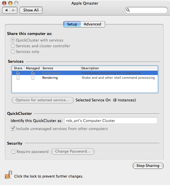

Here a screenshot from Rob.
Is the problem with the QuickCluster or somewhere else?
Tracer
