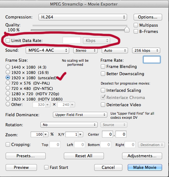

Heres a test.. do you have mpeg streamclip?
http://www.squared5.com/
Its faster then FCP..
throw a file in at and choose H264 as the codec.. but dont constrain the bit rate.. leave it on auto
let it rip.. compare that file to the original media.. should look pretty darn good.. But if the file size is too large.. then throttle the data rate down.
You can also export right out of FCP this way, just dont set a data rate.
This is to give you a bench mark as to how they look, and how large the files are.
