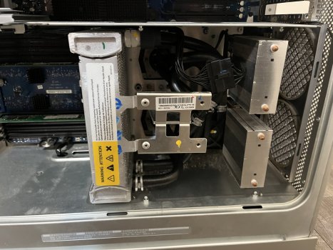

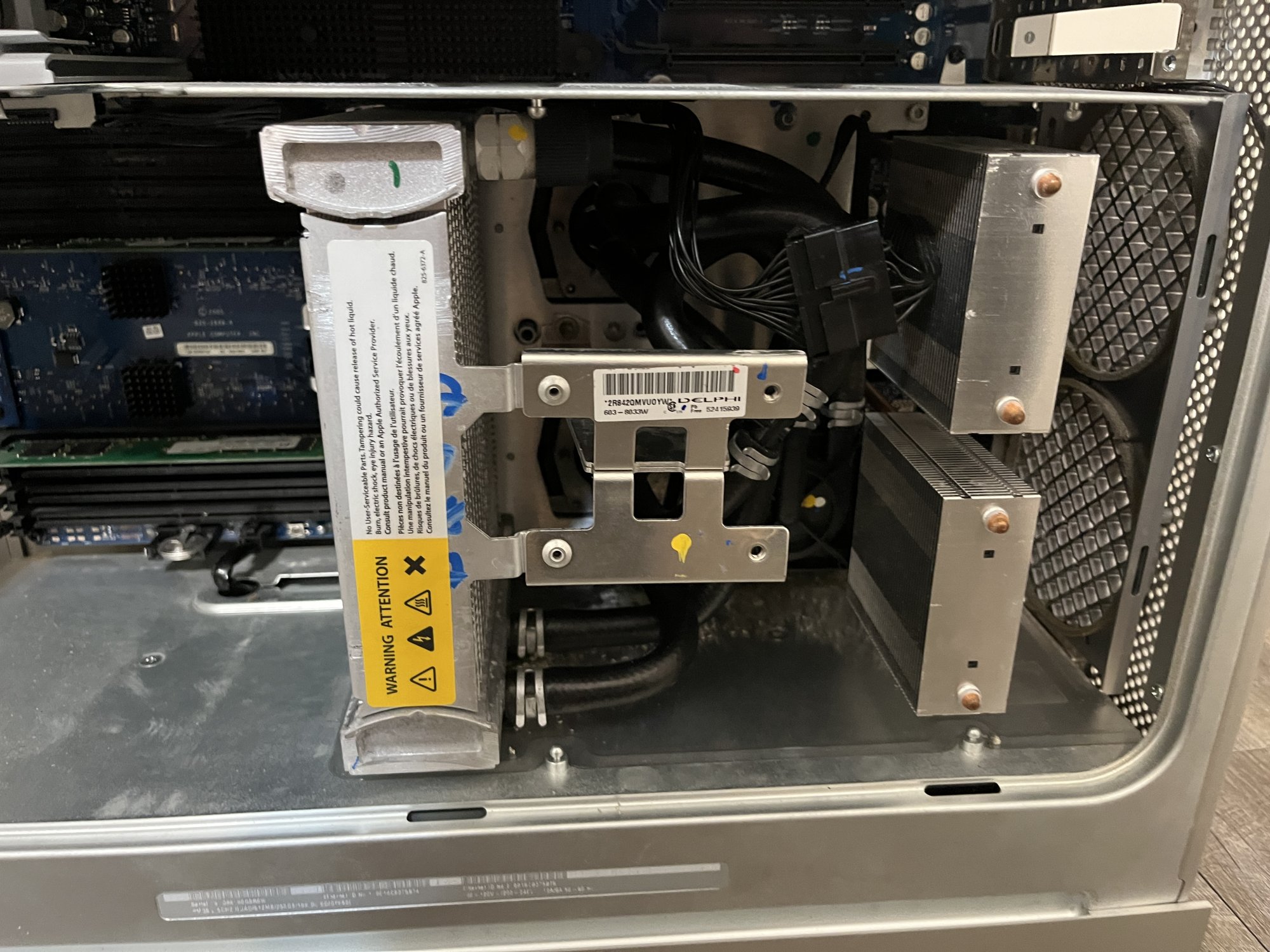

I have a G5 quad that posts, chimes and starts booting. However, the CPU temperature increases to roughly 80 degrees, the fans spin at maximum RPM and the system promptly shuts down. I cannot complete a thermal calibration with ASD. As a result, I’m certain the issue is hardware related.
There does not appear to be any leaks or corrosion from the liquid cooling system. Despite not being super familiar with the G5’s internals, I’m aware this is a common issue.
There there are 2 red LEDs (over temp and check stop) when the system is powered on. I have tried different RAM modules, so I do not believe they are an issue.
As seen in the photos, the anti static pad had completely disintegrated, so I scraped away it off and some adhesive along with it.
What is the best course of action for this machine to maximize its lifespan? Would it be better to repair it with its current hardware or replace the cooler with something else? I want to make sure I know what I am doing before tearing any further into it.

The liquid cooling system likely needs to be flushed clean and refilled. There are guides on this site on how to do that. The thermal paste on both the processors and the u3 chip on back of the board will need to be replaced no matter what. To do this you need to disassemble basically the entire system. Be careful with the processor support bar, make sure it does not get caught on anything and fall on the board....
