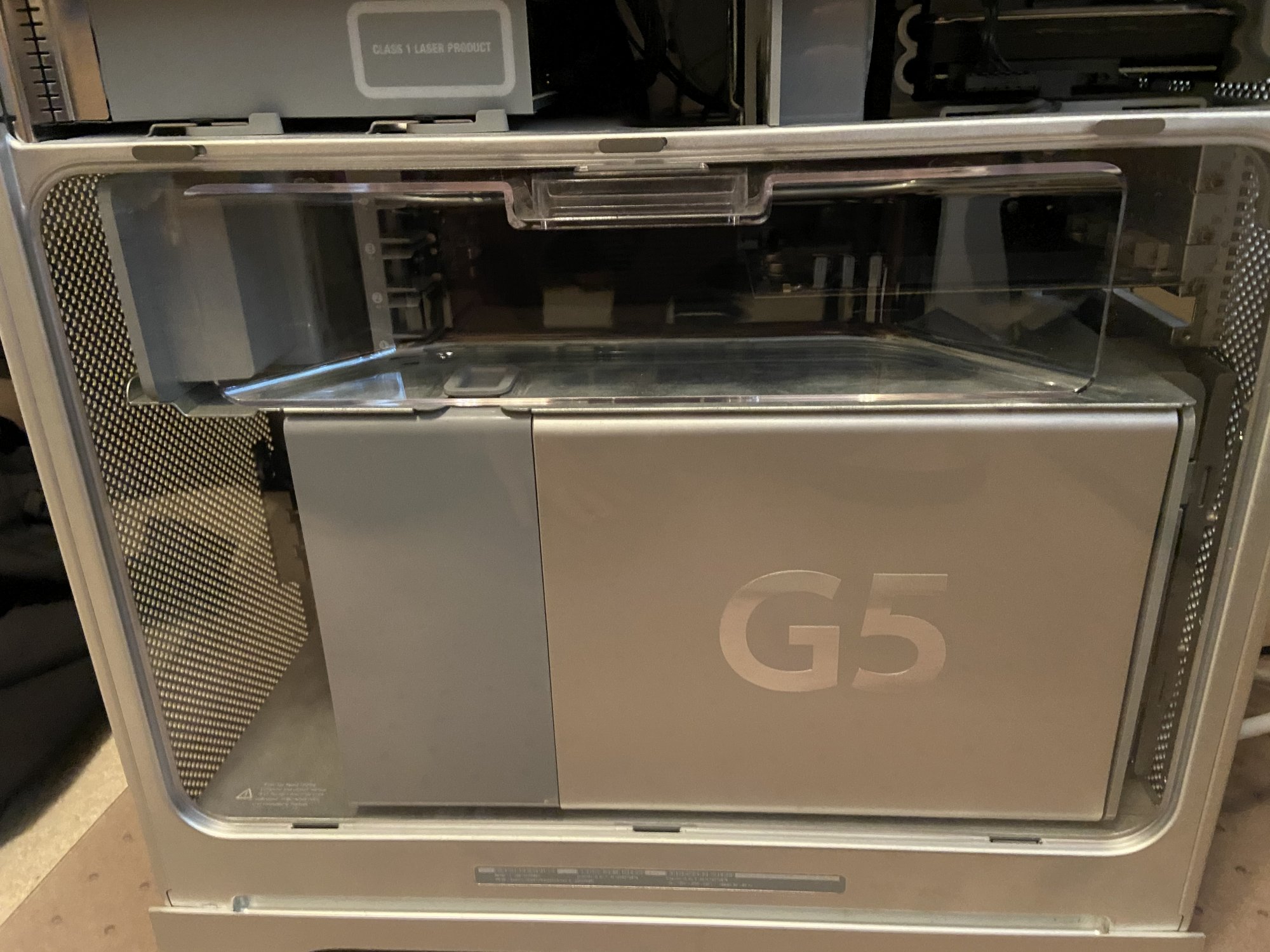

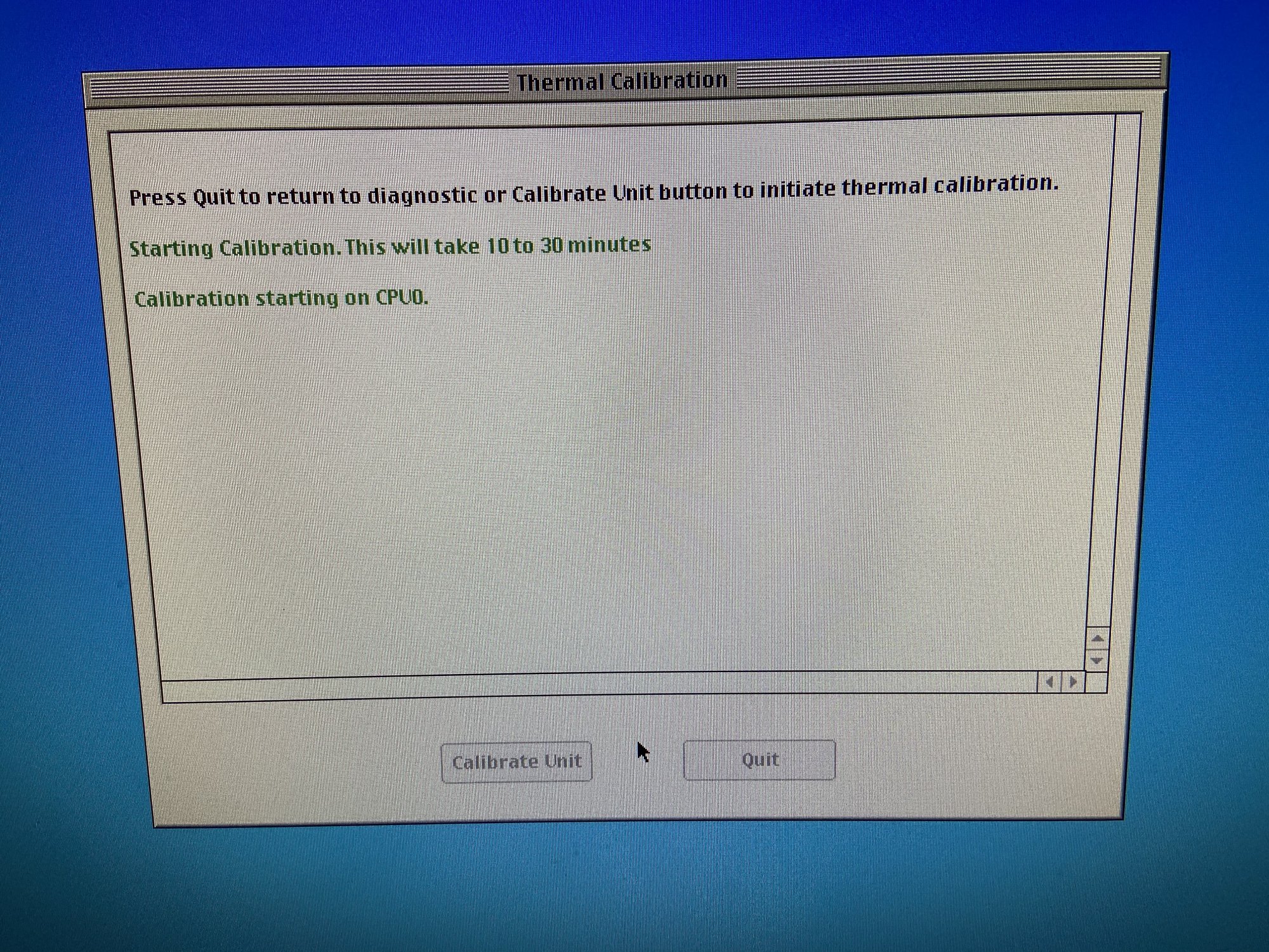

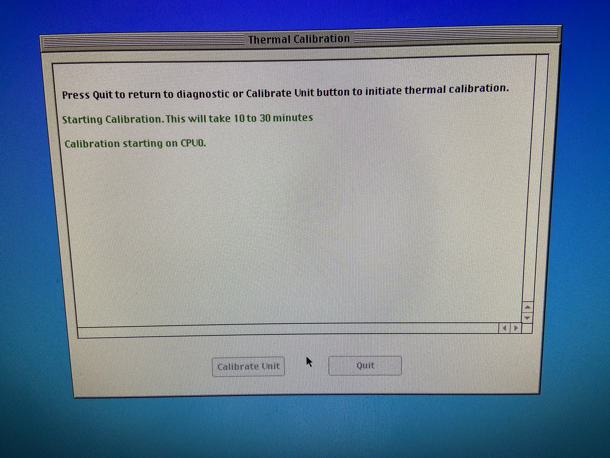

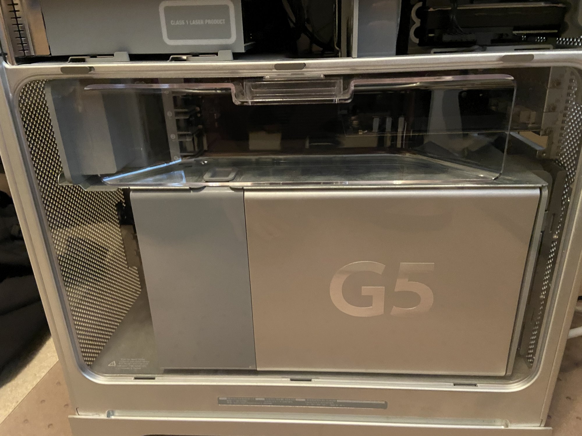

I didn’t see the other part of your response initially. Yes, the plastic air deflector is not n place. I tried running calibration, but after several hours it’s still stuck here.

That is easy to explain...
Calibration or not, the fans will run full speed if the air deflector is not installed, or not seated in place properly.
And, the calibration procedure will not finish unless that air deflector is installed.
(I'm guessing that you have not worked on a PowerMac G5 before. 😎 )

Is that installed properly or not? No I haven’t worked on a G5 before, hence the reason I made this thread asking for help...

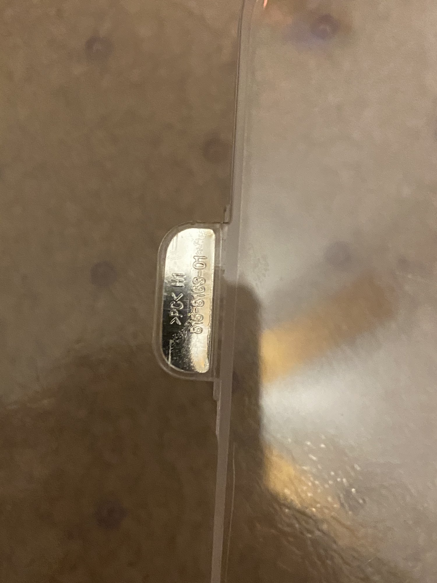

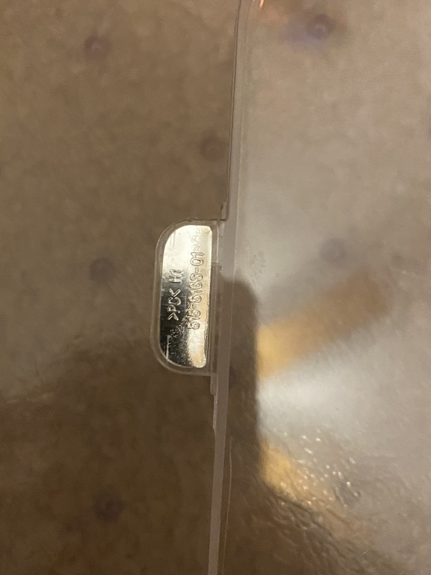

If the fans STILL are up, even with the deflector in place, check the bottom (right, I think) tab on that deflector, where it goes into the chassis. It MUST have an opaque covering on that tab, as it has to block a light sensor underneath the chassis, where the tab is located. It's usually a length of silver/aluminum tape.

Yes, that is correct. Now give thermal calibration a re-try.
That is the way it was installed when I performed the calibration. I didn’t touch it, I just took the side panel off to take a picture. Is there any other reason why the calibration could be failing?
It is on there, if this is what you’re referring to.
It is on there, if this is what you’re referring to.View attachment 974325

The thermal calibration fails with the system freezing while calibrating because the cooling system is failing . It will either say that the calibration failed or it will freeze . I've seen this happen .
Yep, my Quad has a failing LCS and the thermal calibration also gets stuck at the same point.
