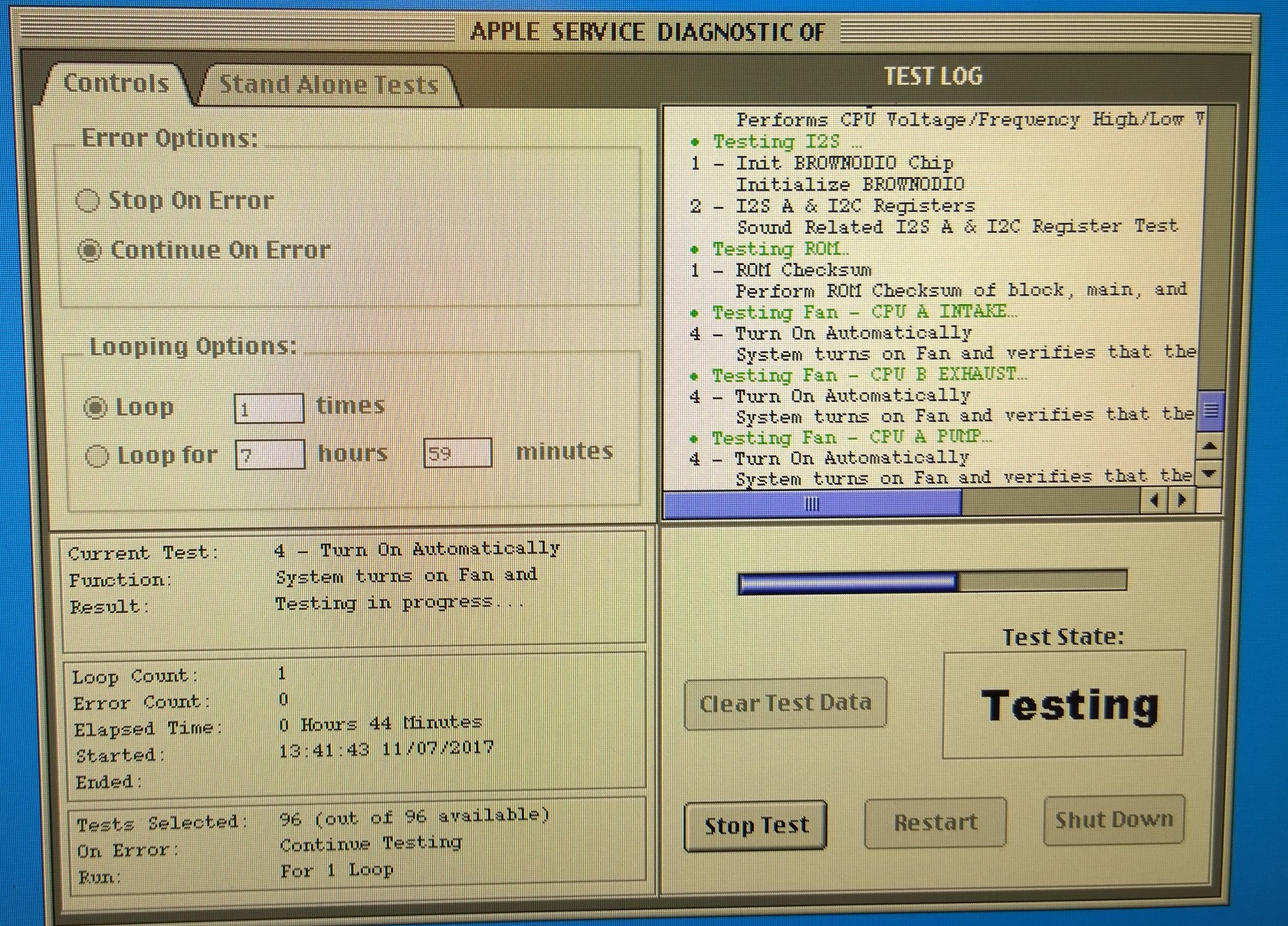

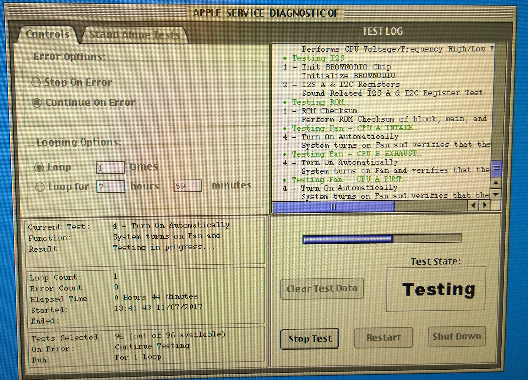

I tried running ASD 2.6.3 to calibrate it, but it ran for 4 hours not changing from "starting calibration of CPU 0" and appearing to be frozen (mouse not moving etc) before I had to turn it off (ASD says calibration should take 10 to 30 minutes). The Overtemp and Checkstop (I think) red lights inside come on pretty much as soon as the calibration is started, not sure if that is normal or not?

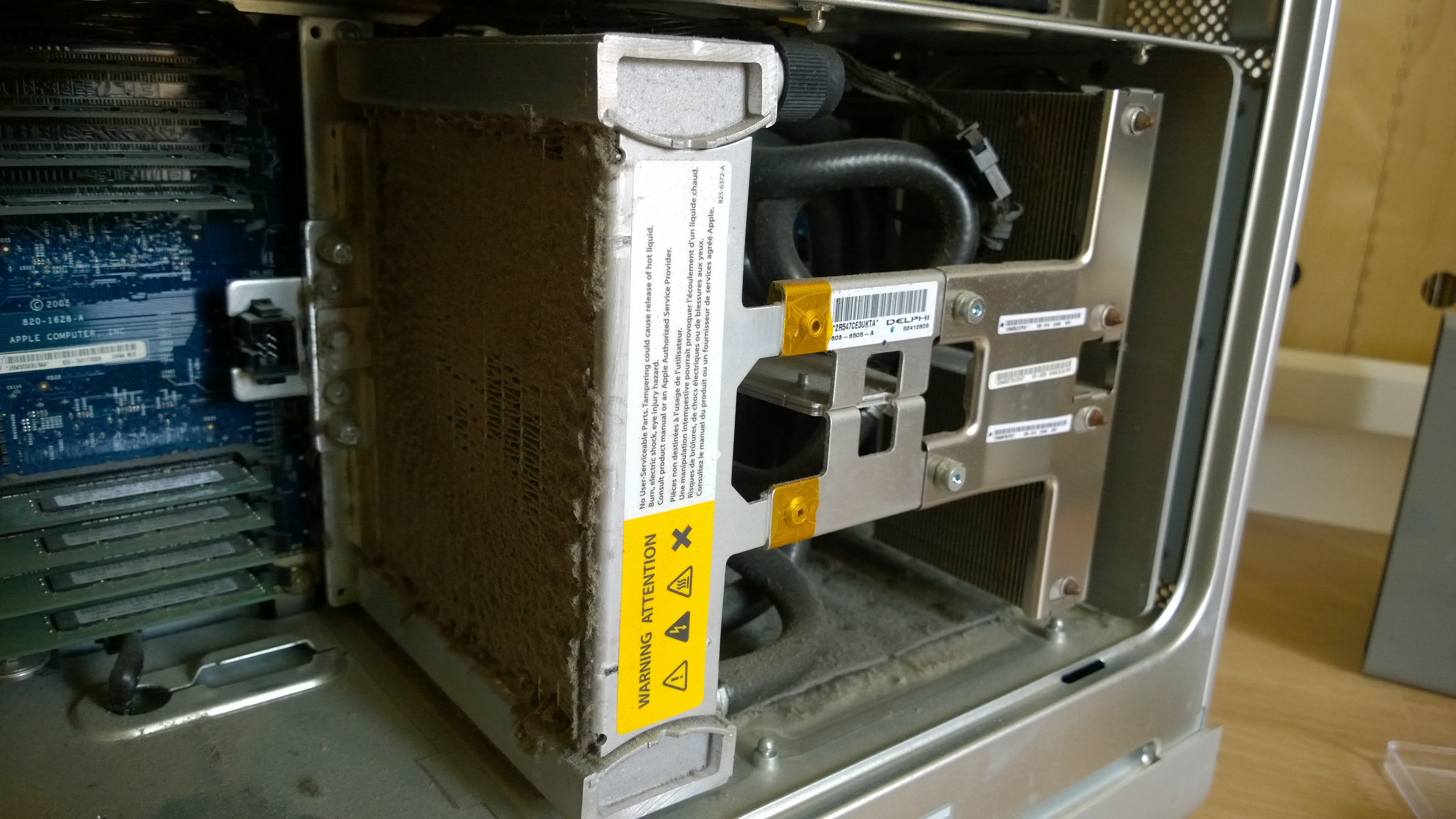

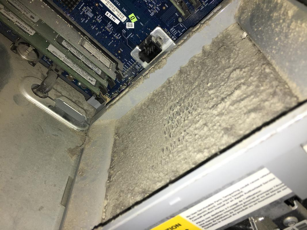

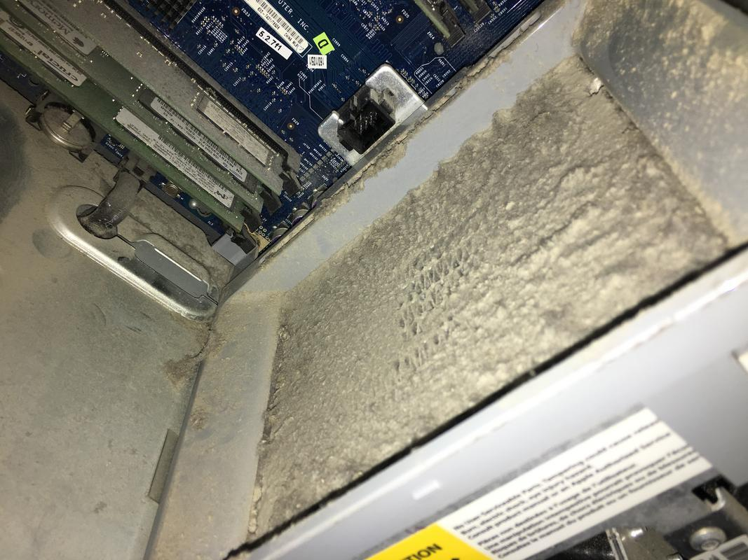

in-regards to thermal calibration, make sure to clean all the dust out the G5 Quads LCS Radiator. My G5 was absolutely filthy/dusty inside and ran quite hot and loud and failed Apple thermal calibration, it did not lock up but it did report CPU 0 and 1 over-temp
after I evicted the (dust) carpet from the inside of the machine, I re ran Apple thermal calibration and it passed 🙂, I noticed on mine the Backside U4/memory controller Fan will still ramp to 3000RPM fairly quickly, but id not be surprised if theres a carpet of dust behind the logic board there, ill have to evict that one when I pull the logic-board out. and see how it runs then, but otherwise the Quad Runs fairly quiet for a G5 now 🙂

checked mine over its fine 🙂 single pump unit to boot too with no signs of leakage, after cleaning it out and running thermal cal both my temps and fan speed are good 🙂 I have seen G5 Quads where the CPUs them selfs go bad and start reporting CPU over temp etc, I believe @Surrat has had experience handling that.
when I say carpet I mean carpet Mmm yummy LOL

Yeah! I had to break out the Vacuum cleaner with a small brush stuck to the end of the hose to clean that one out... that worked surprisingly well at cleaning out the dust blanket and the dust between the fins...
its sad how people neglect their machines like this...

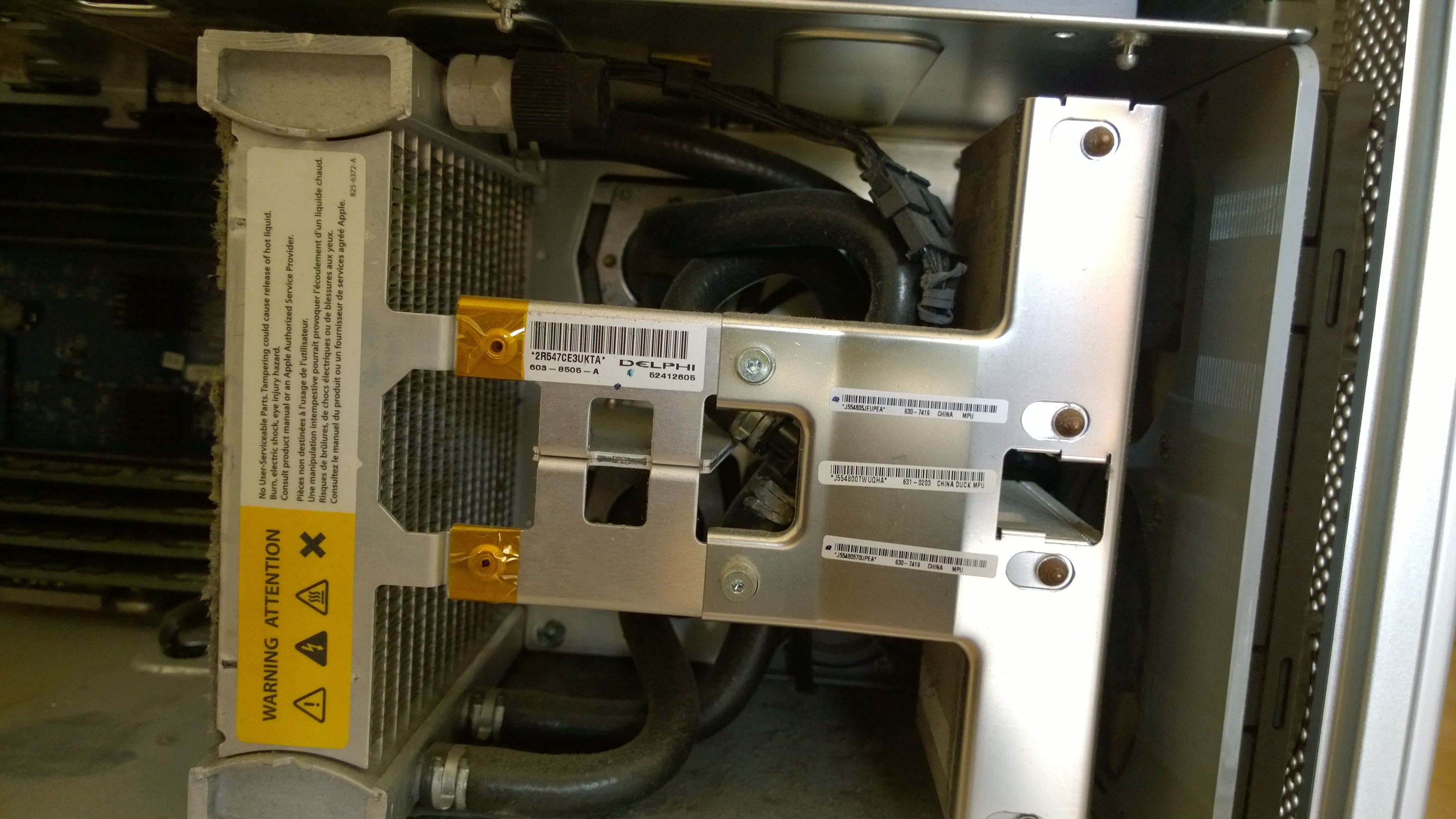

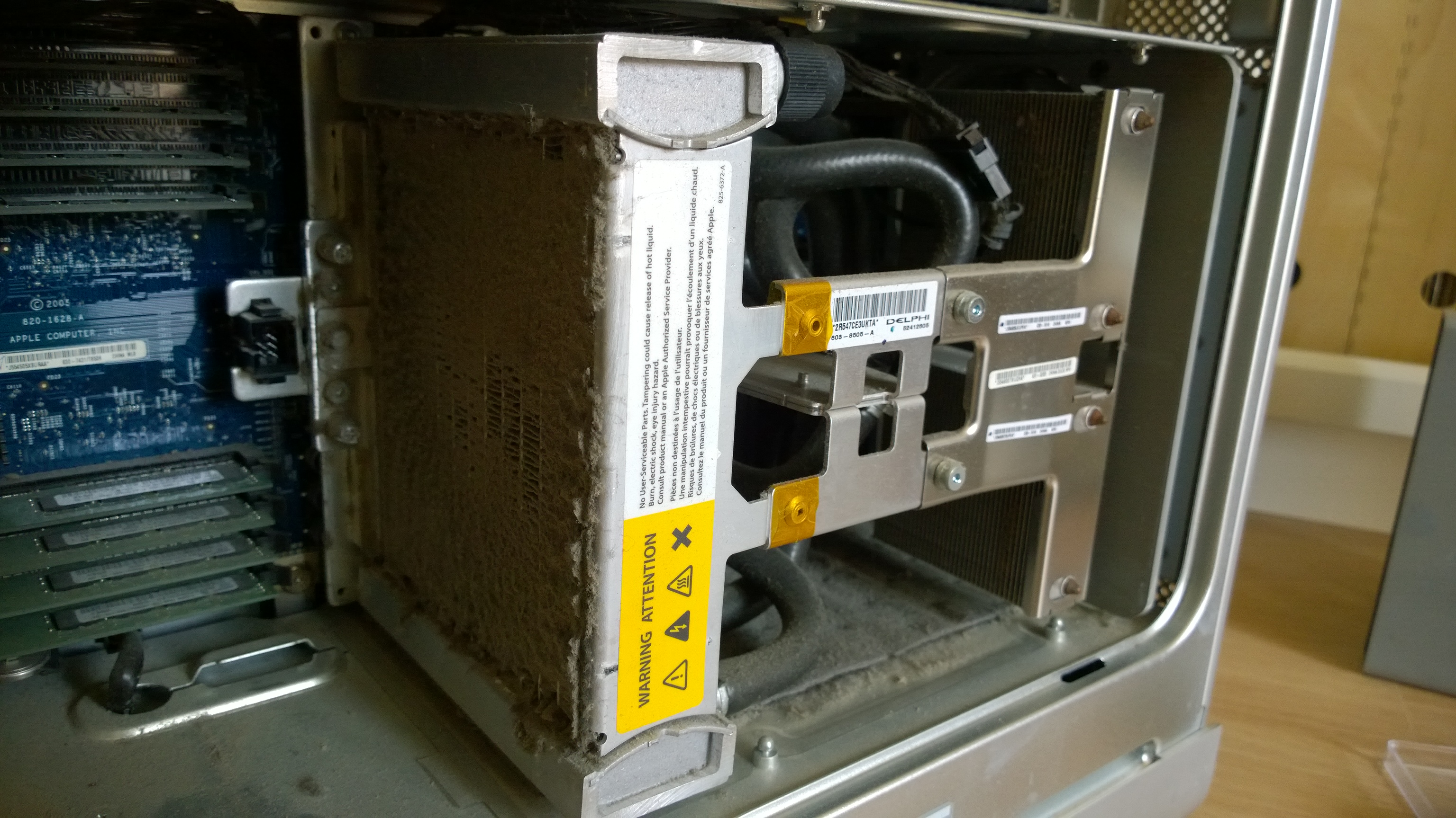

BTW heres a picture of the LCS it self (im pretty sure this is the single pump unit)
Yep, you’ve been blessed with the single pump version!
If you’re handy, the processor unit is fairly easy to remove (with the correct long handle screw driver) if you follow the service manual to the letter. It might allow you better access to really scrub that out. Just be careful when reinstalling to make sure the processor cards are perfectly lined up. They’re flexible. Be sure to apply even firm pressure up or down when removing or inserting. Never side to side...
If you’re feeling adventurous, a couple of screws will allow you to remove the processor cards on the bottom of the LCS and instal new thermal paste. If you suspect one of the processor cards faulty (freezes on calibration, etc) you can remove it and test if the machine works without issue. If CPU B is ever suspect, you can software disable it in OSX if you don’t feel like getting this deep.
Not sure you needed any of that info, but as I said, I’ve been down this road. Might help OP?

Does the mouse cursor normally move throughout the calibration process or is it normal that it freezes? I have never used ASD before...

you are Using ASD 2.6.3 right? the mouse can be moved but its very sluggish during thermal cal like taking 30 seconds to 5 minutes to respond to movement, if it aint responding after like 5 mins then yeah its prolly froze, also make sure to only boot from the OF part of ASD 2.6.3 not the OS part
all I did to get to that dust was remove the big "G5" metal cover and the plastic cowl round the radiator. (the plastic cowl/shroud thing is in place in my photos but it simply pulls out.) then I busted out the vacuum cleaner 🙂

Regarding ASD yes it's 2.6.3 and I am using the part that you get if you hold the "C" key (it looks a bit like the classic Mac OS), I assume that is the right part as the instructions say the other part won't boot at all on the Quad.

in ASD both sides look like platinum Mac OS 8-9 LOL, hold option and select the option that shows a picture of a Mac with an IC over it. but from what I understand the OS part of ASD does not boot at all on the PCIe G5s... so you are probably booting into the correct side.

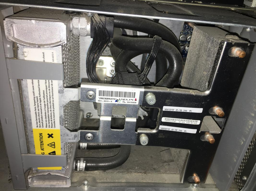

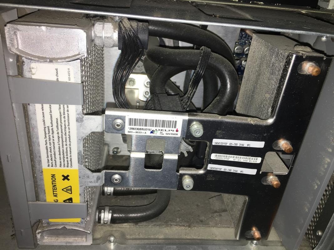

I eventually got the rivet out, here is what was inside:
I cleaned out as much of the dust from the radiator as I could, but the thermal calibrartion still freezes (I checked and am definitely using the OF part of ASD). I ran the hardware tests in ASD and get the same freeze (mouse stops moving and red lights inside for Overtemp and Checkstop come on) when it gets to this point - so I'm guessing there is something not quite right with this G5? 🙁

the fact it freezes still with those LEDs lit does sound like a CPU issue, if you boot into OS X and THRASH the CPUs what temps do you get/does it lock up? I wonder if yours was run for a long time with that carpet in place causing the CPUs to overheat and get damaged or cause the coolant to slowly evaporate.
the good news tho is you have the better single pump LCS 🙂

Thanks - I had it running for a few hours before cleaning it out and noticed the red Overtemp light on after a while, it didn't freeze but was loud. If there's nothing else that can be done with it short of difficult things like messing around with the liquid cooling system then I think I'm going to sell it to someone that wants the parts now.

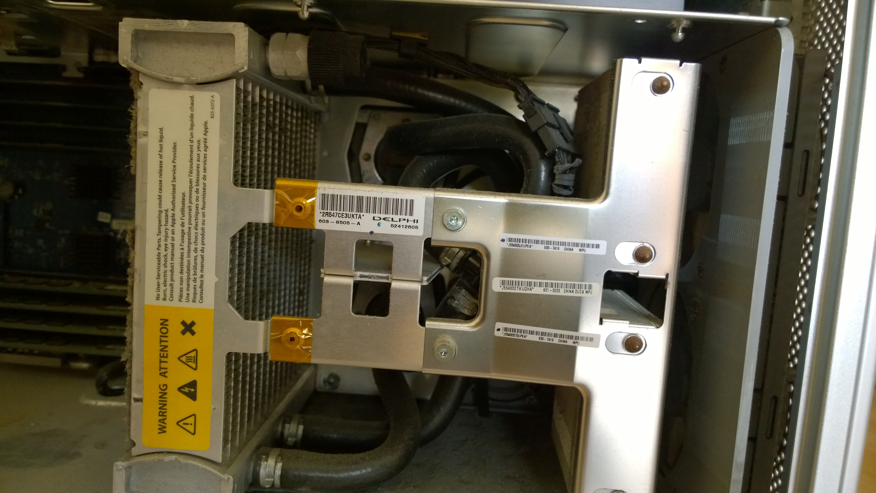

mind sending a picture of the Radiator after you dusted it out? does the OT LED still light? you can try pulling the entire LCS out and repasting the CPUs that should help with temps somewhat. repasting the CPUs does not involve tearing apart the LCS it self just removing it like you would remove any other heatsink.
